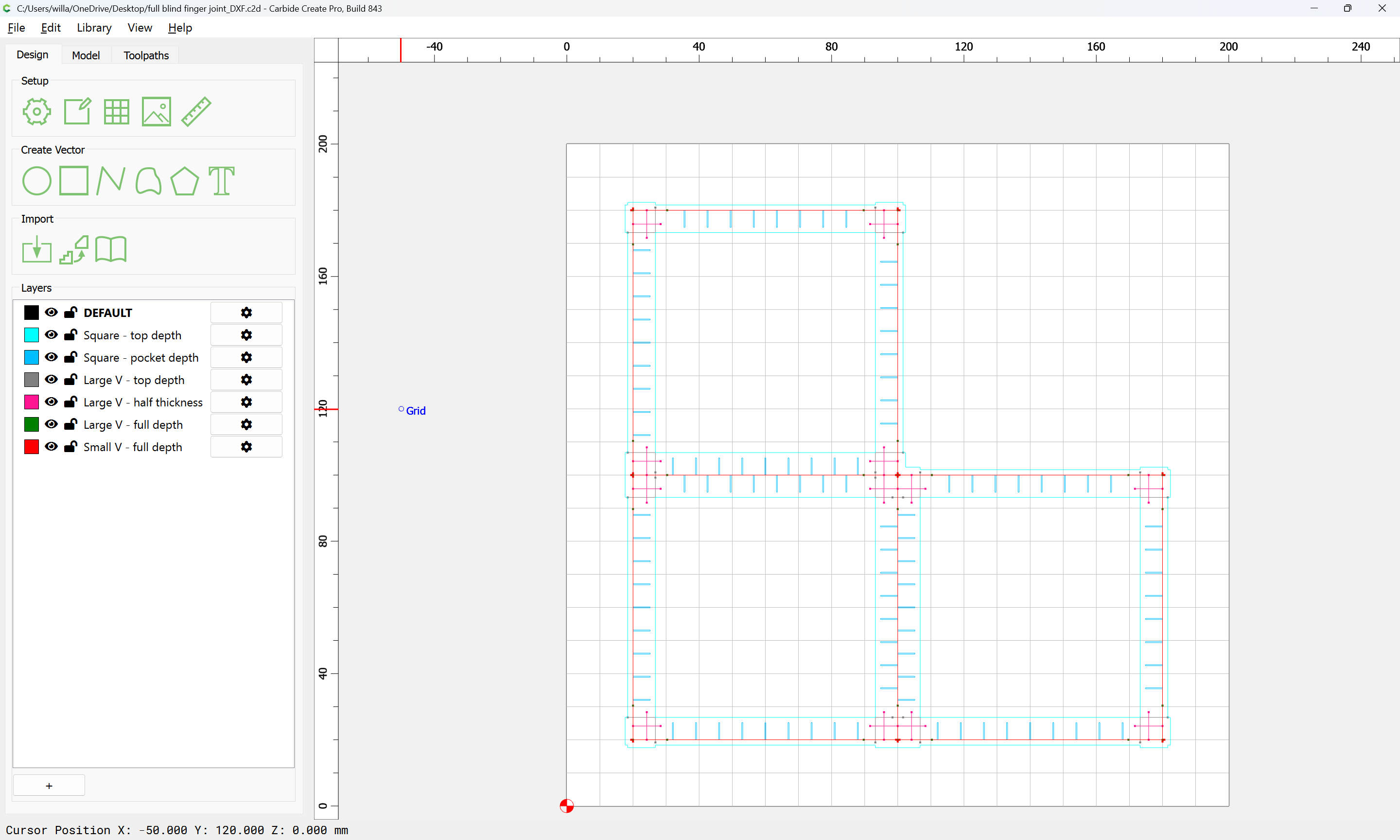

which may then be exported to a DXF w/ layers:
which when imported into Carbide Create:
matches up with toolpaths so that the joinery/parts may be cut:
You’ll just need a large 90 degree V tool, a narrow V tool (I usually use a 1/8" 90 degree Kyocera), and a matching small square tool (a #102 will be fine).

  • Carbide Create has gained a facility for associating a toolpath with the contents of a layer, allowing one to make template .c2d files
  • DXF import in Carbide Create was markedly improved:
Build 839
New
All-new DXF parser that handles less-popular parts of the DXF format better.
including importing the layer associations.
  • in my own project using Open(Python)SCAD, I have worked up a mechanism for describing tool motion and writing out DXF files which may be unclosed:
including colour-coding and assigning to layers.

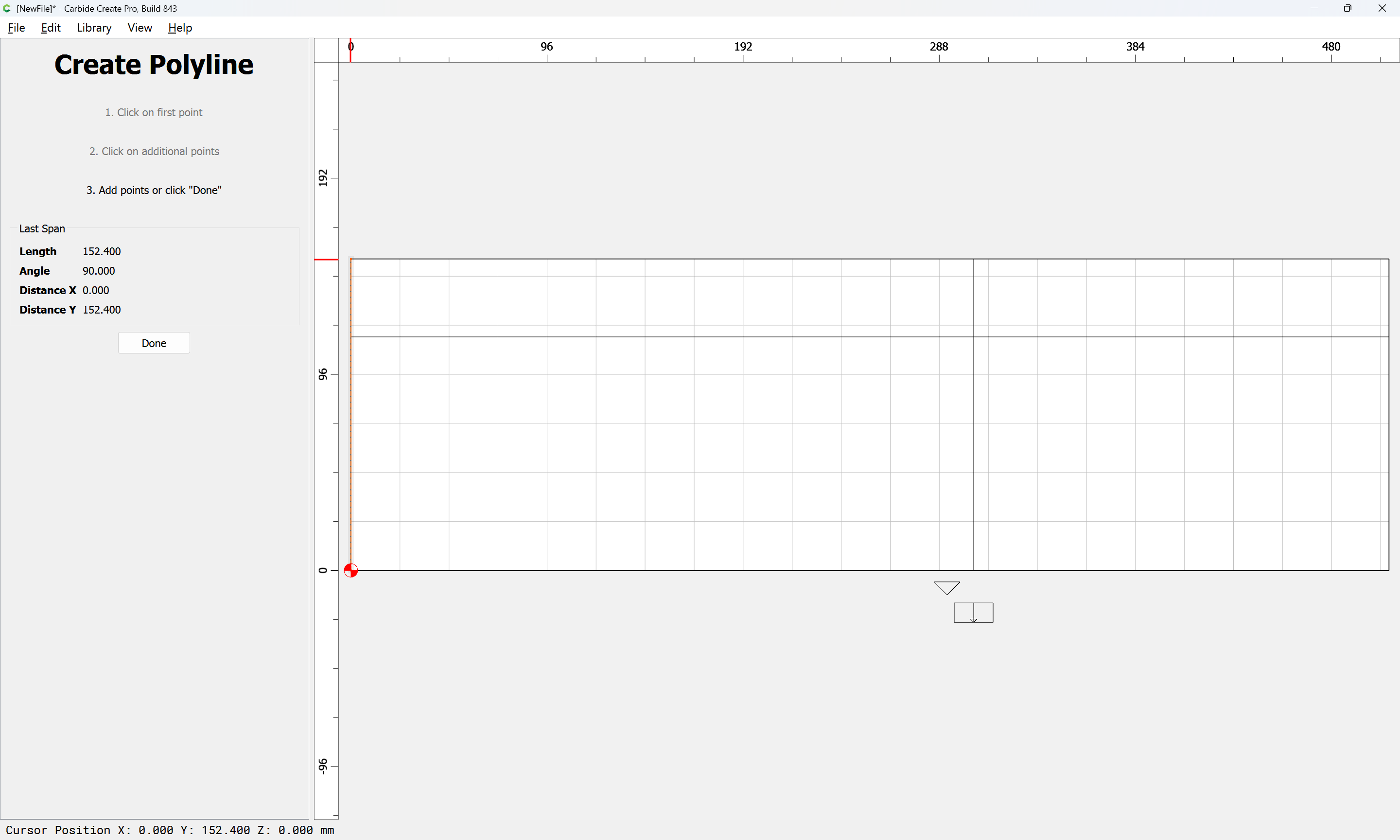

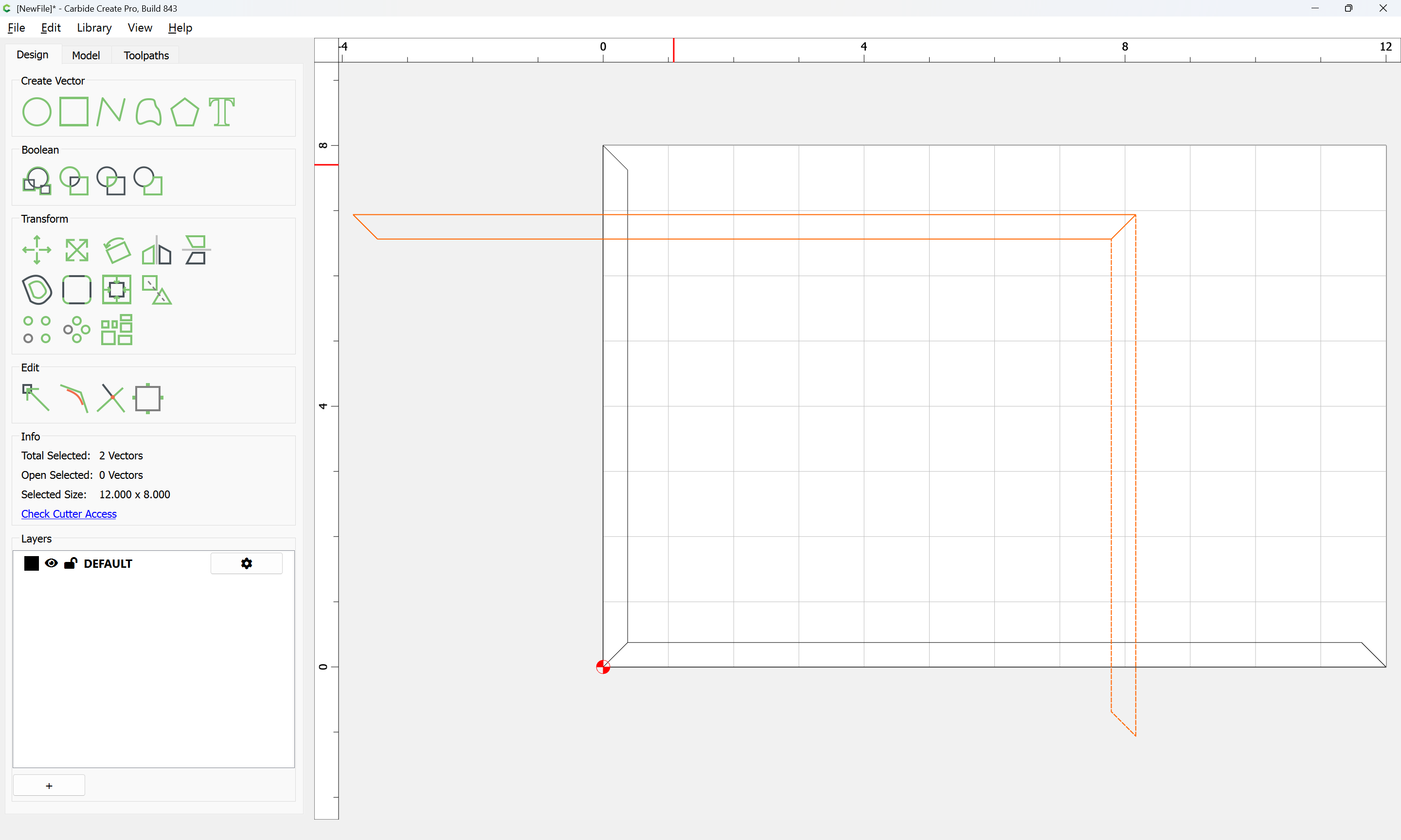

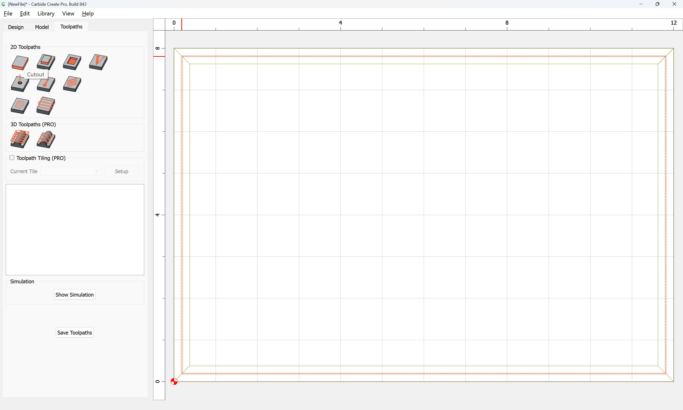

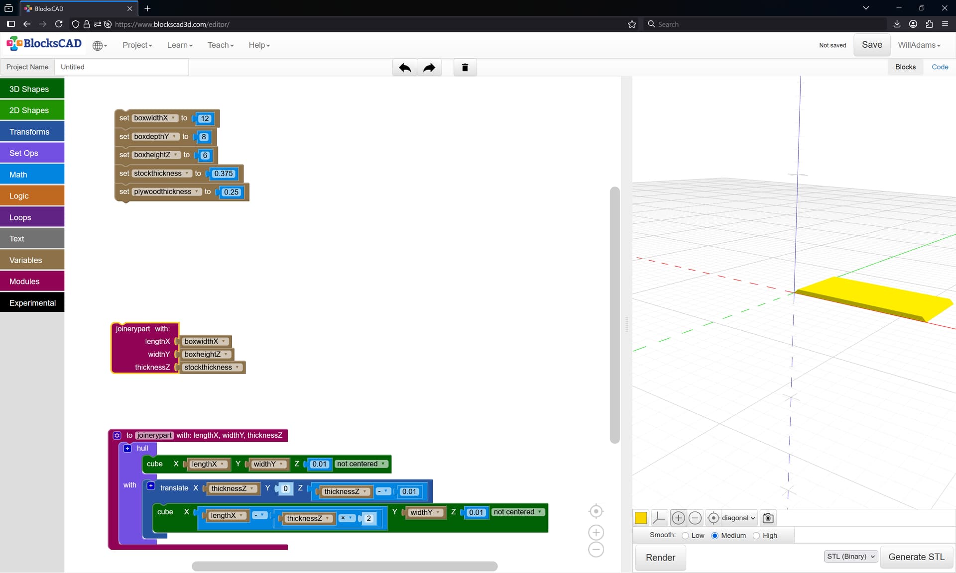

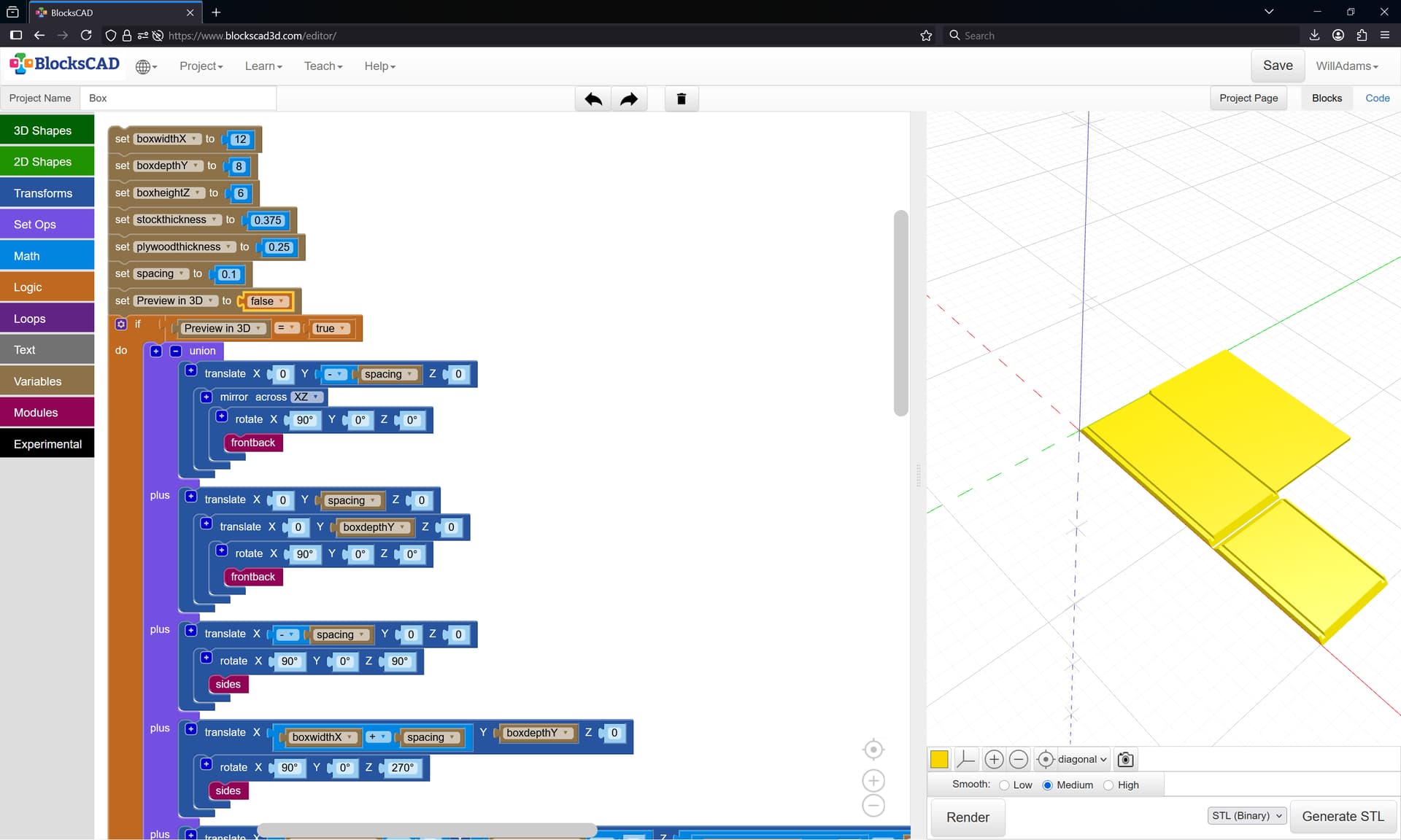

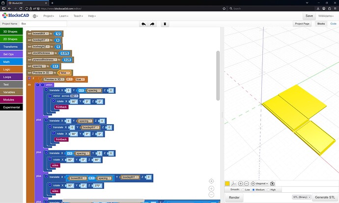

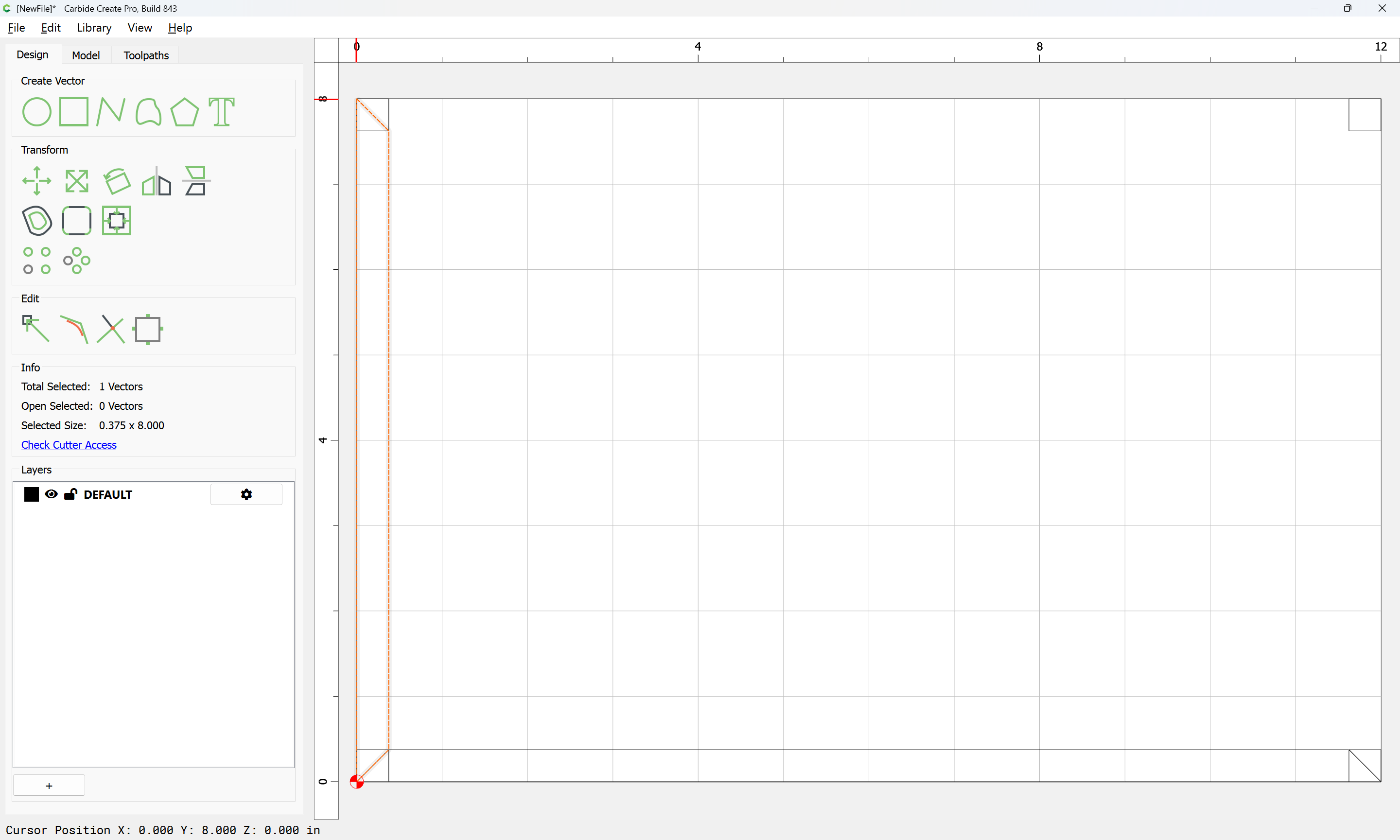

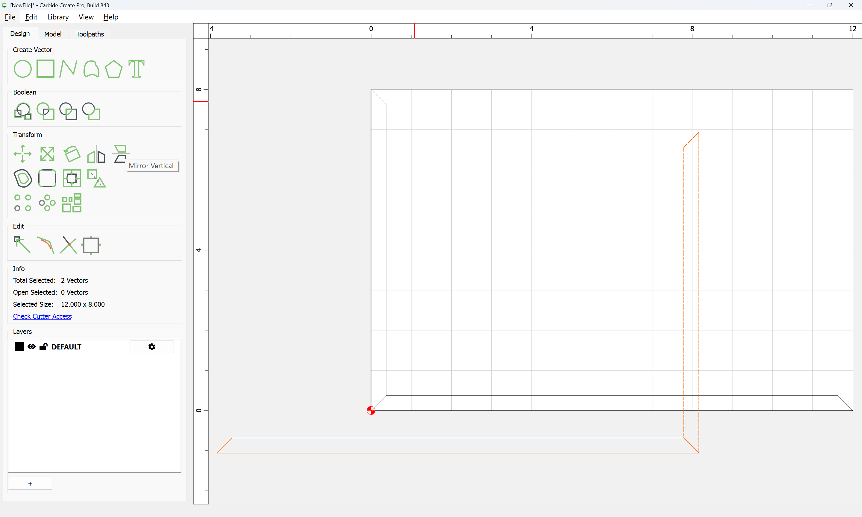

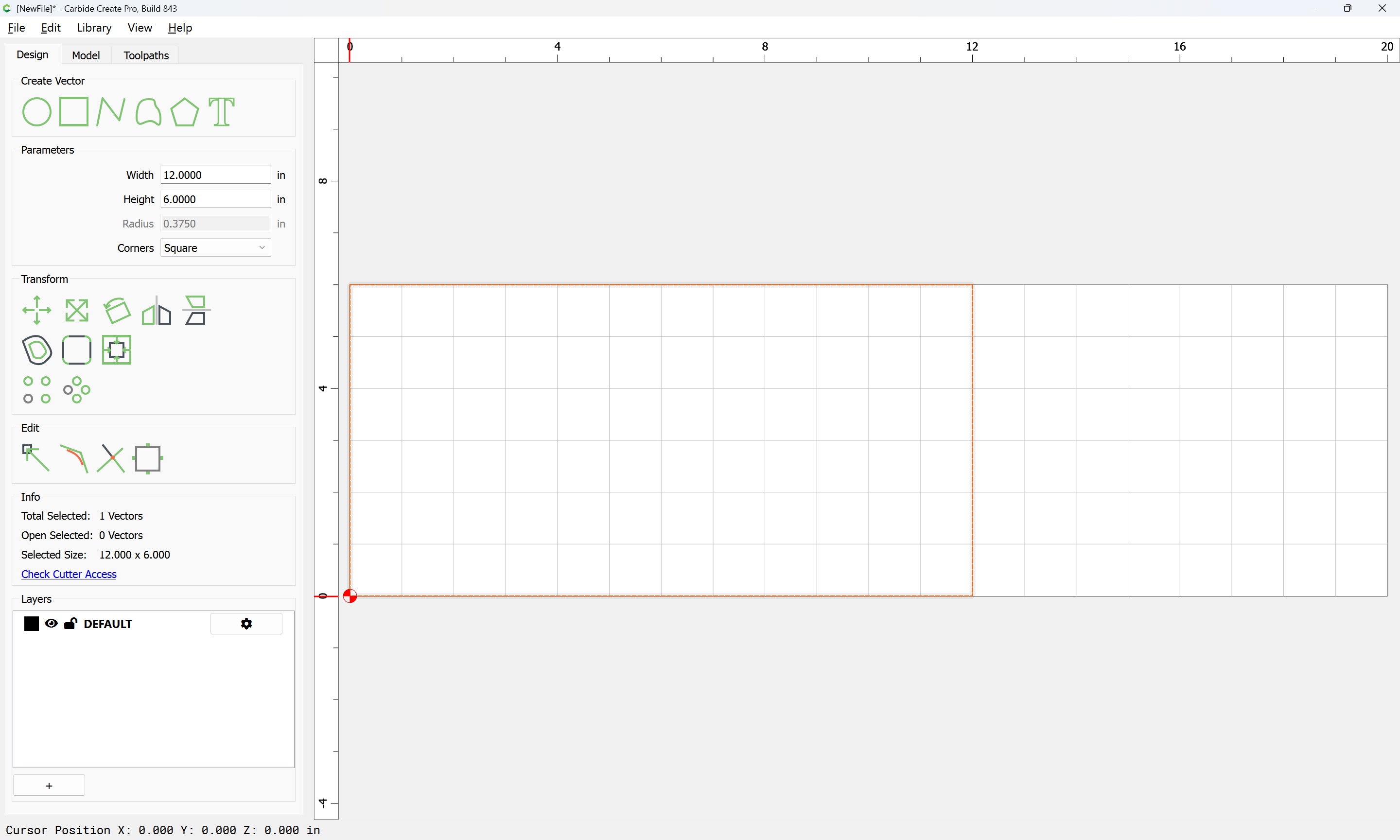

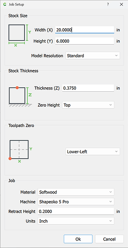

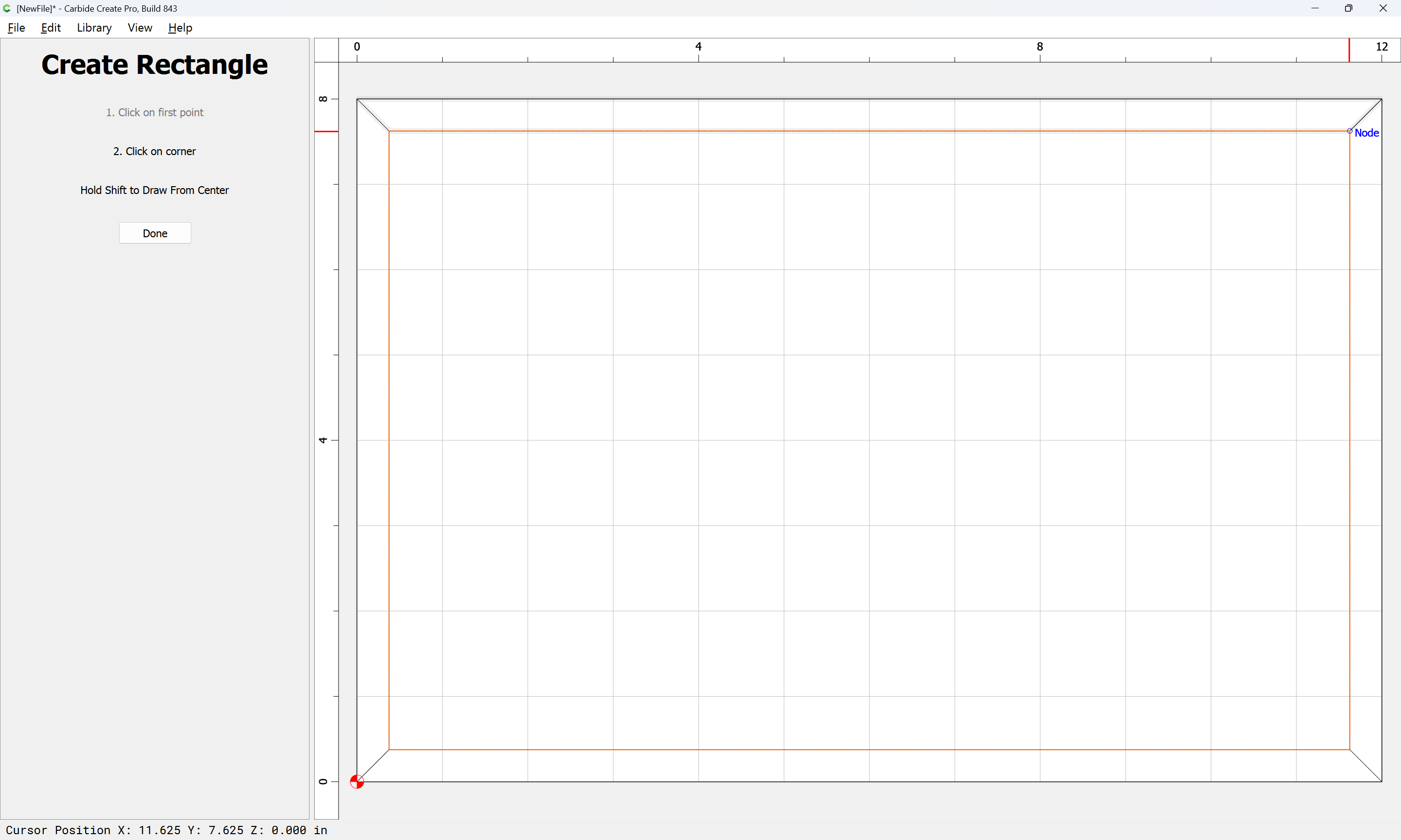

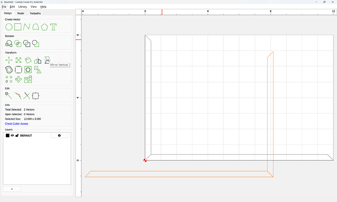

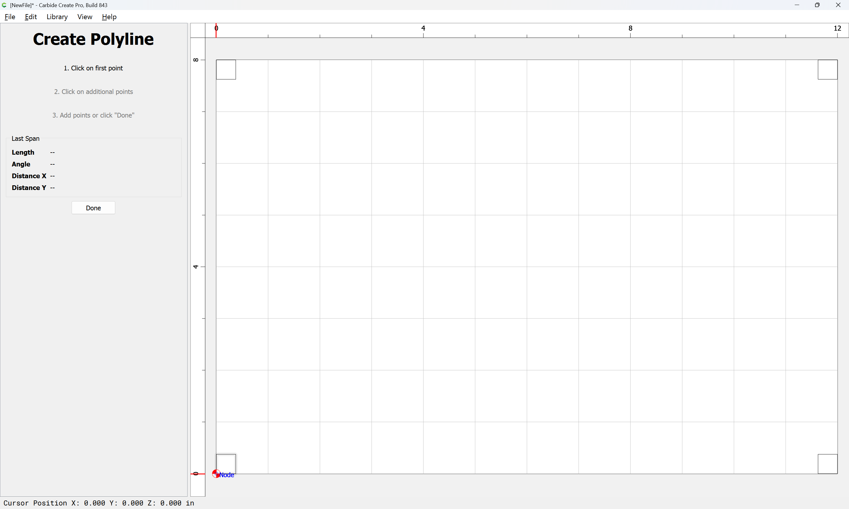

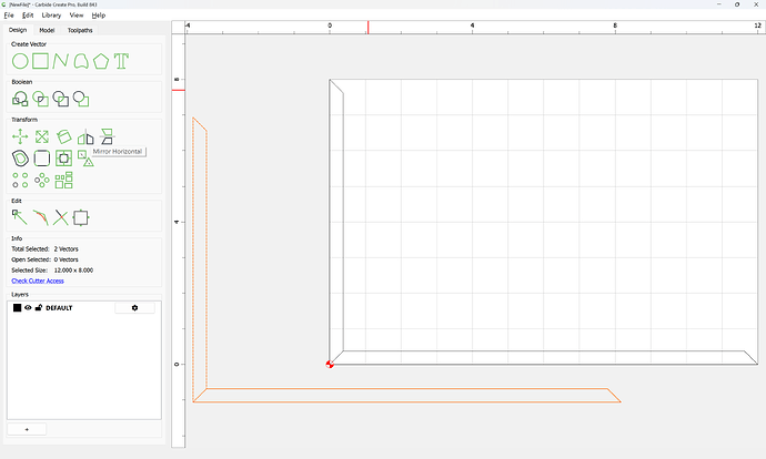

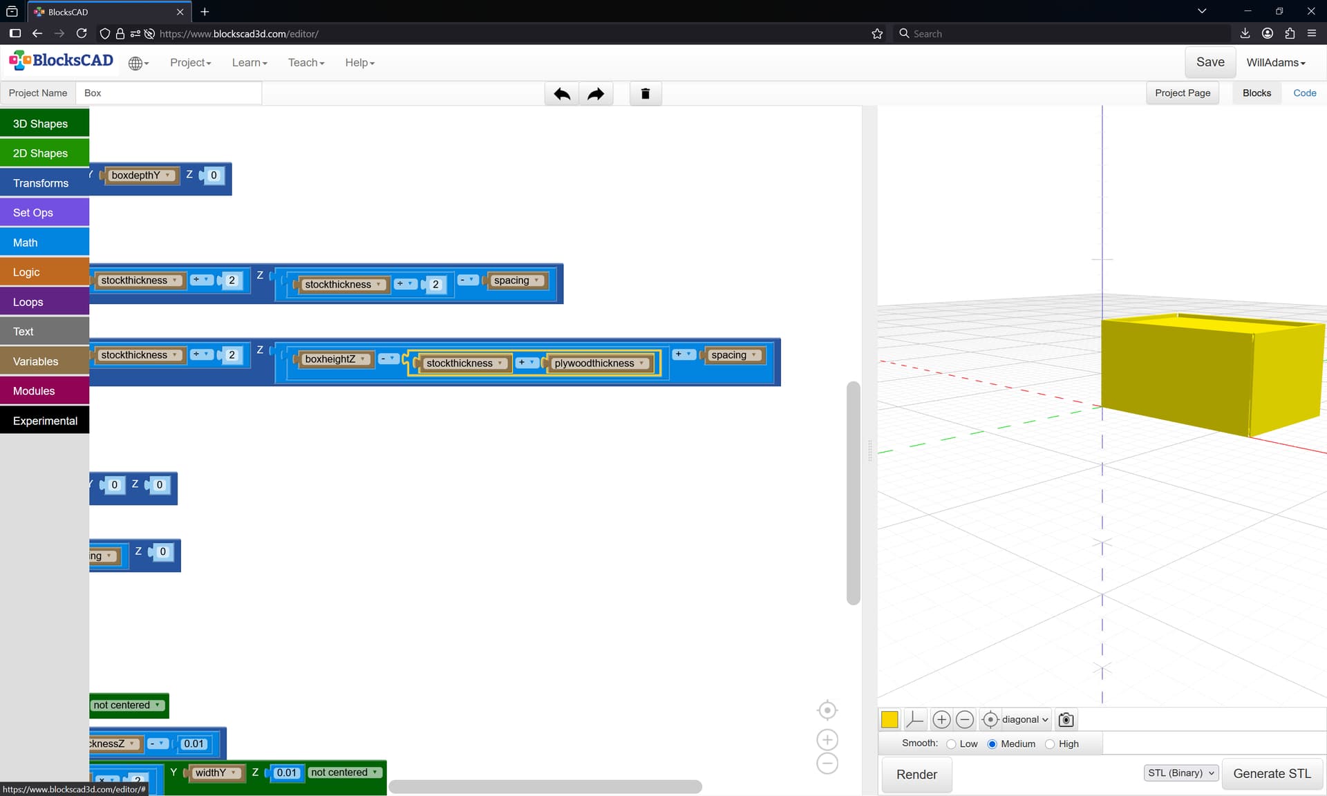

To work through the proportions initially we make a BlockSCAD file for previewing things:
which just wants a bit of rotating and re-arranging:
and which we can use to visualize the parts as well:

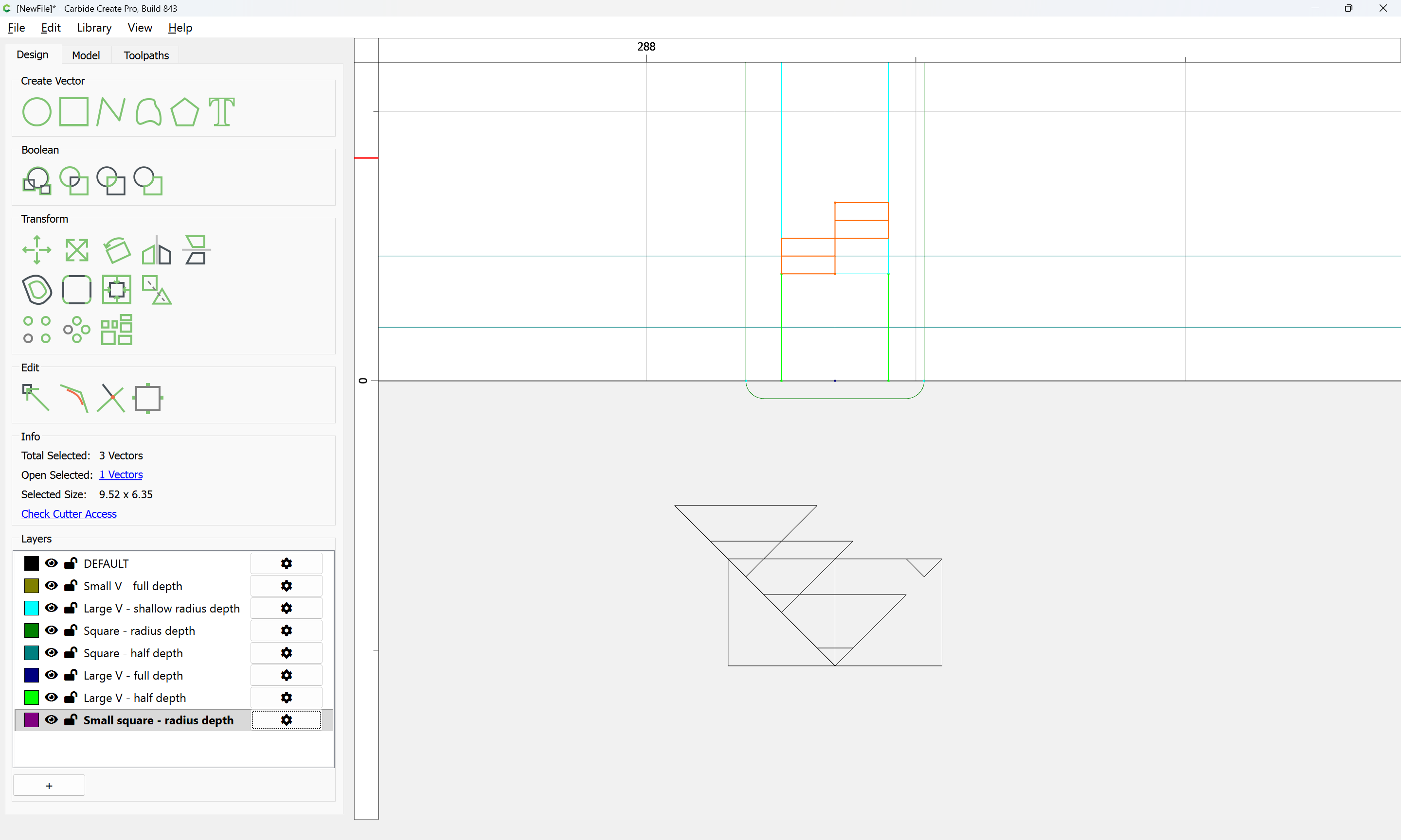

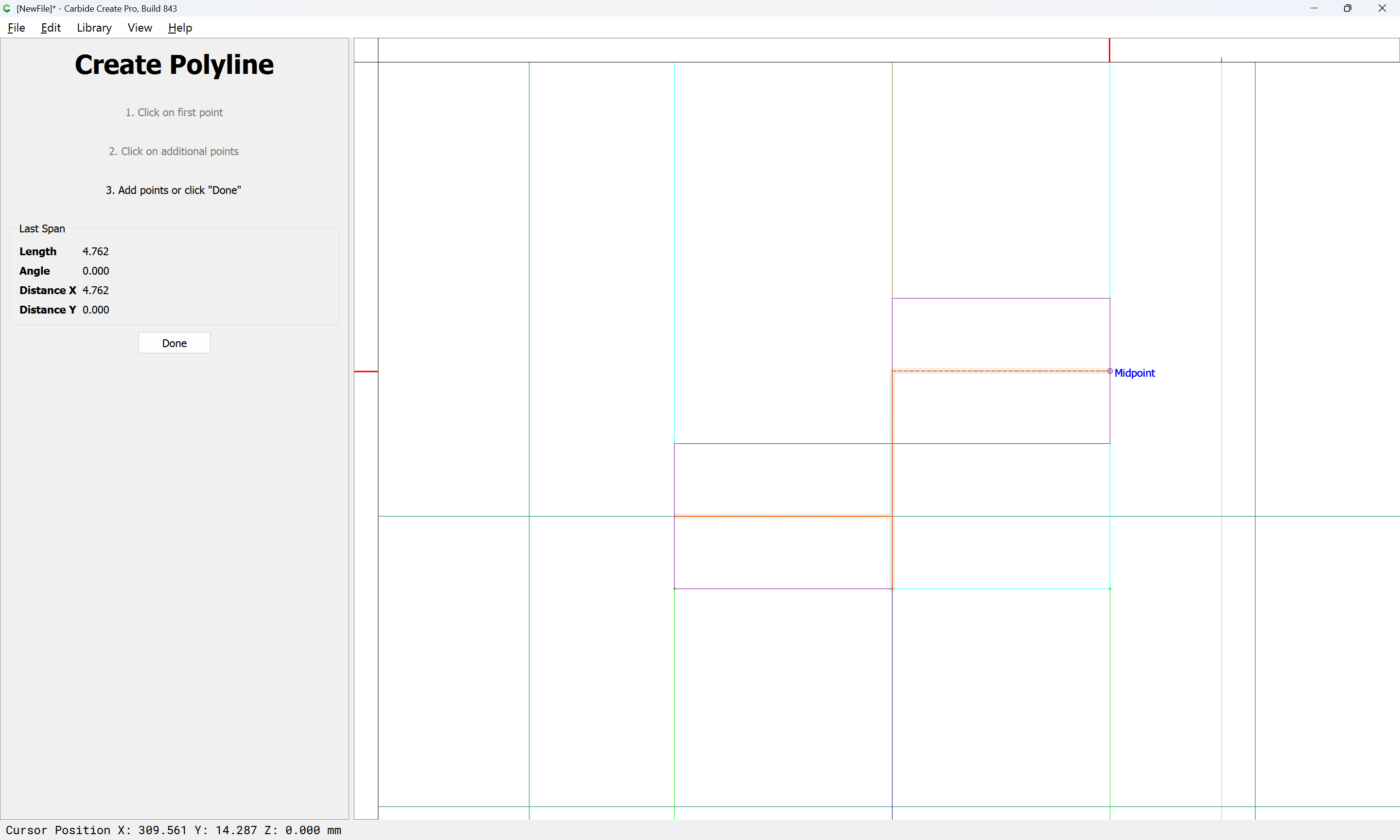

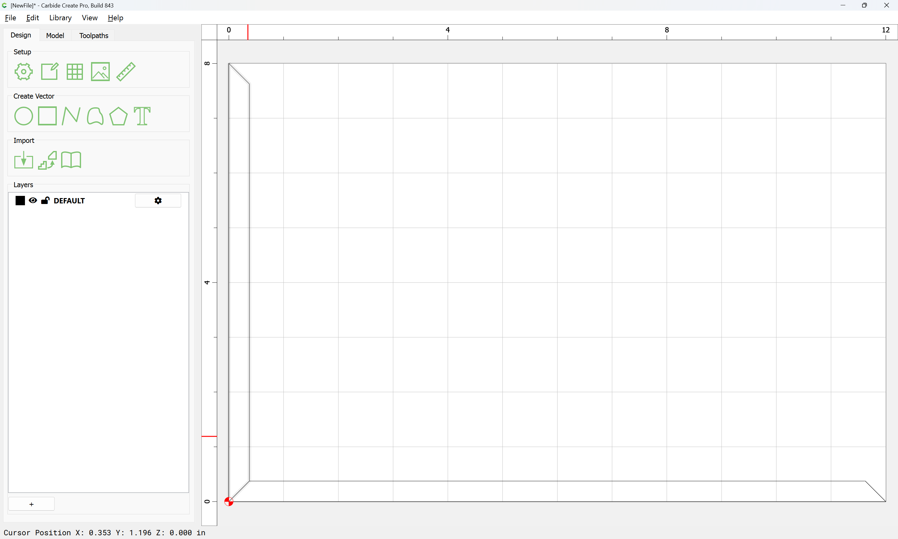

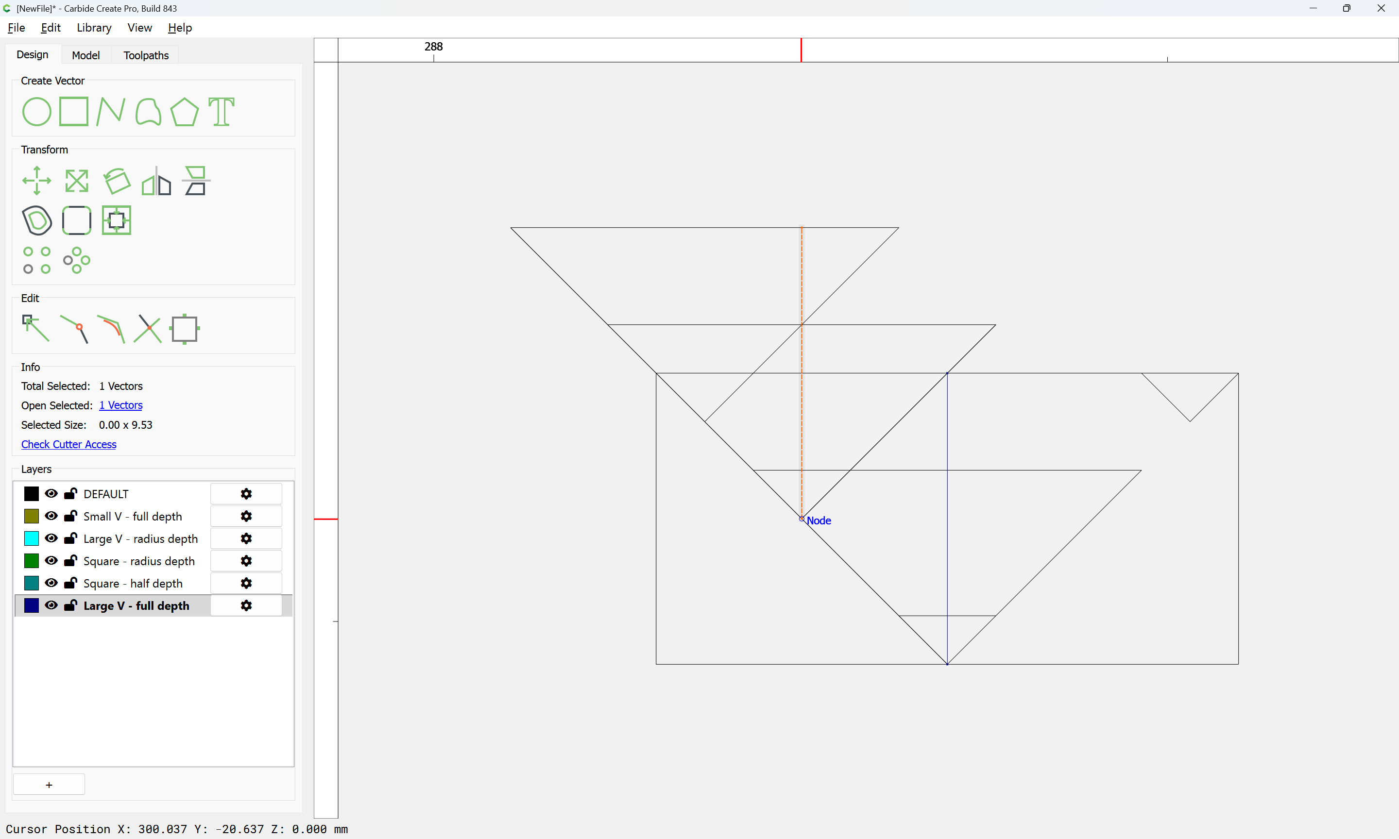

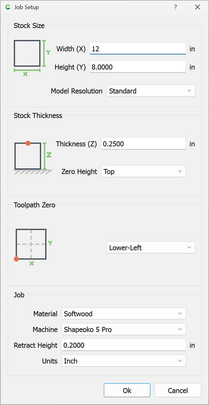

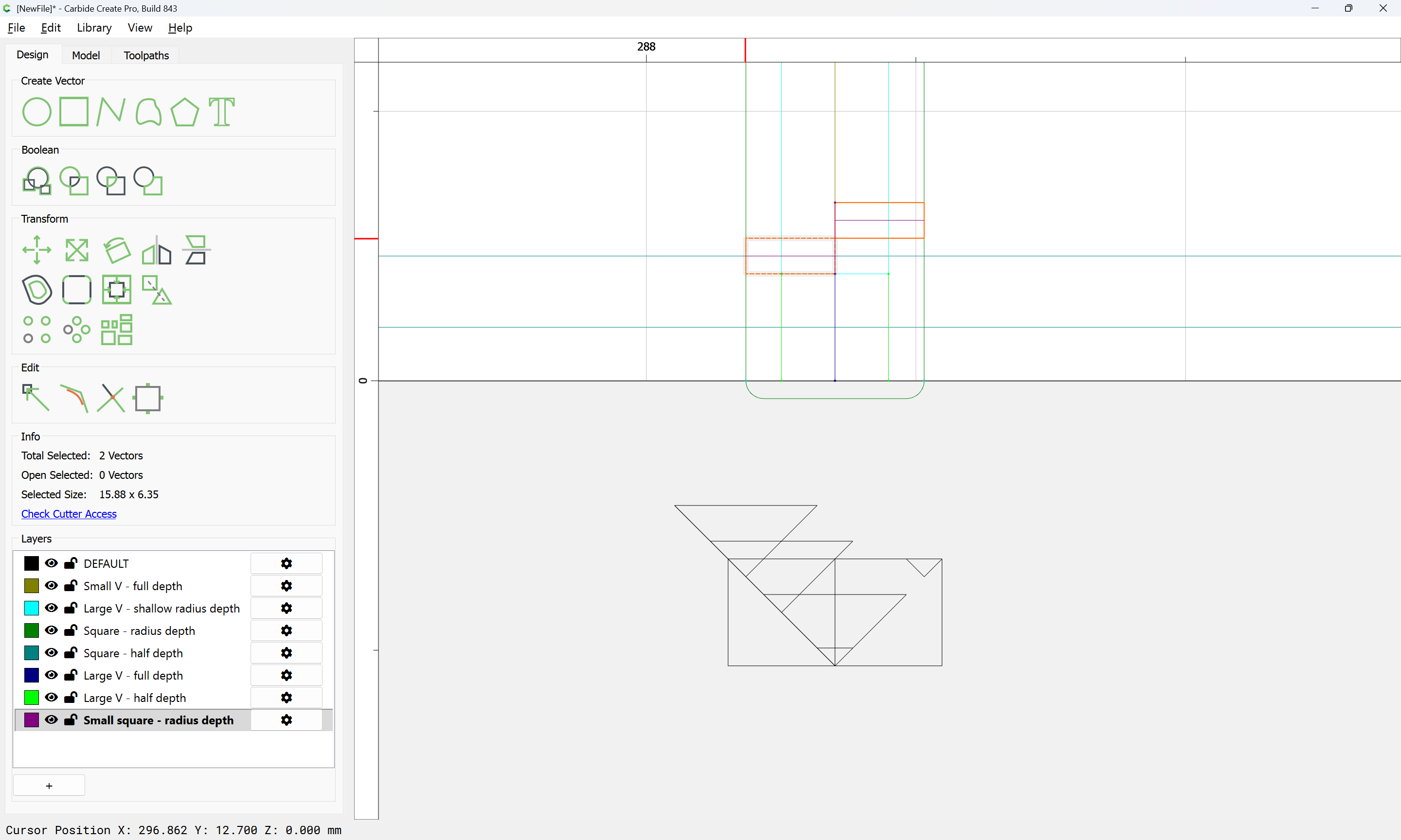

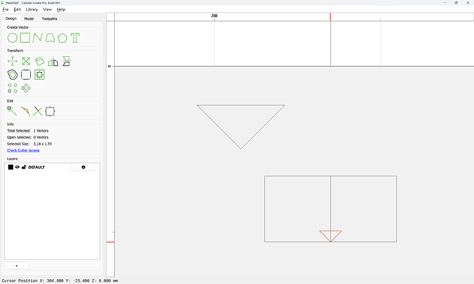

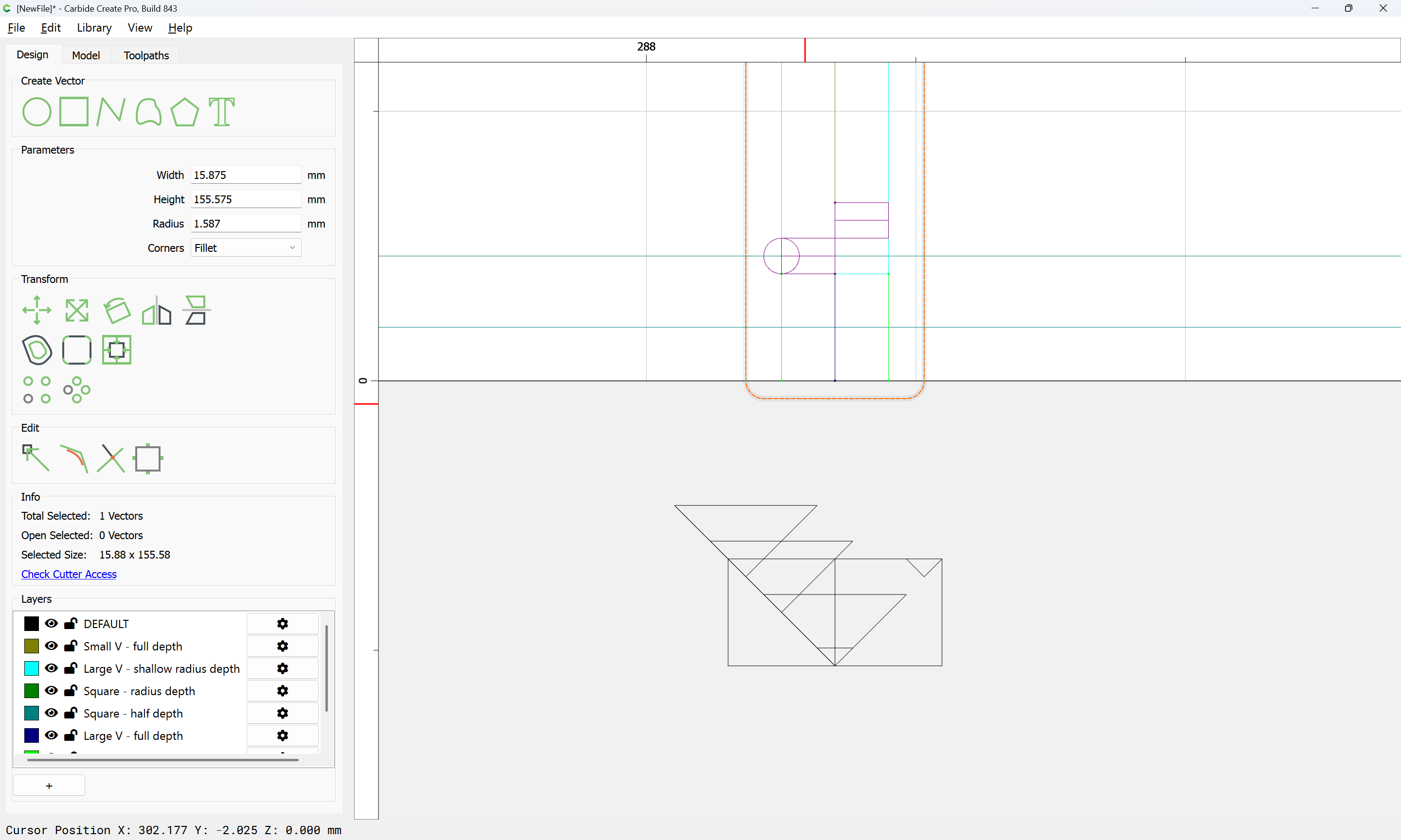

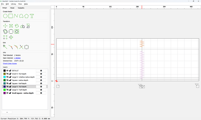

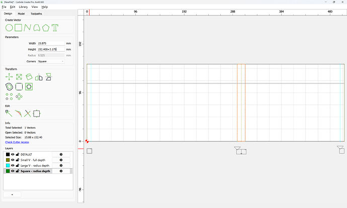

Setting up cutting the front/side in Carbide Create is pretty straight-forward:
with one consideration being where the cut for separating the lid will need to be — 3/4 of the height for the bottom, and 1/4 for the top seems workable:
Then it’s simply a matter of setting up the toolpaths…

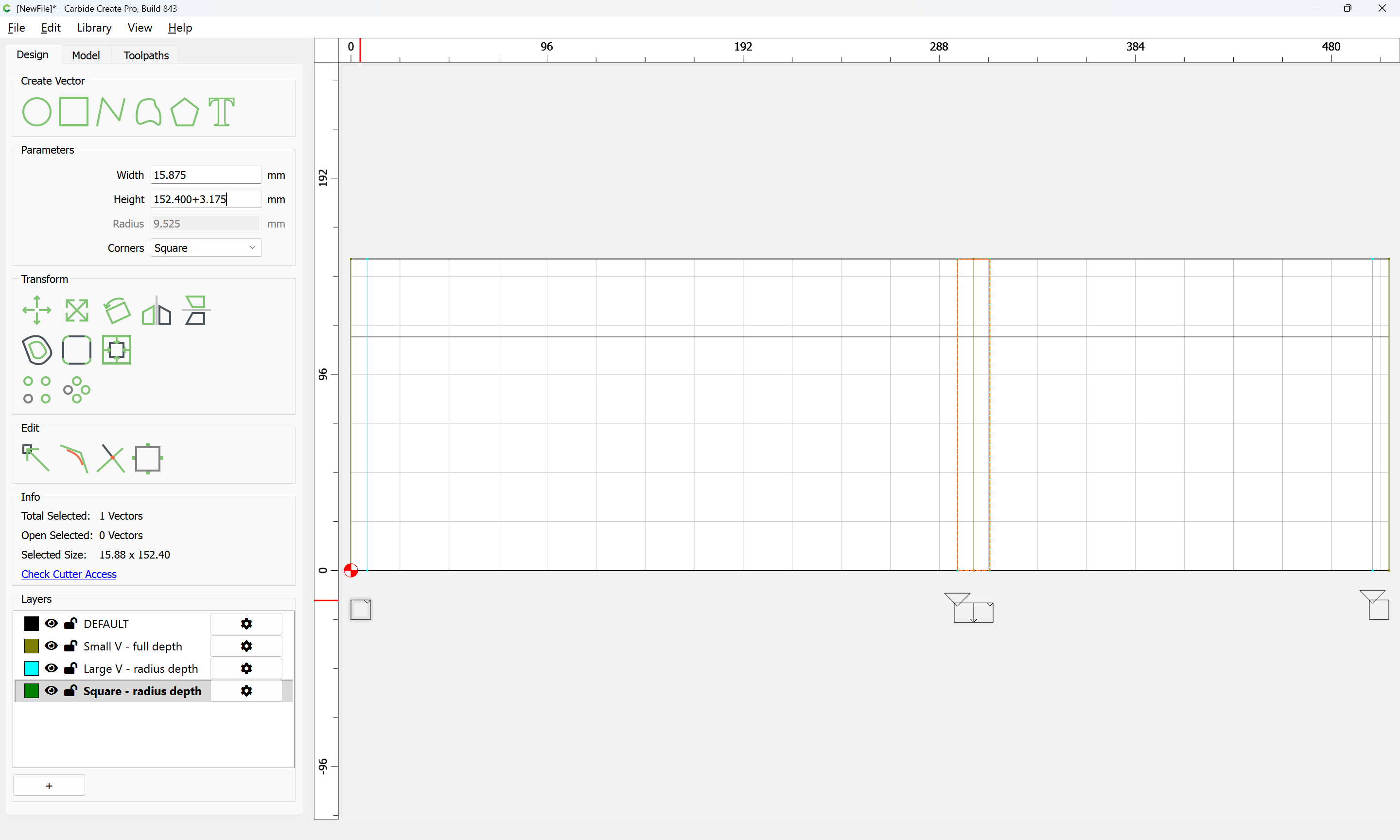

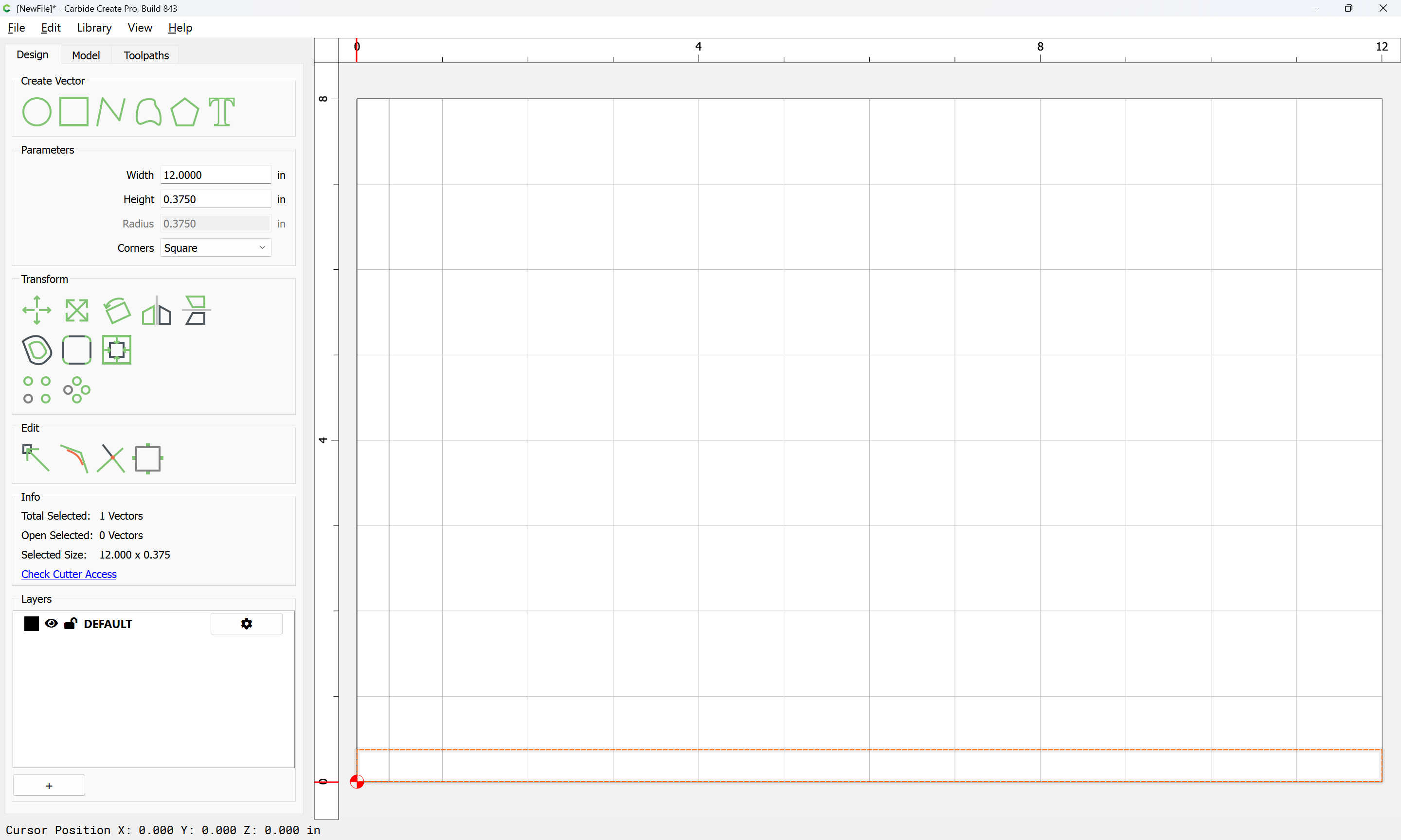

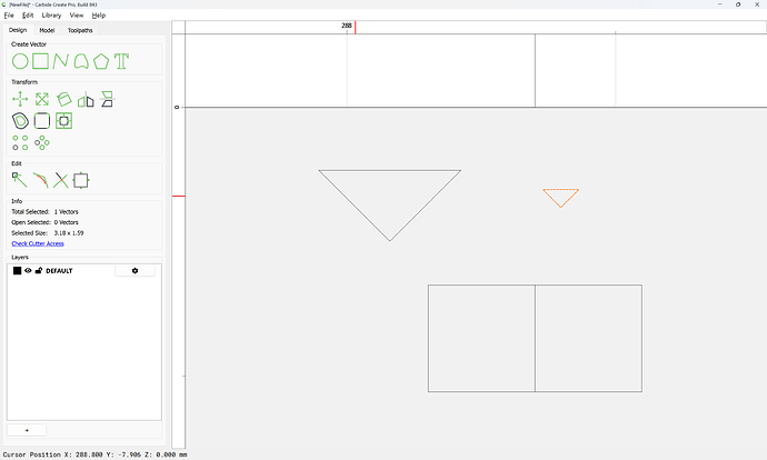

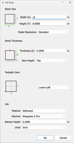

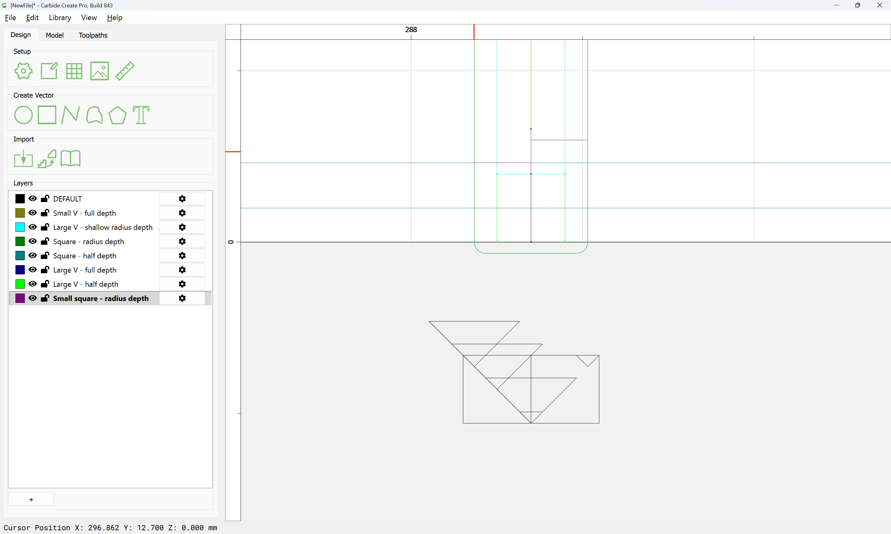

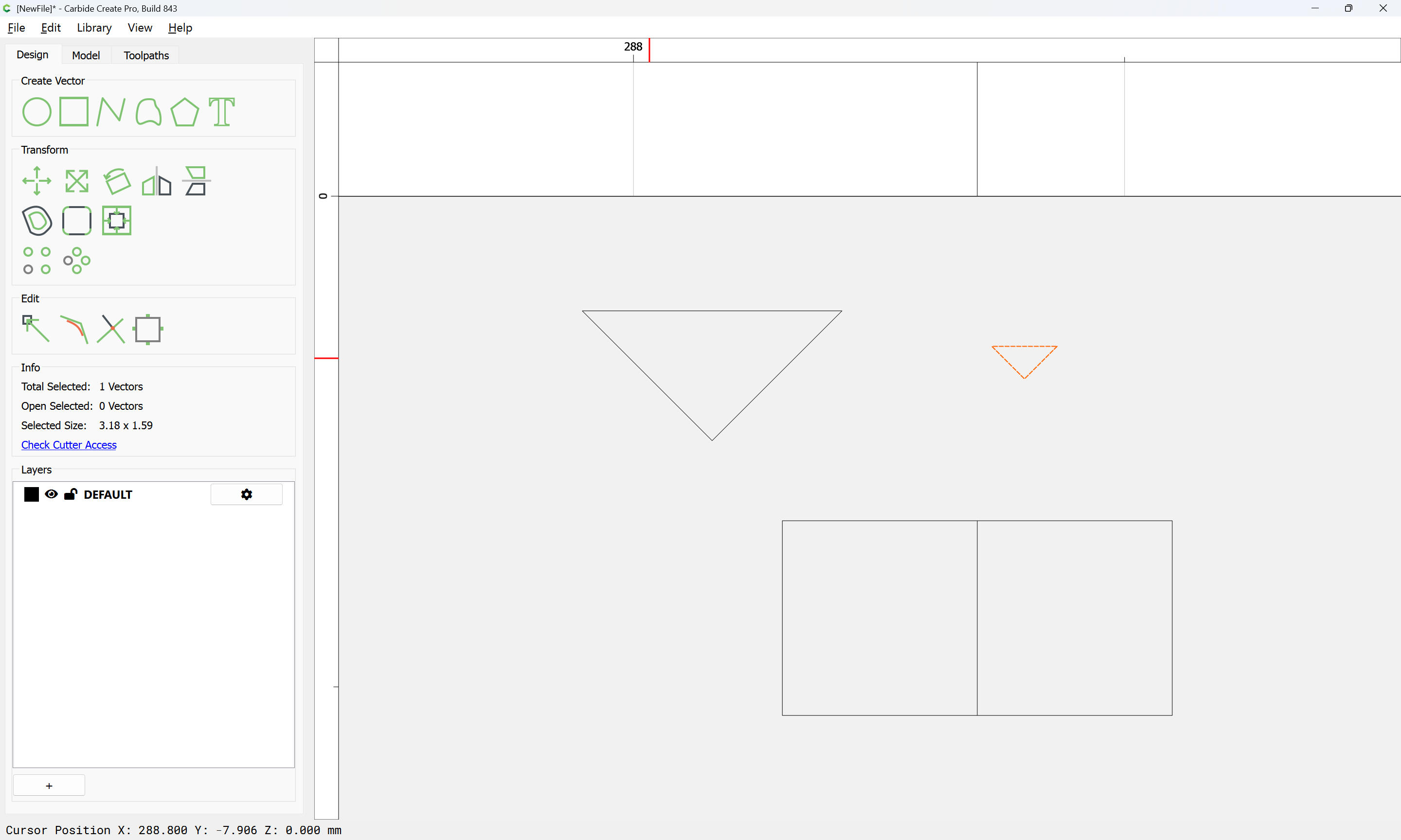

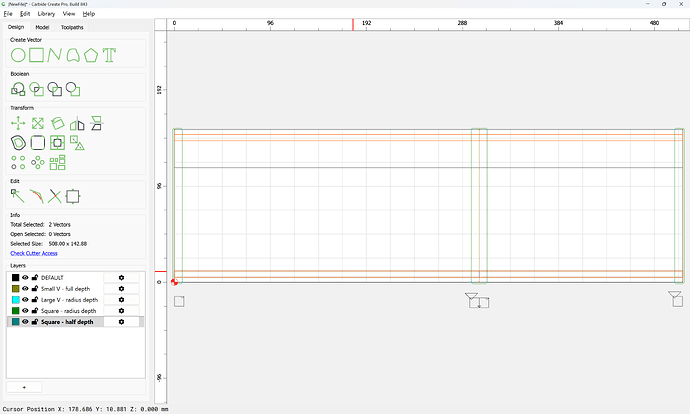

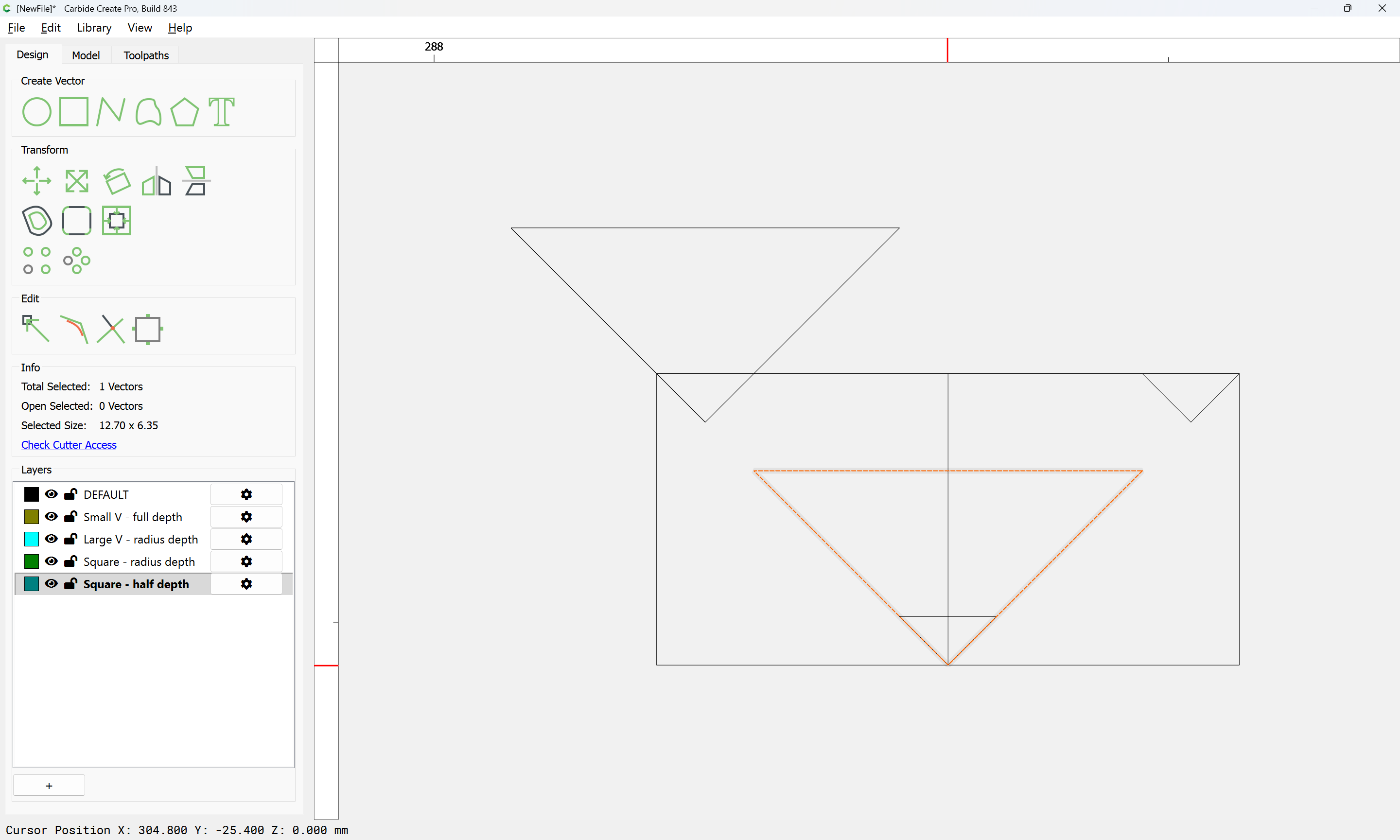

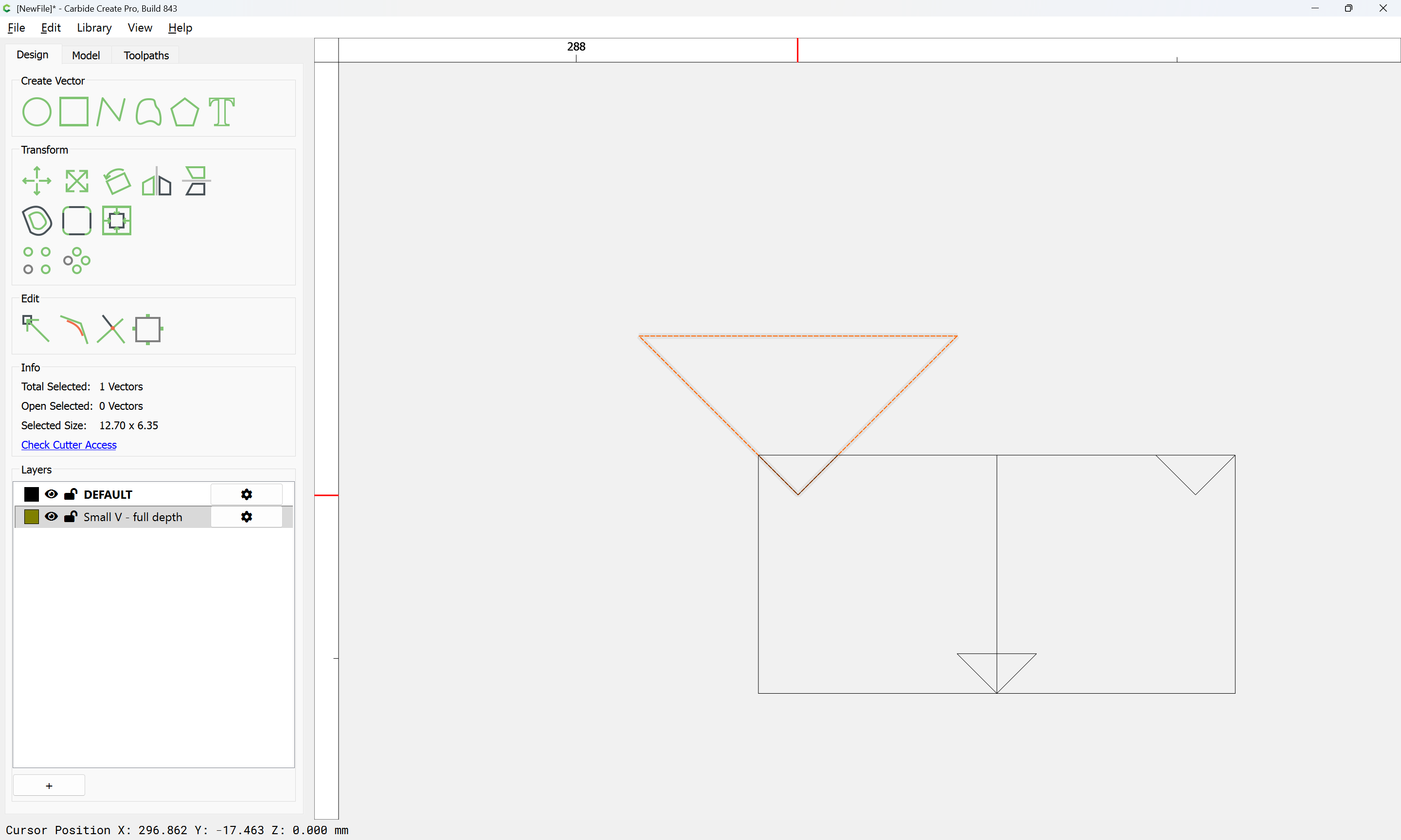

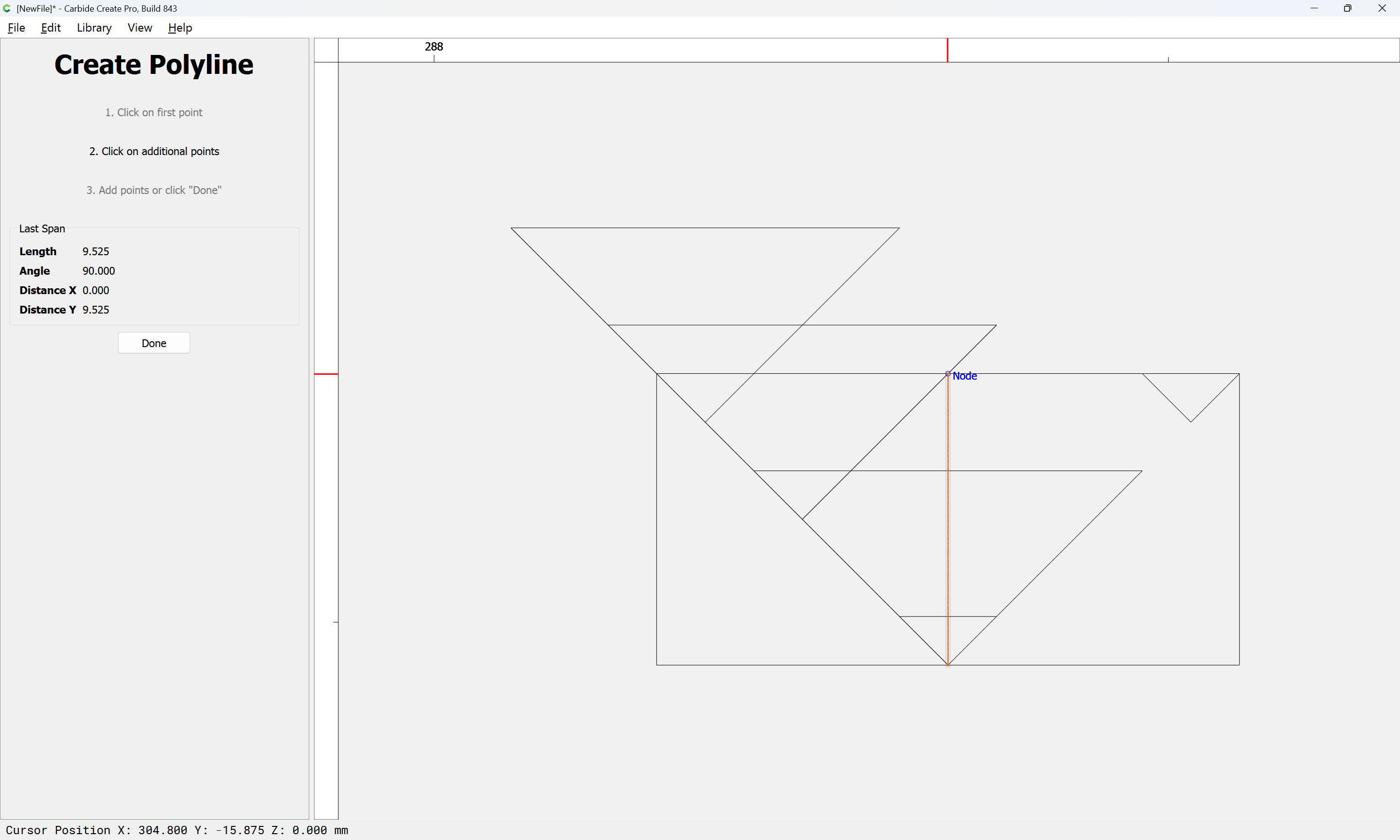

Setting up the toolpaths requires drawing up the stock in profile:
as well as the tooling:

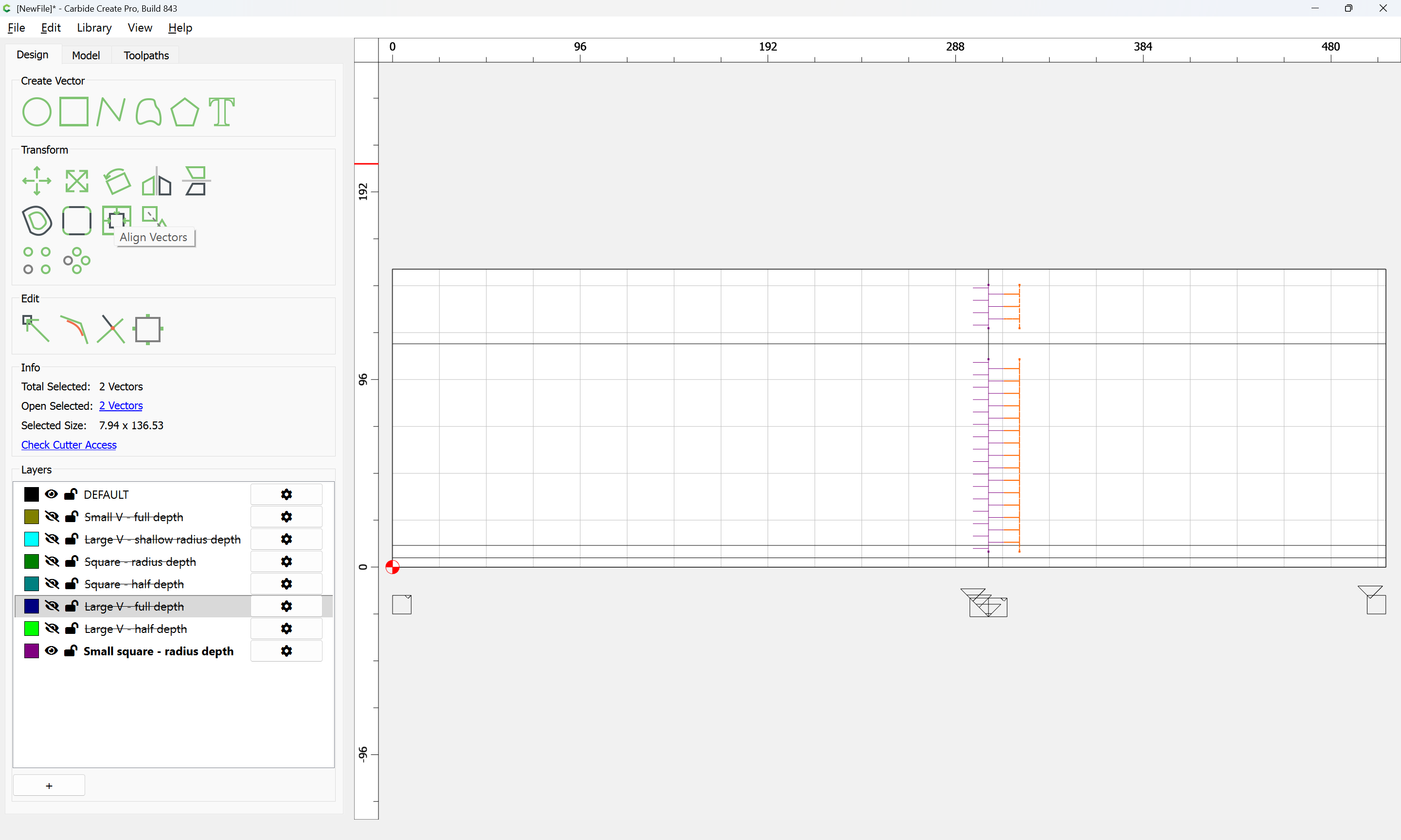

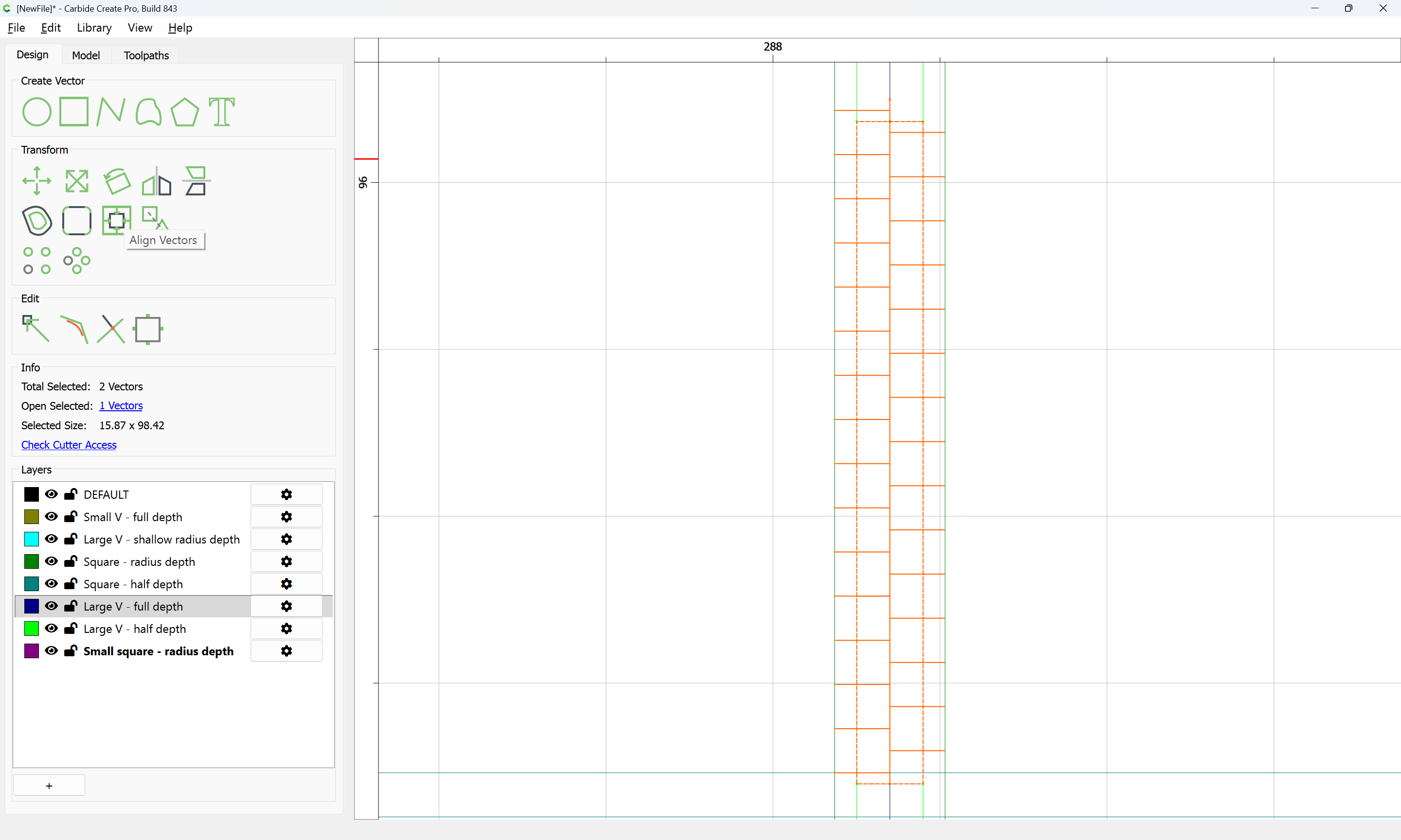

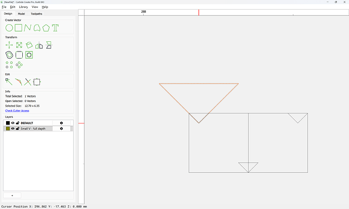

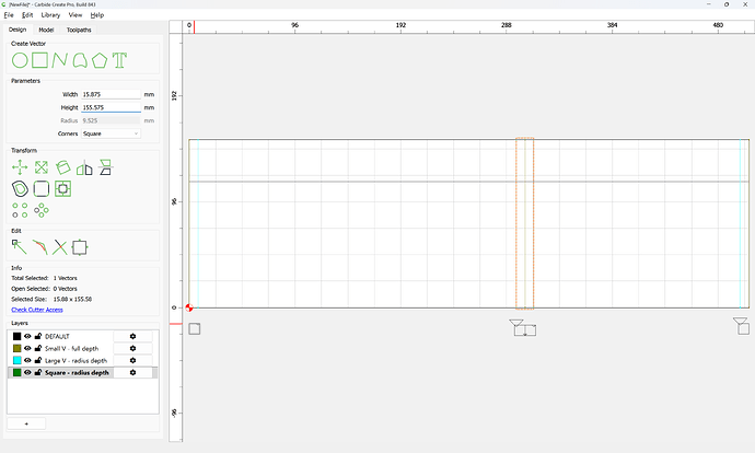

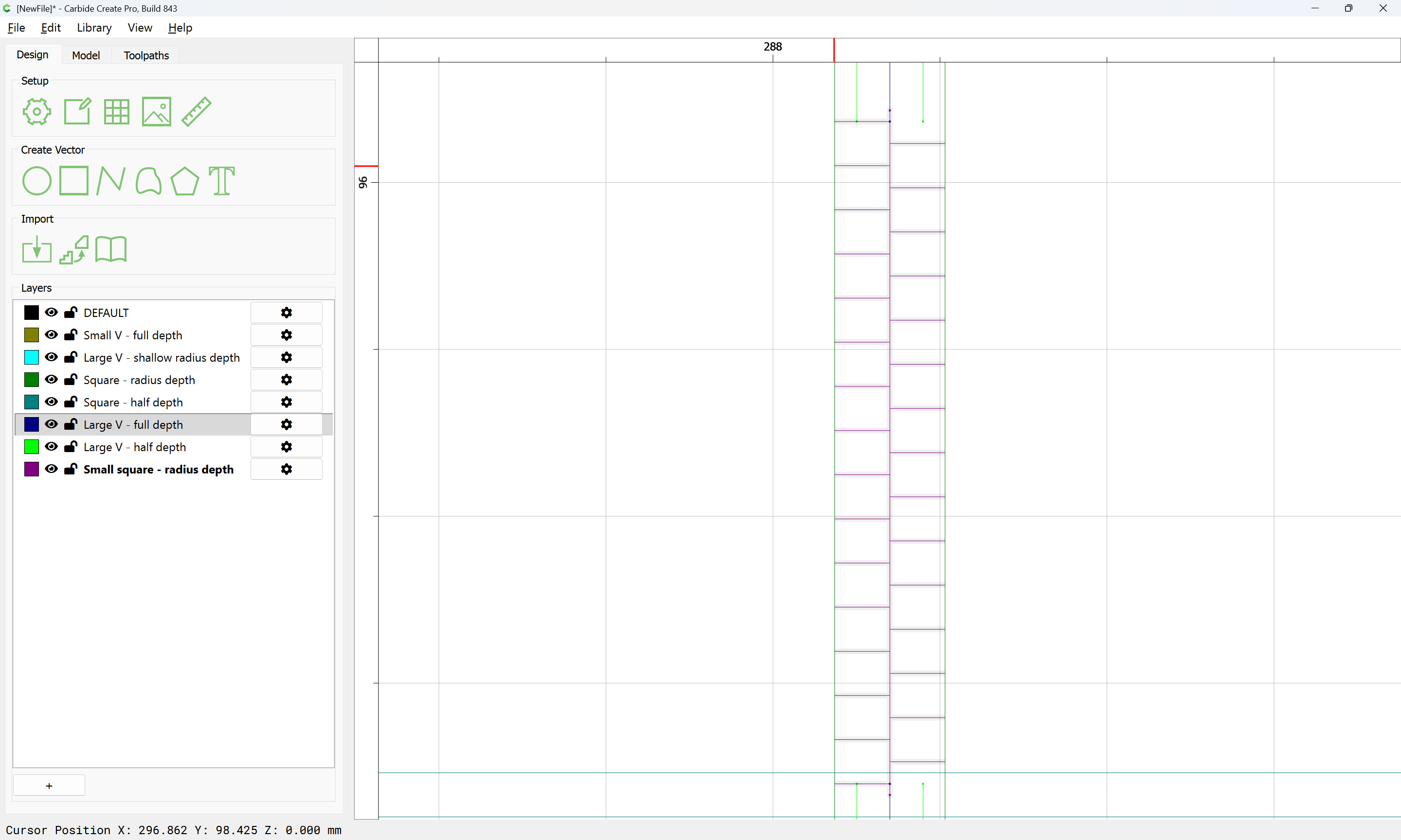

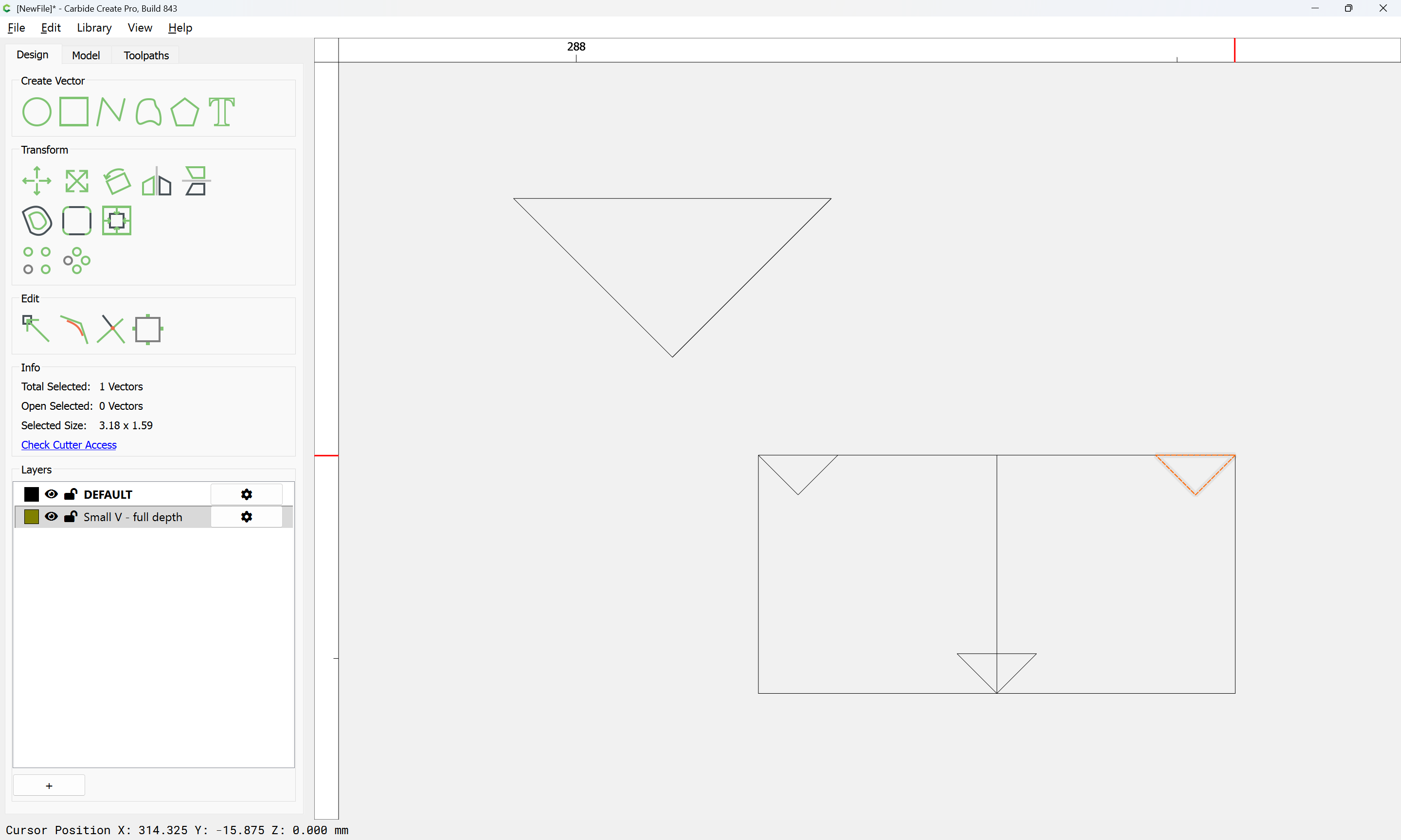

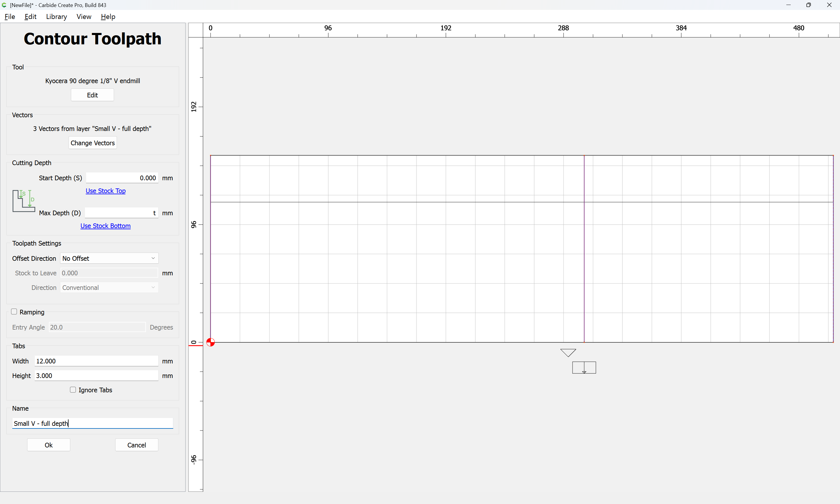

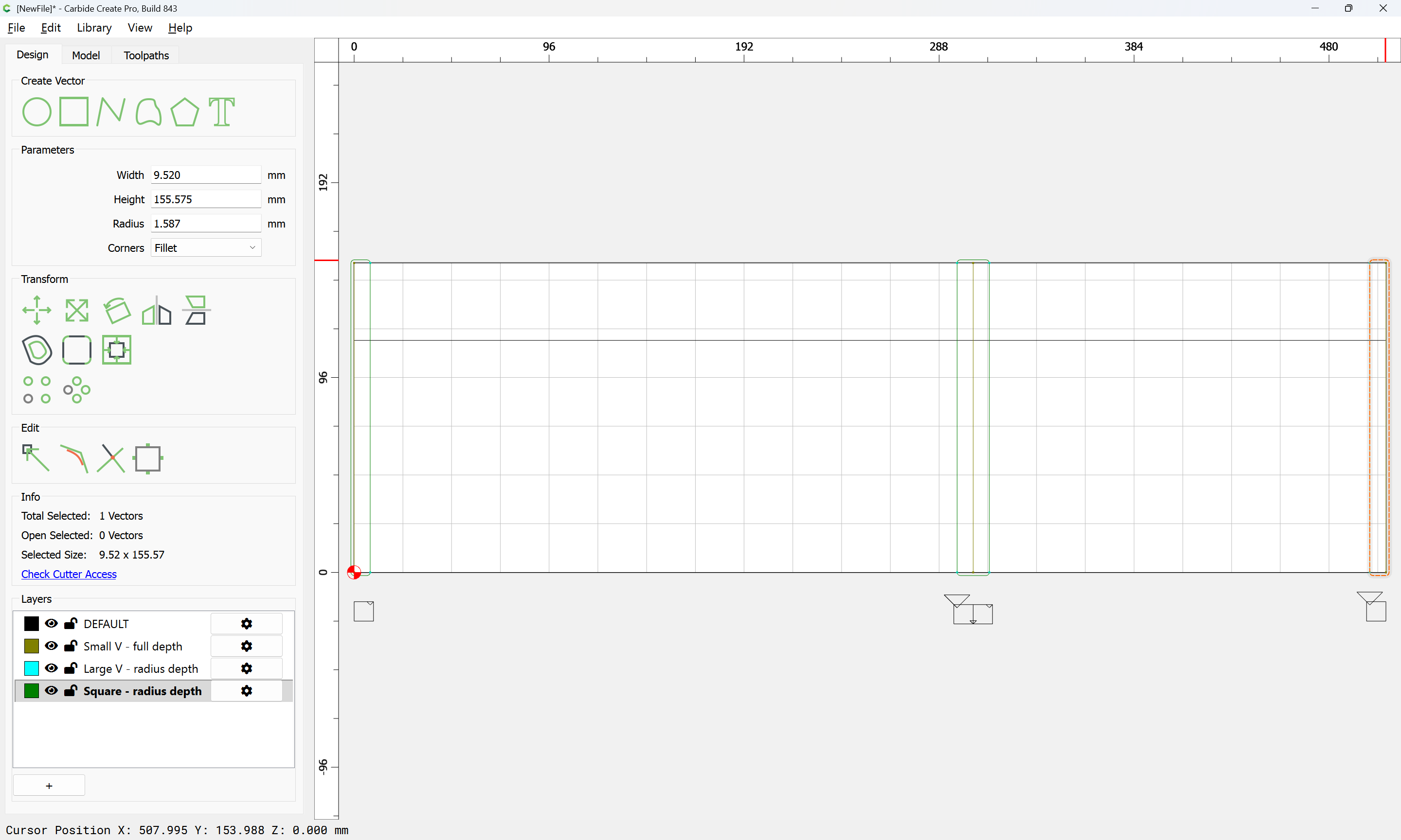

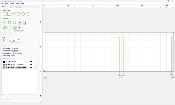

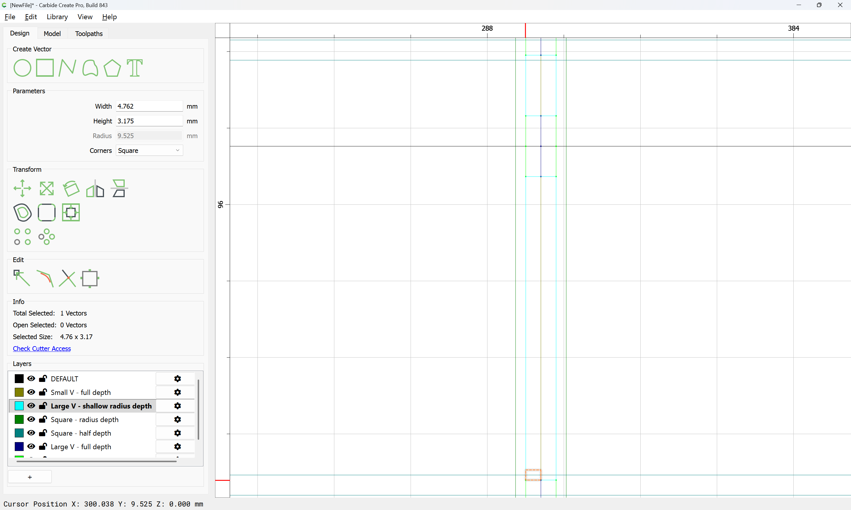

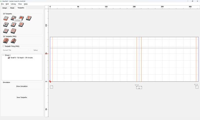

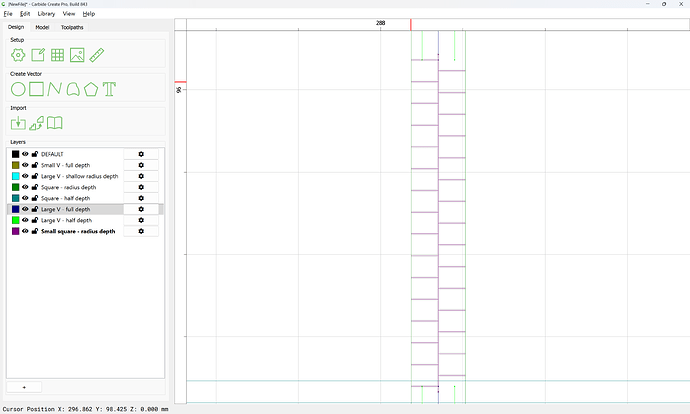

Since a narrow V tool will be used to cut a channel along the edge of the joint, that is positioned first:

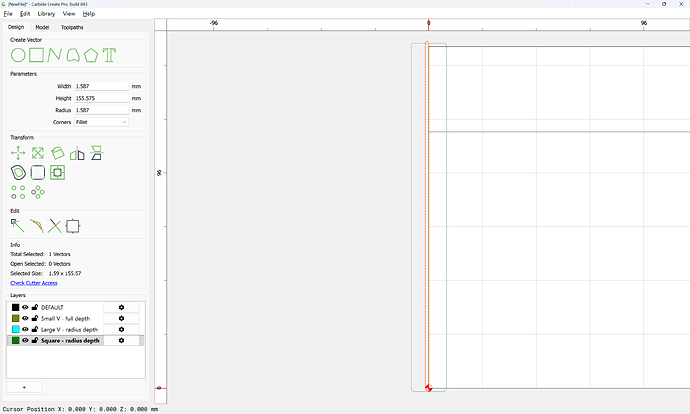

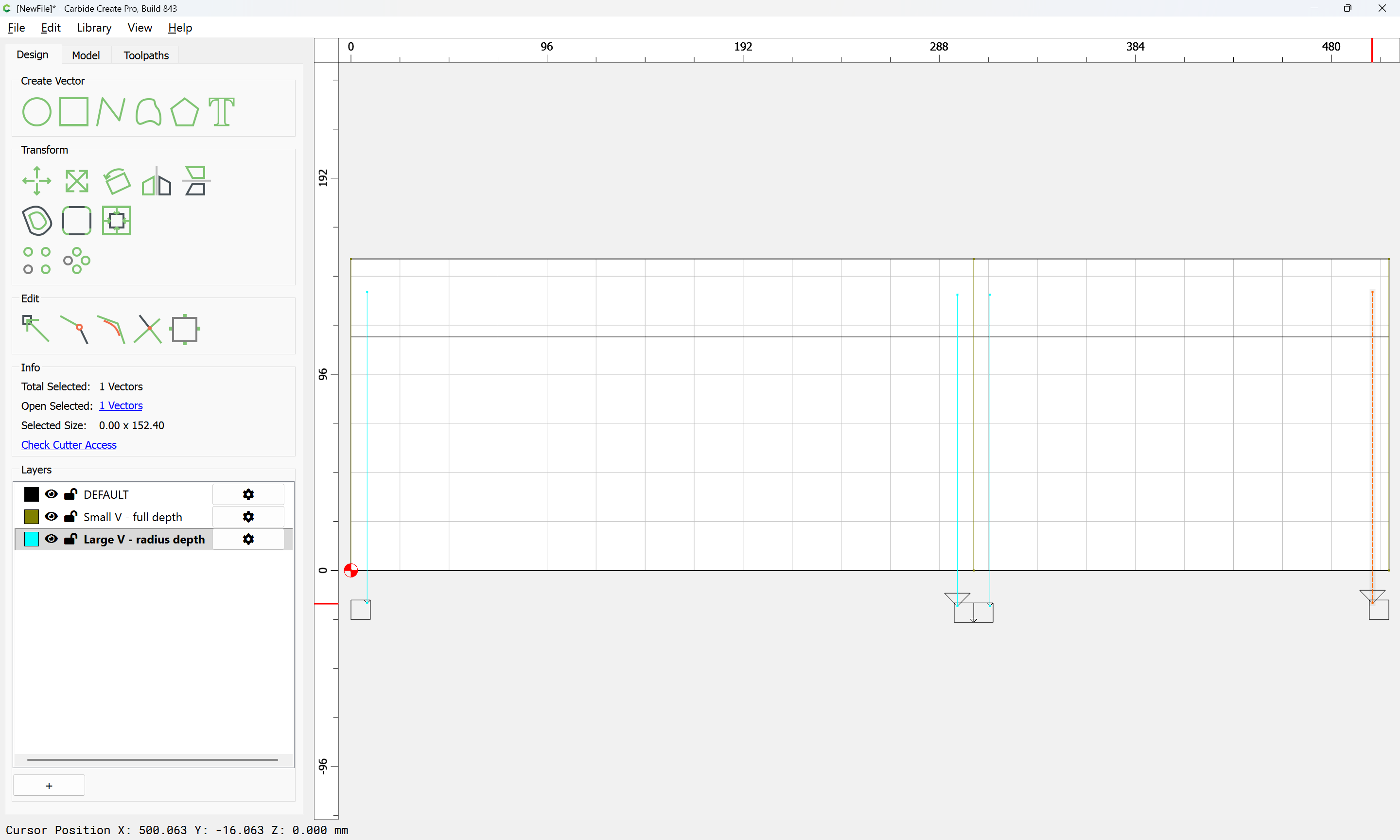

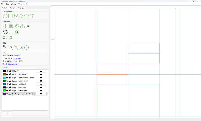

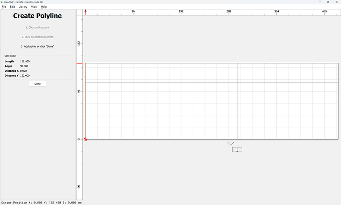

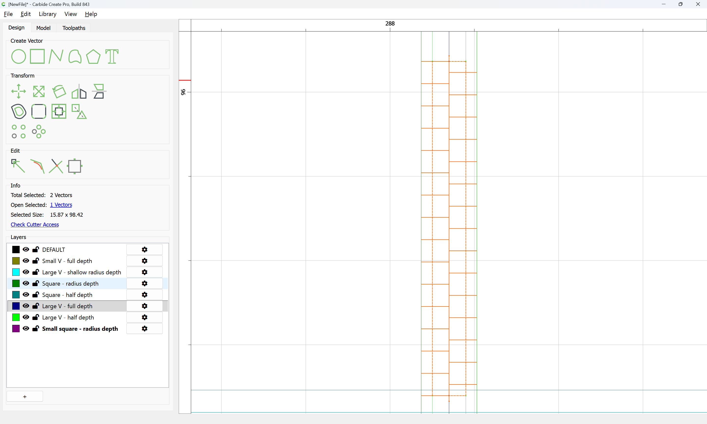

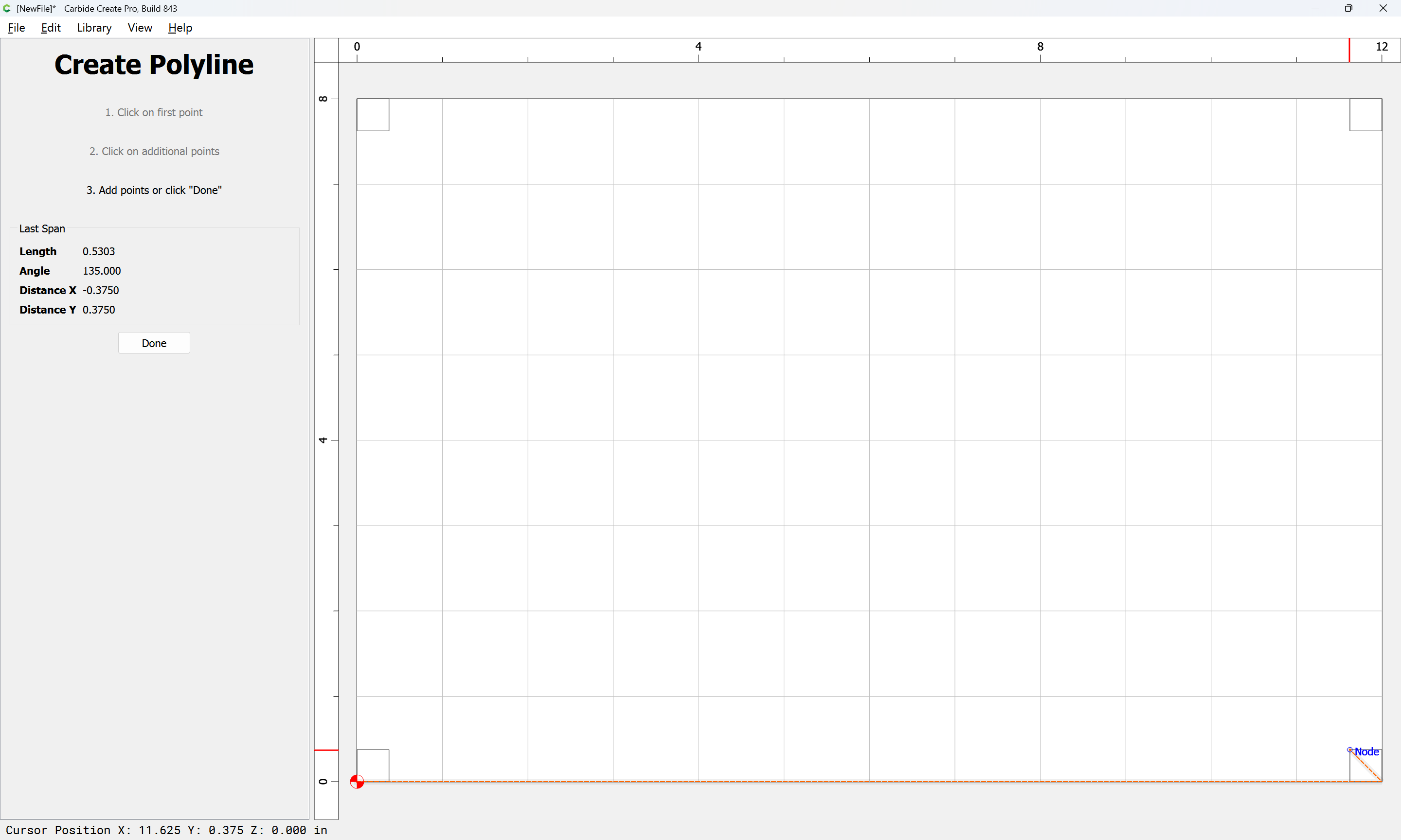

The toolpath for this is simply a line which defines the edge of each joint, for which we make a layer:
and then draw lines:
and then assign a toolpath to:

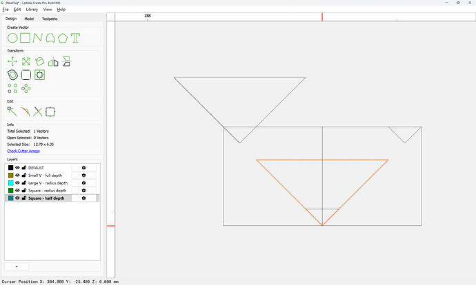

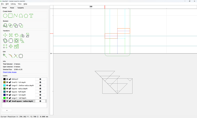

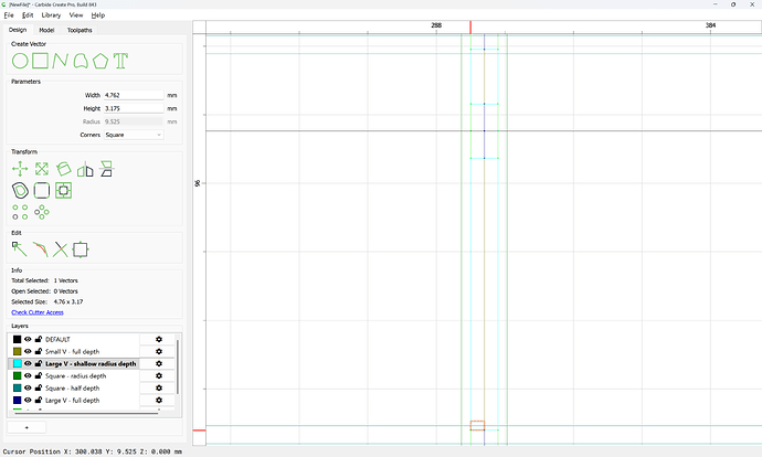

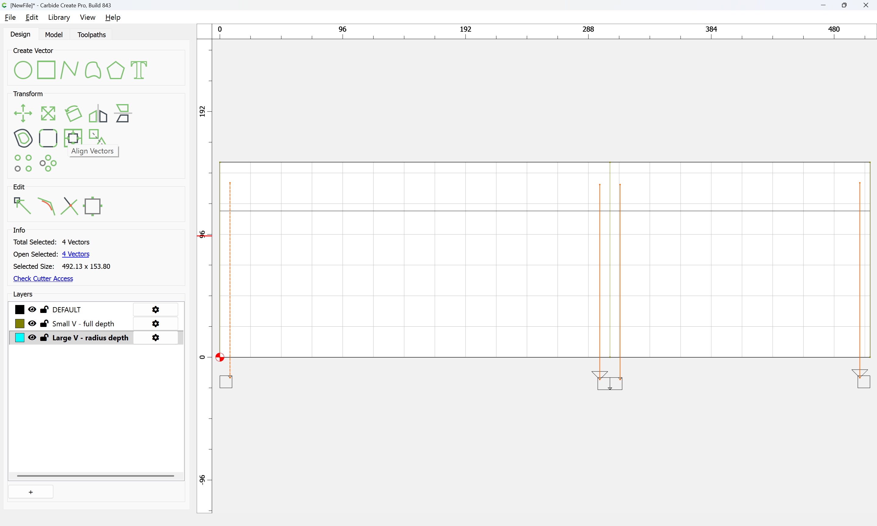

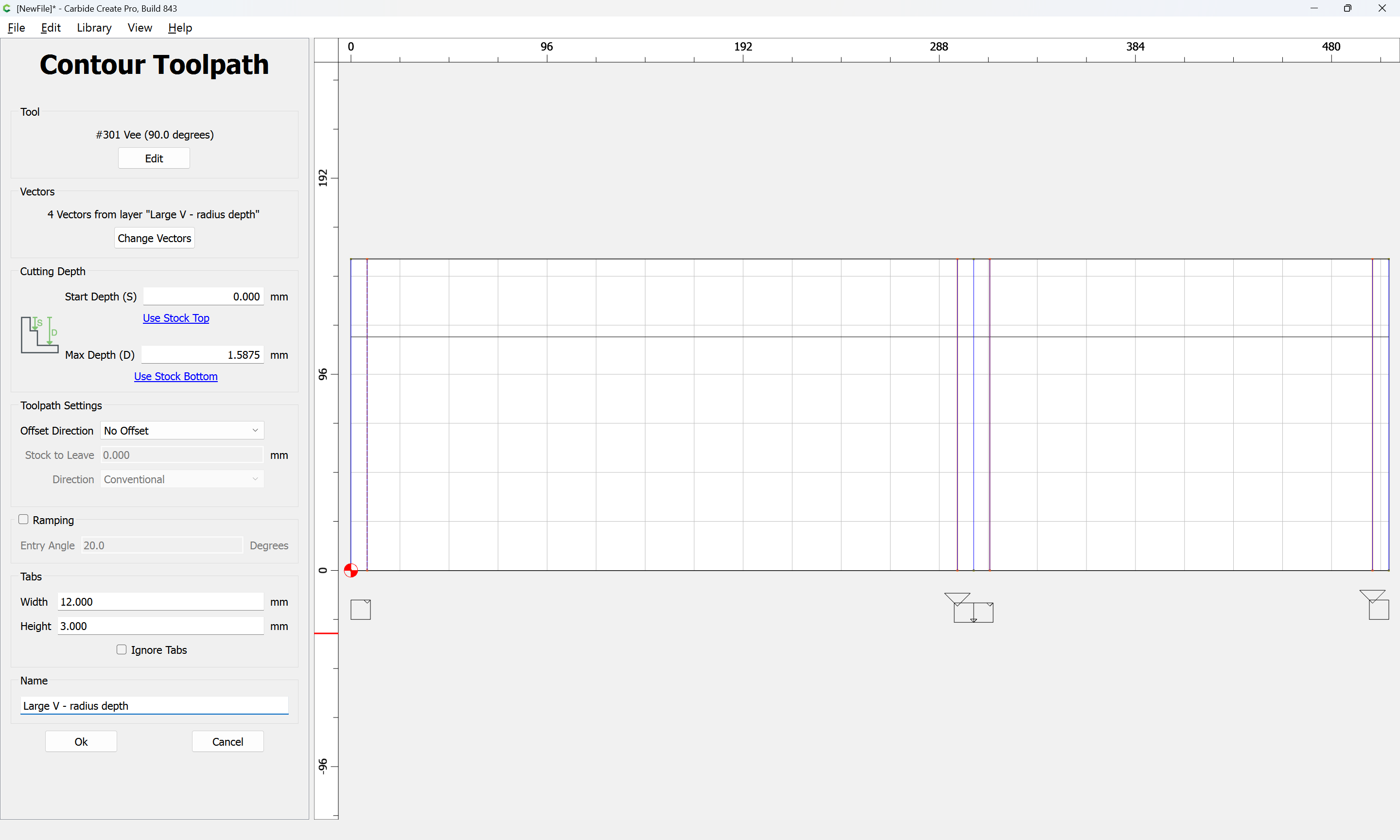

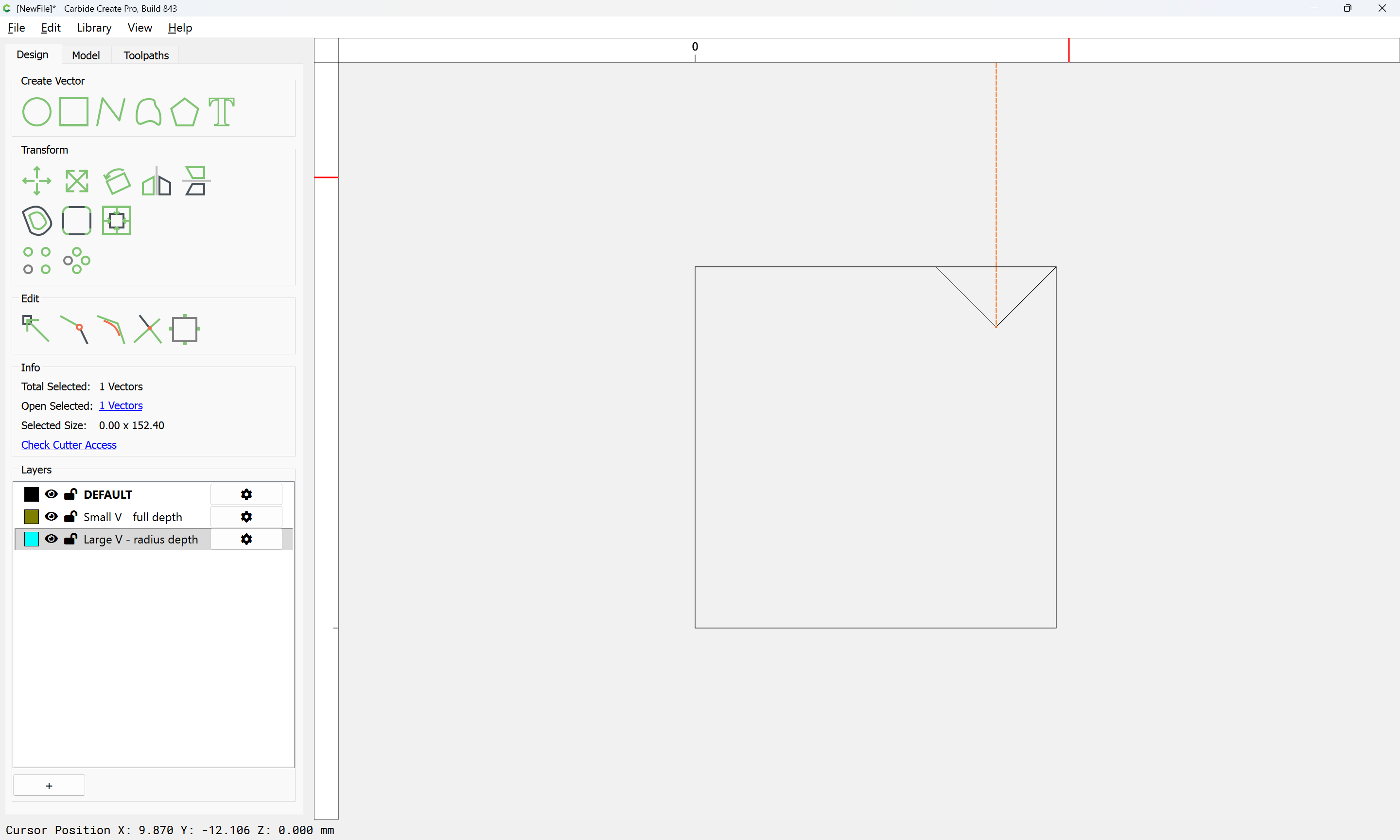

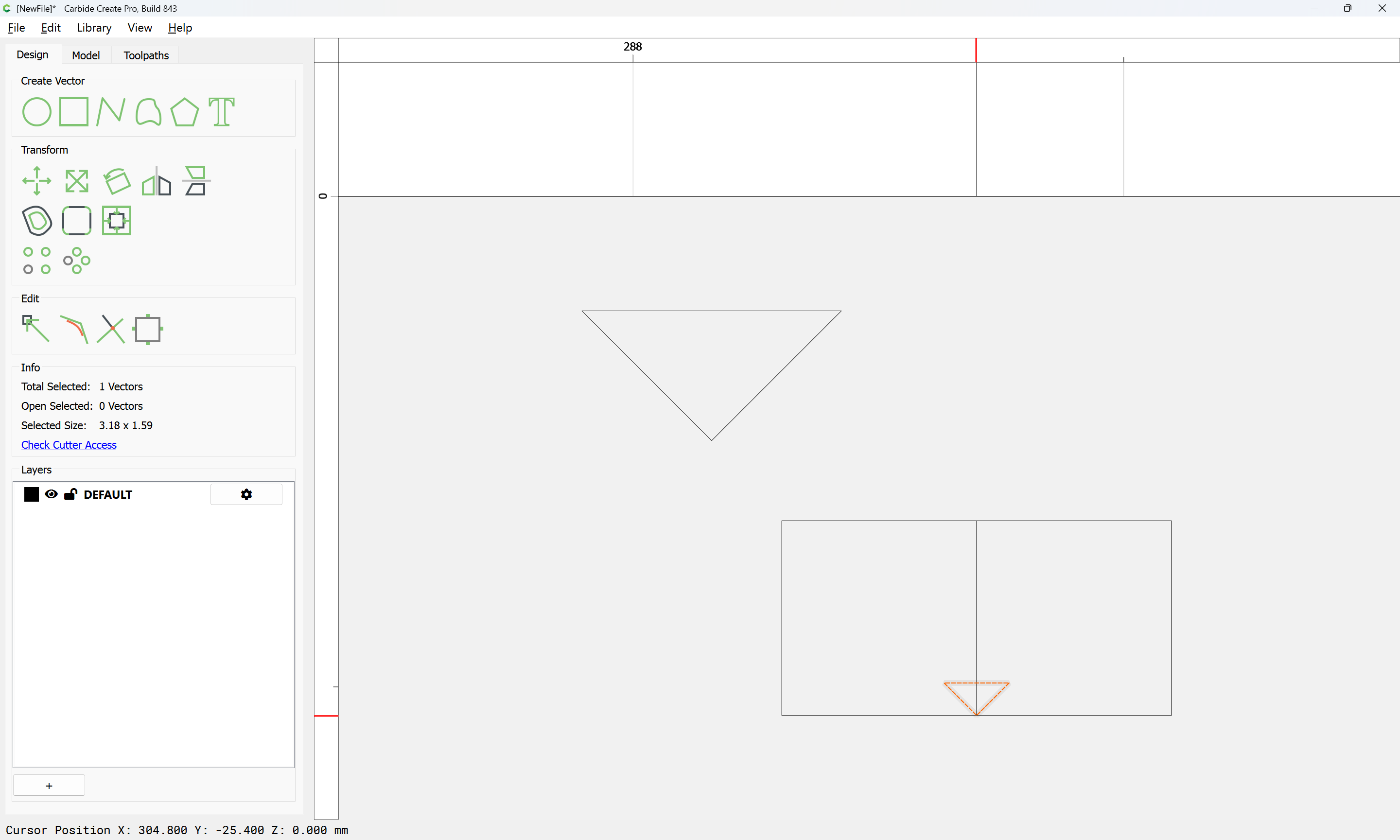

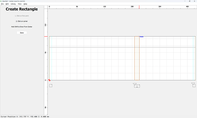

There will need to be a matching cut at the top of the joint:
which arguably, is better cut with the Large V tool:

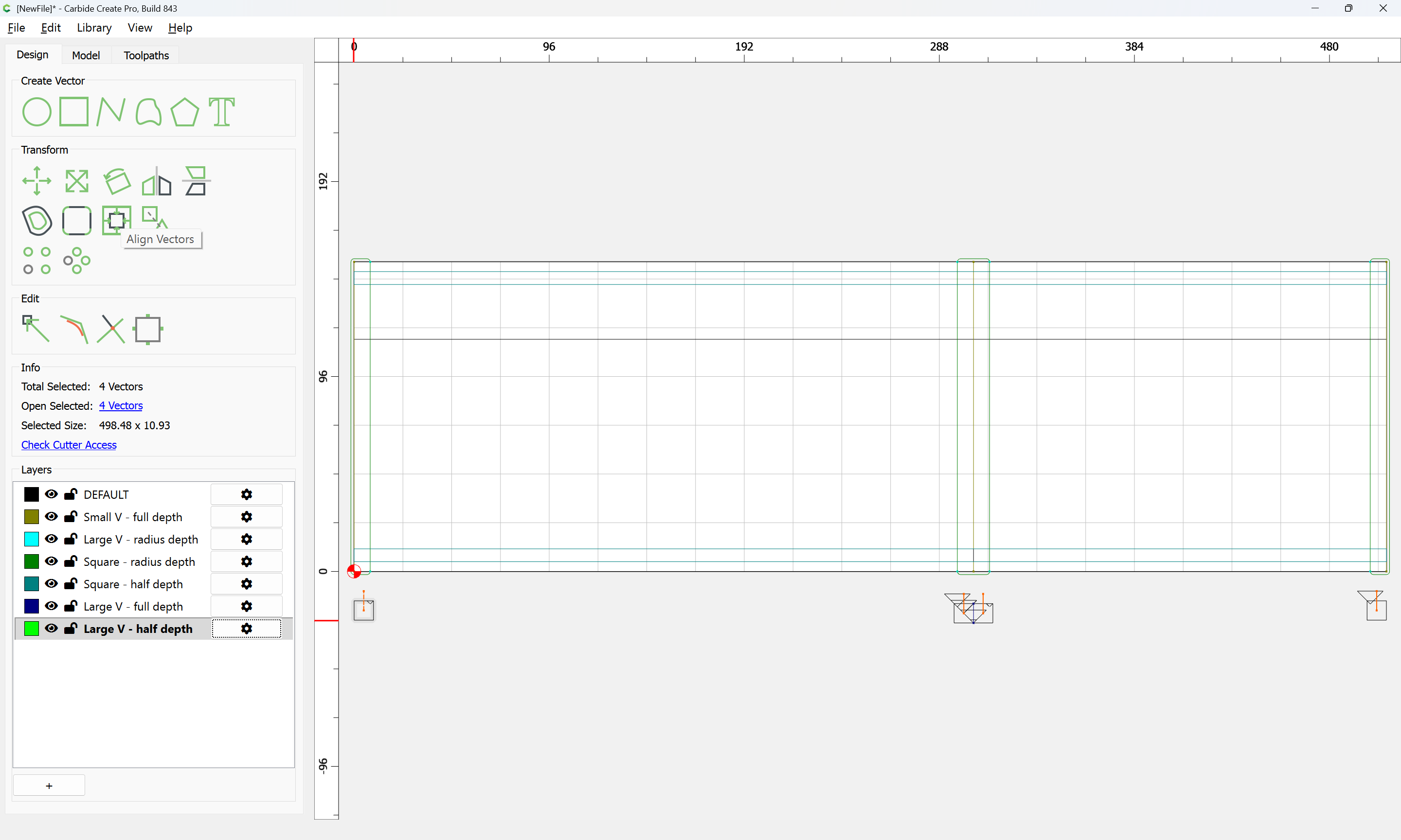

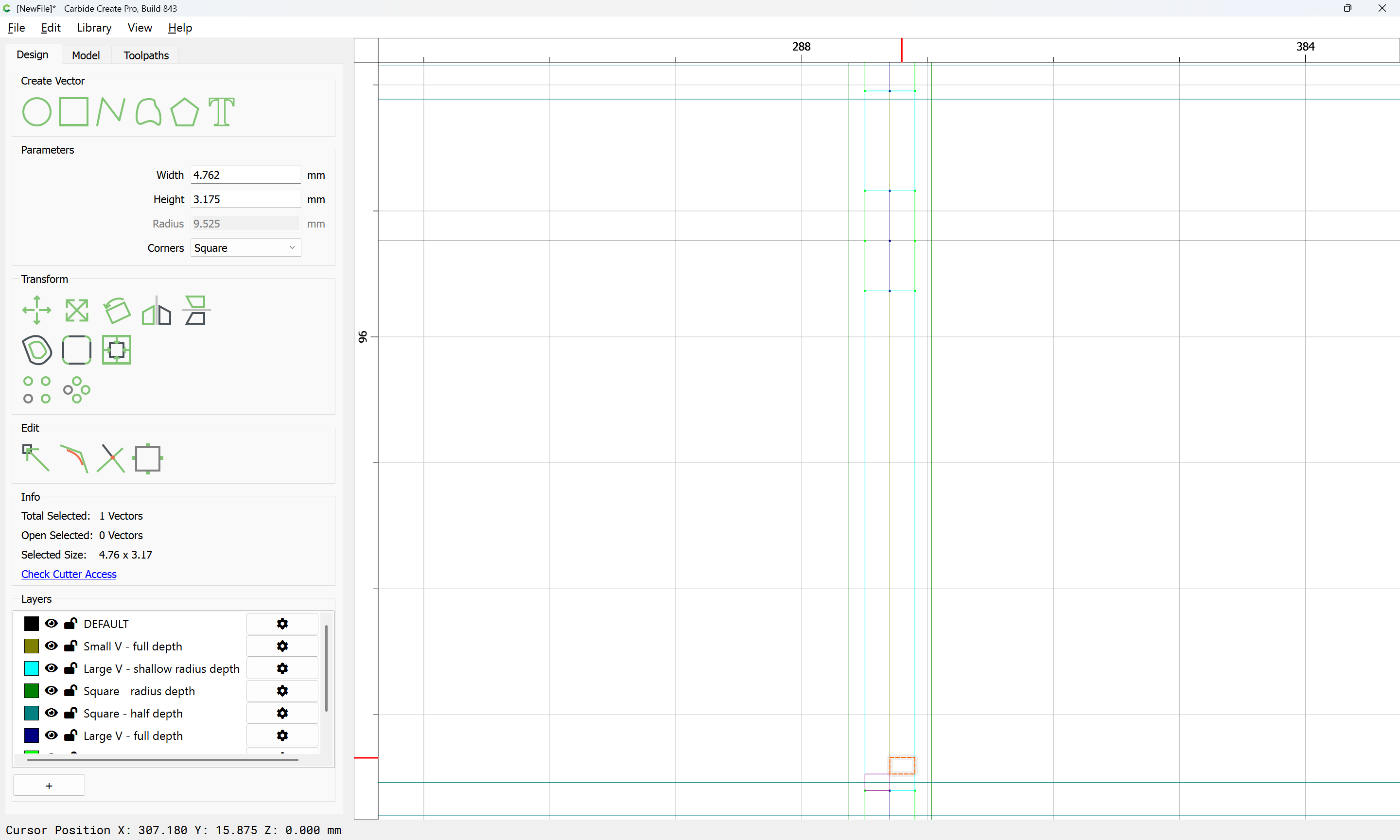

which will want another layer:
and for which we draw a suitable line and position it:
duplicating as need be:
and then aligning with the stock:
OK

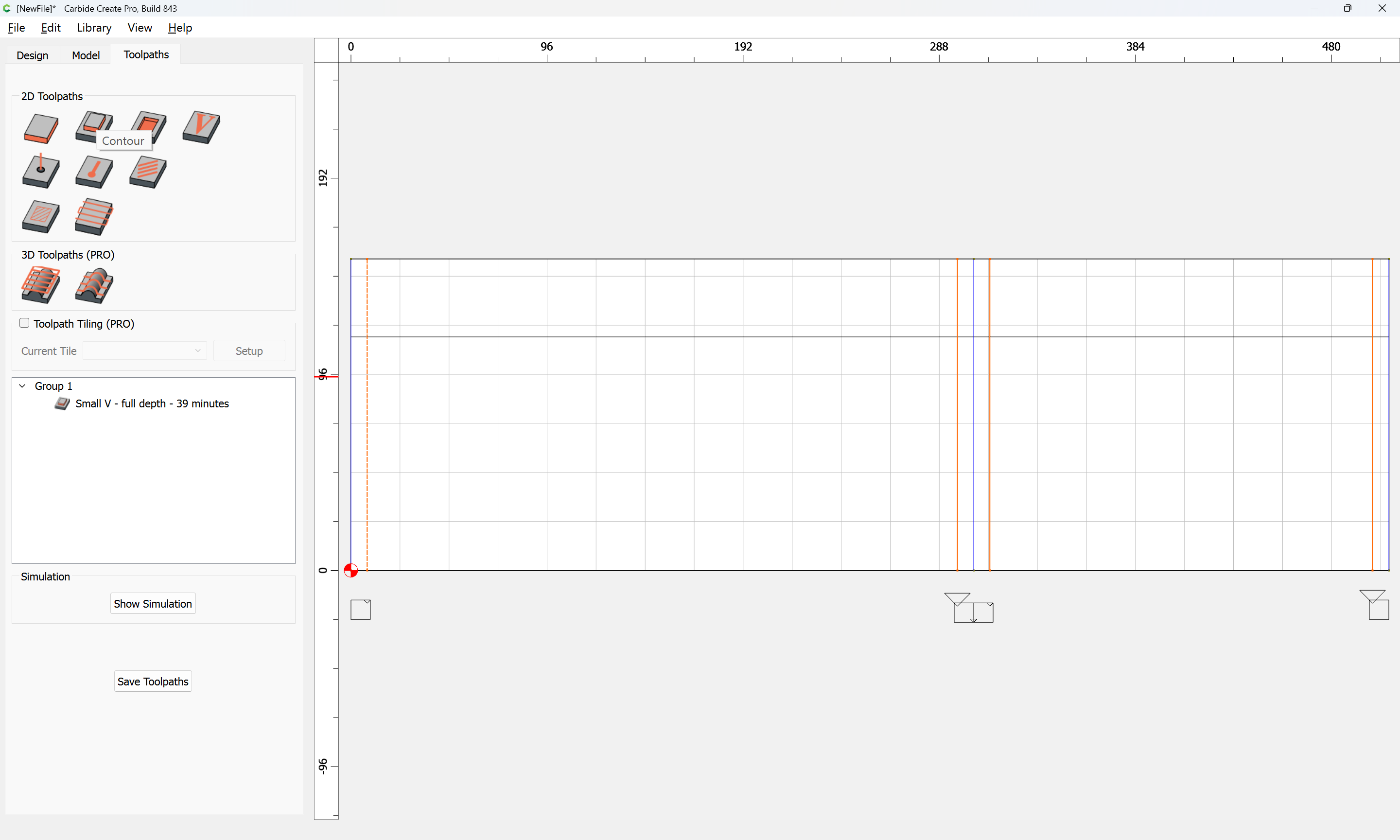

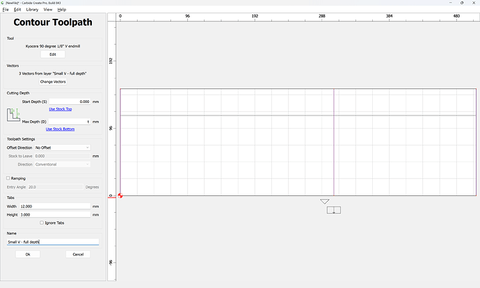

and make a suitable toolpath:

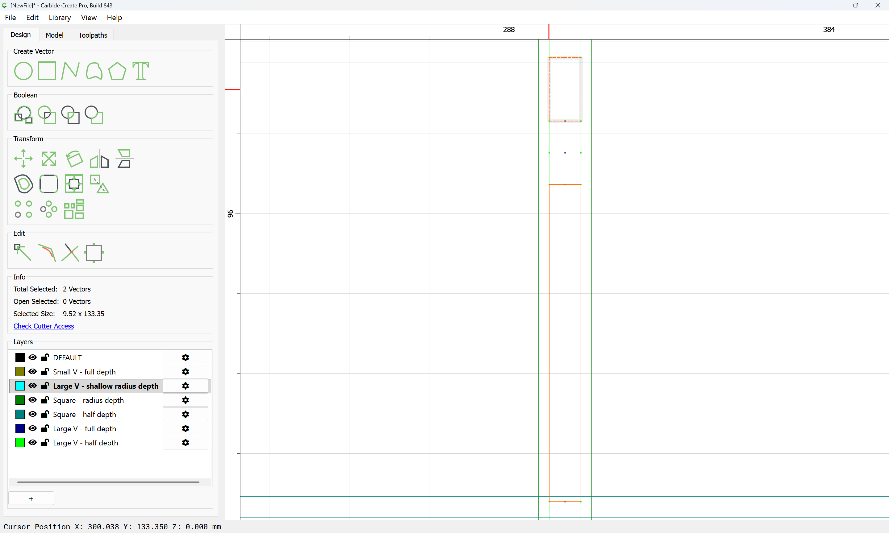

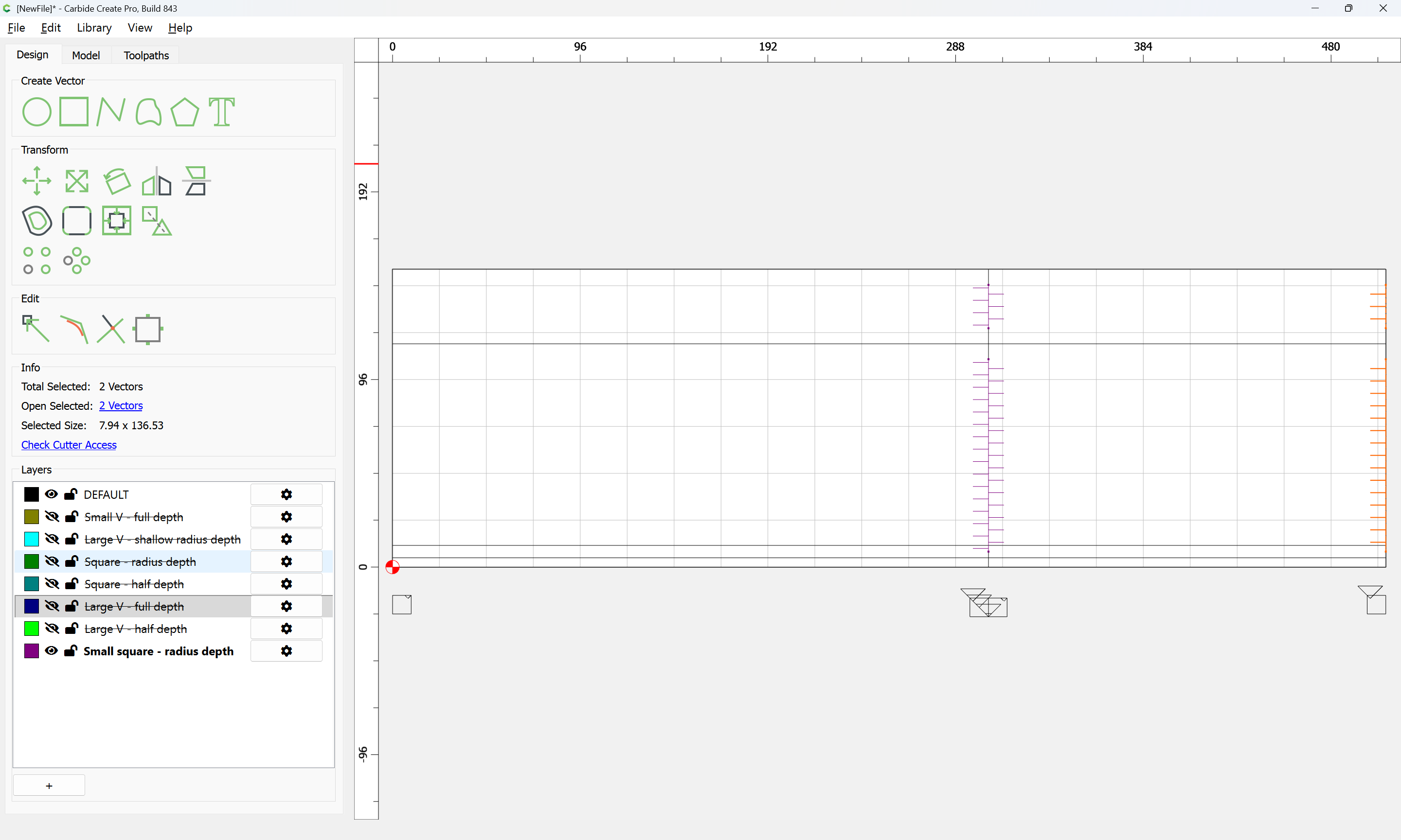

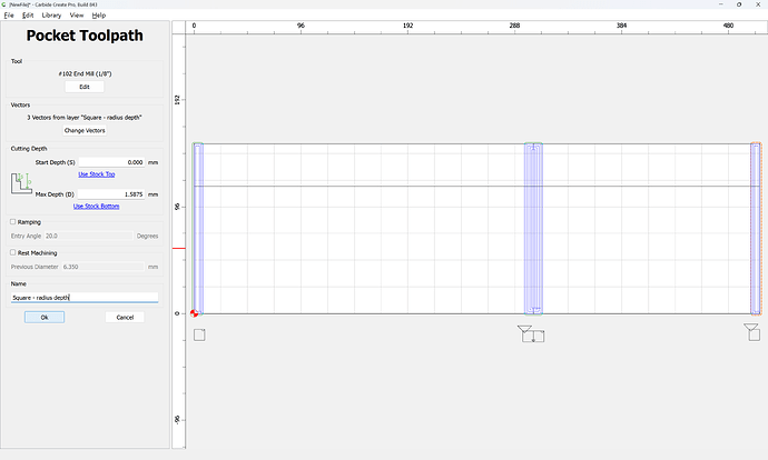

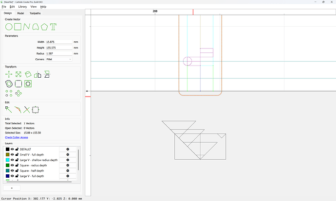

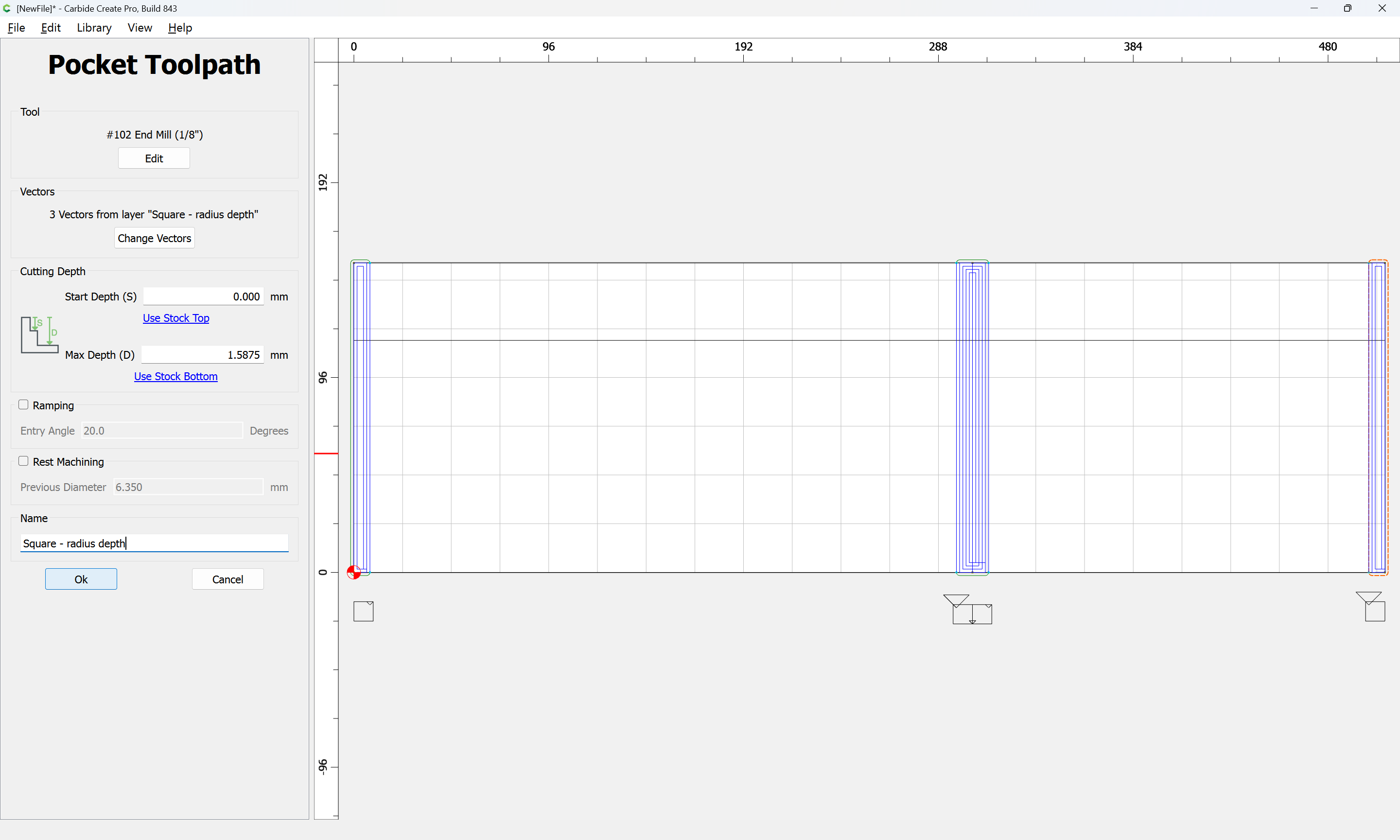

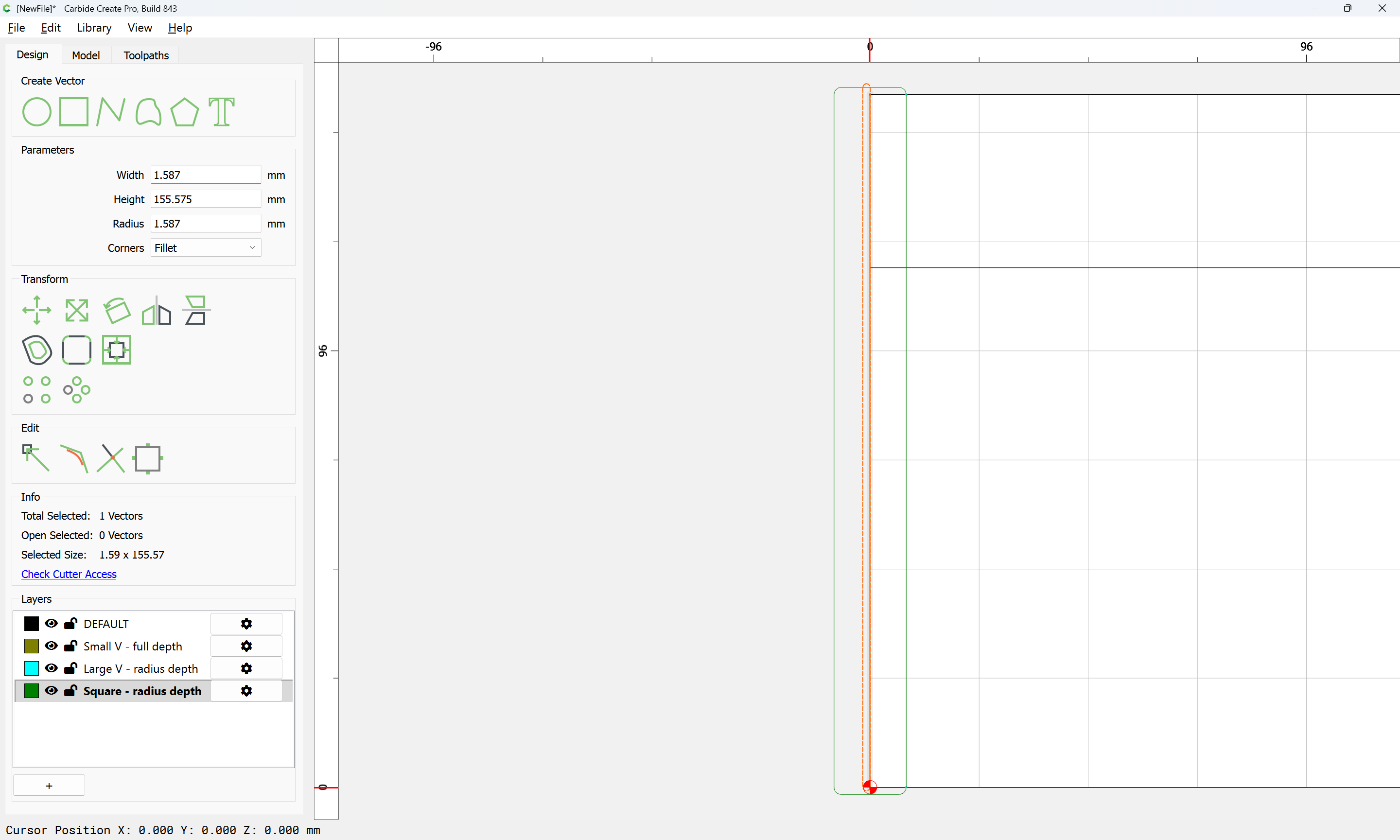

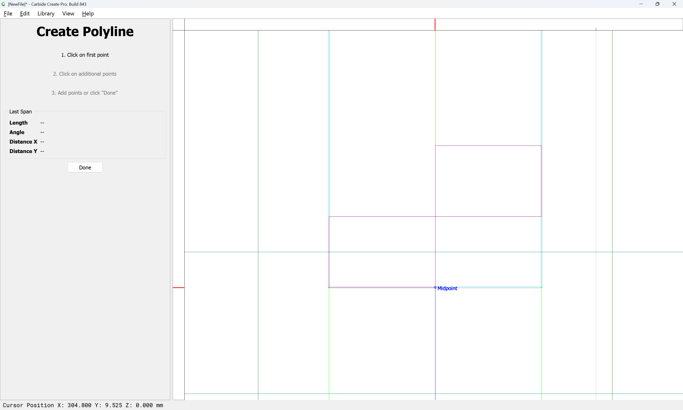

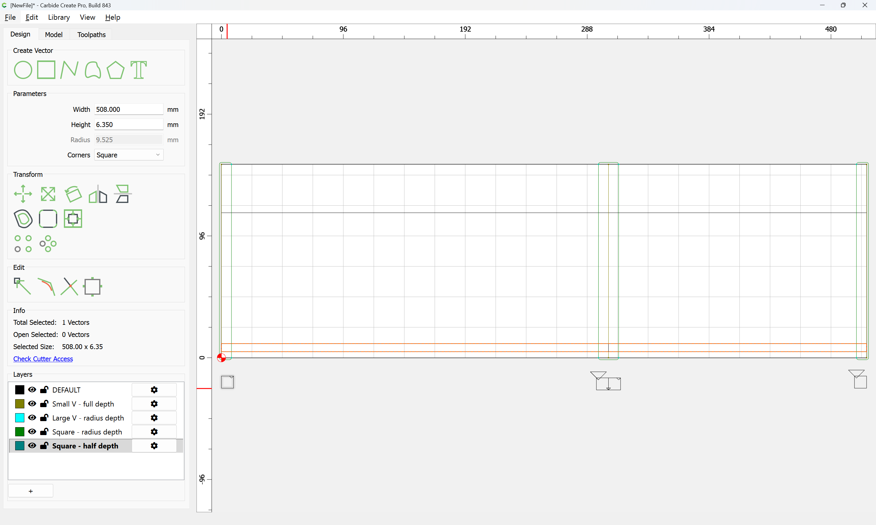

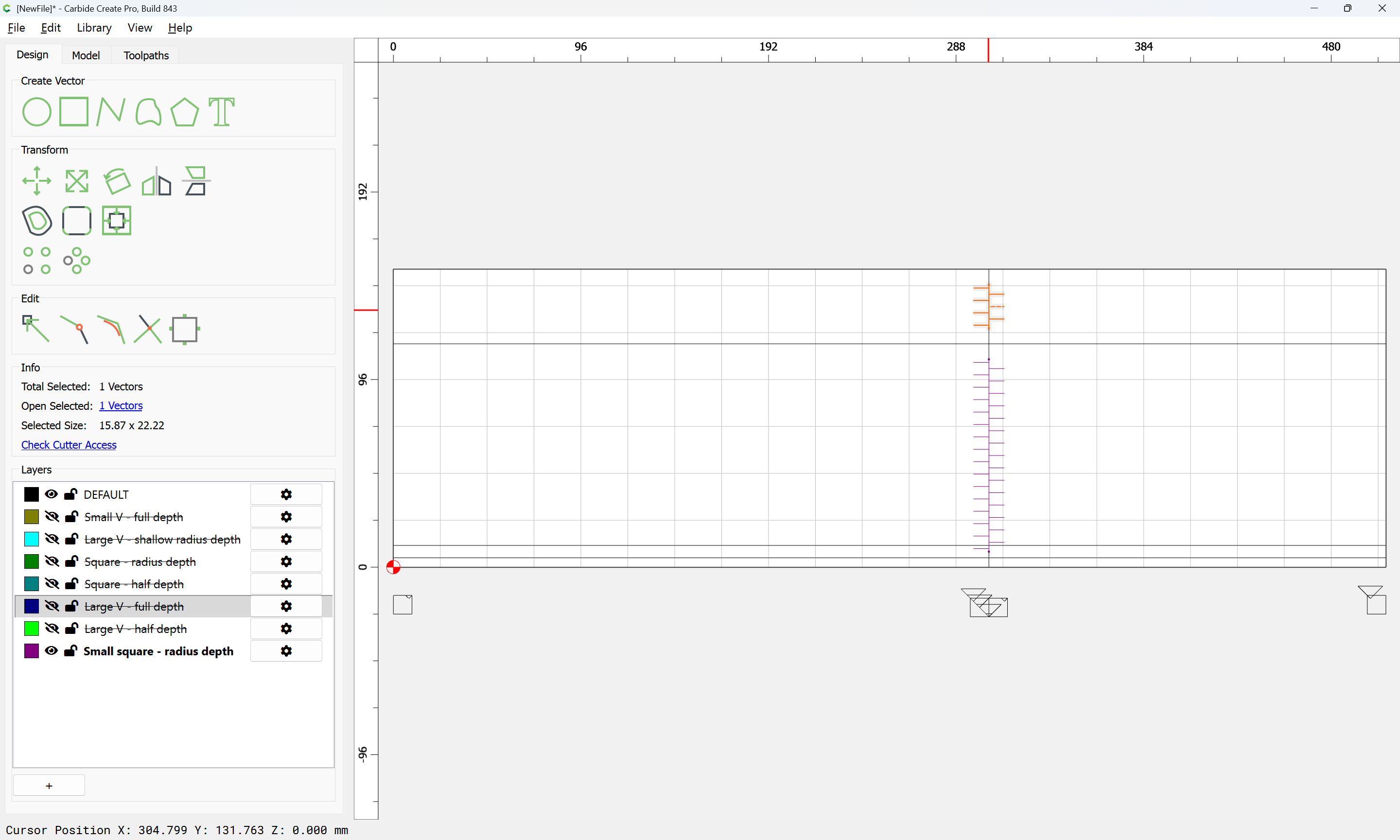

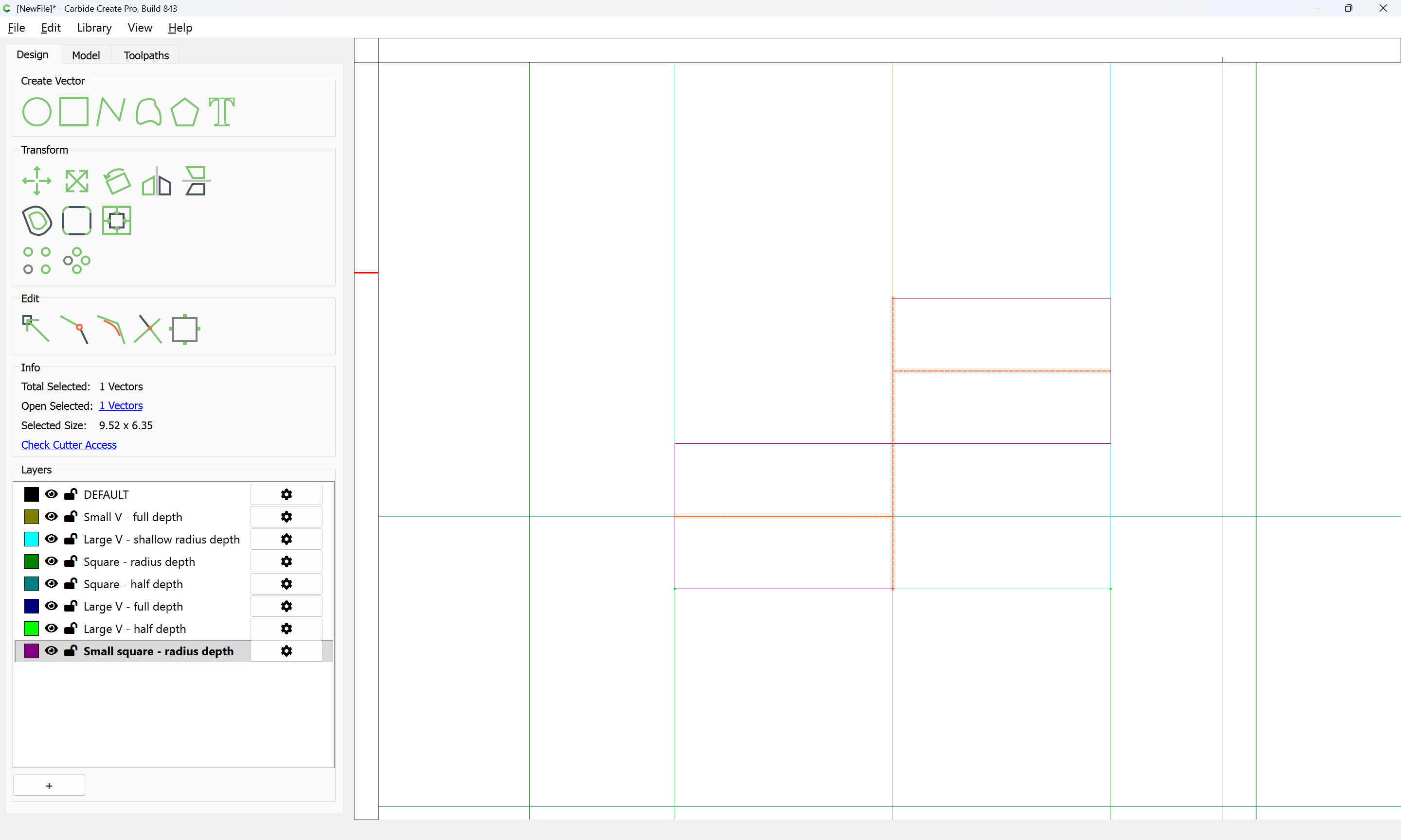

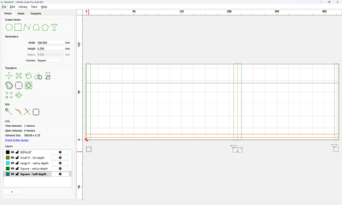

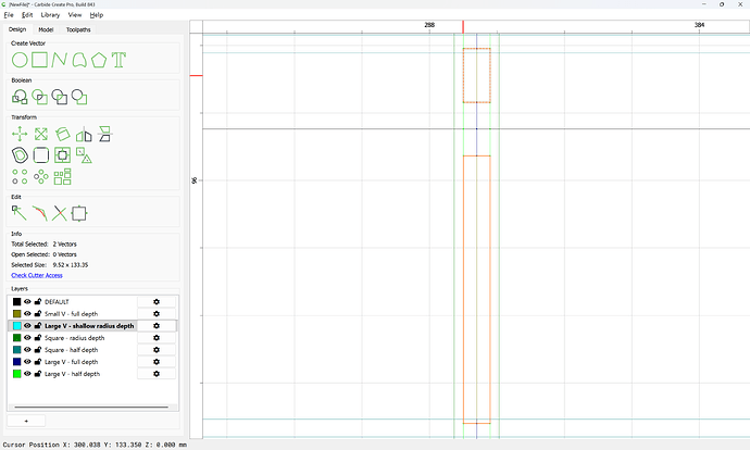

The area above the joints will also need to be cleared w/ a suitable square tool:
which will require another layer:
Increasing the height by the diameter of the tool to be used:
and then setting that radius:
affords a handle for moving this in register:
Note that these regions when cutting only one side of a joint may be trimmed down a bit:

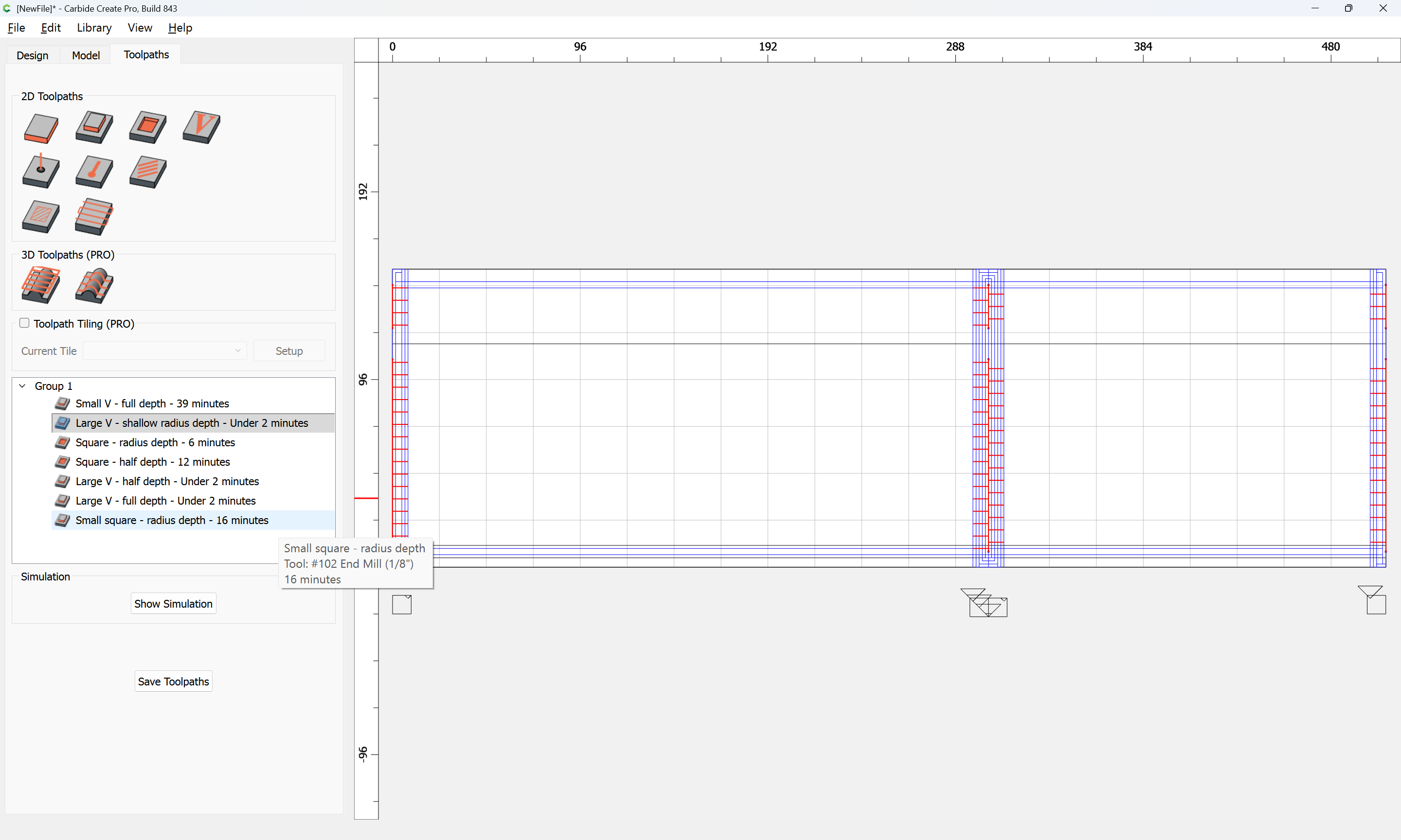

with all being assigned a suitable toolpath:

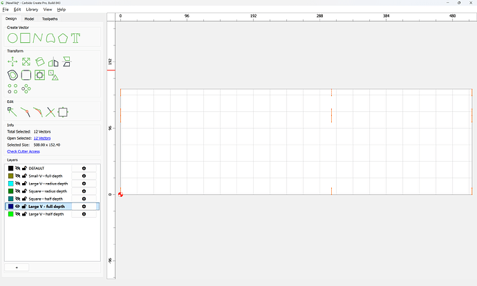

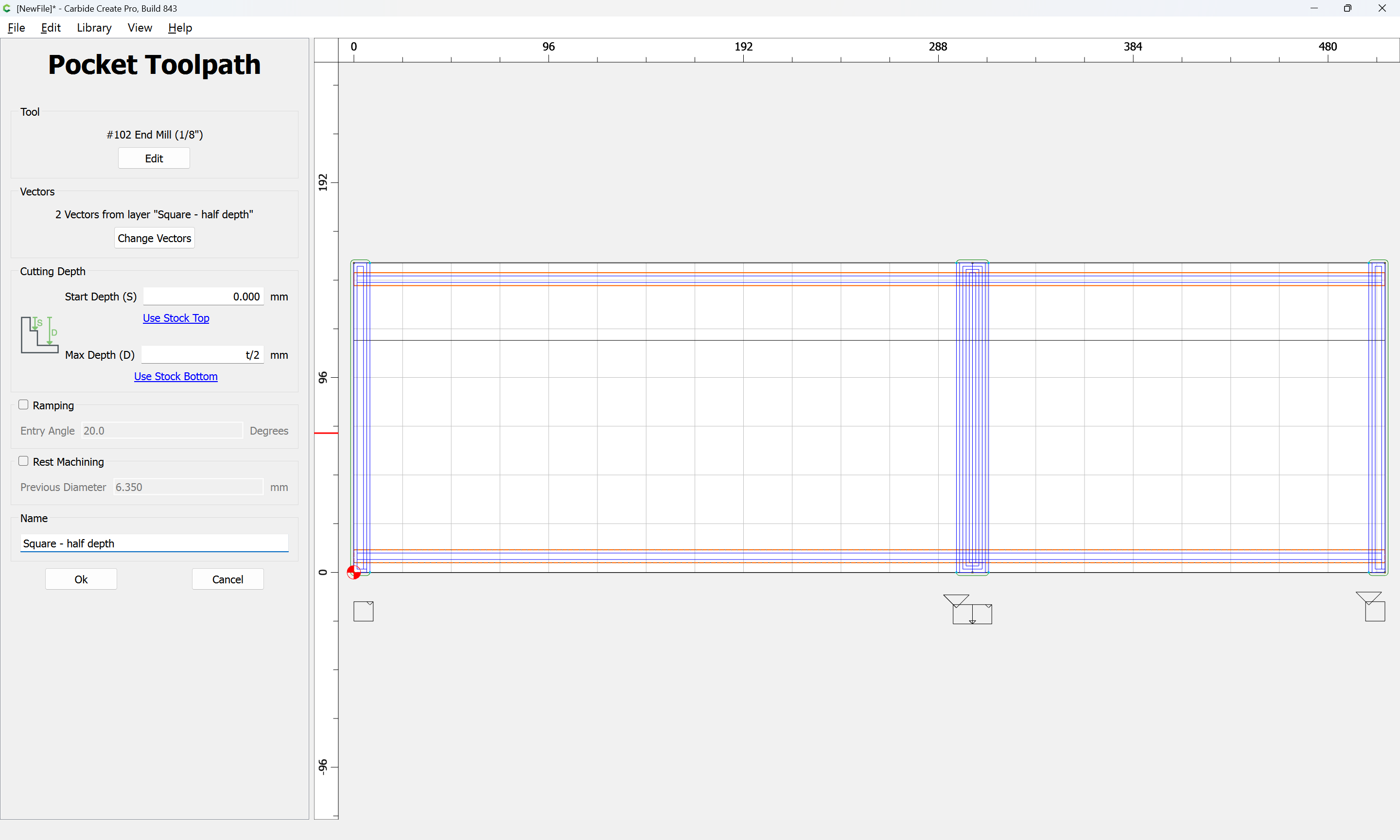

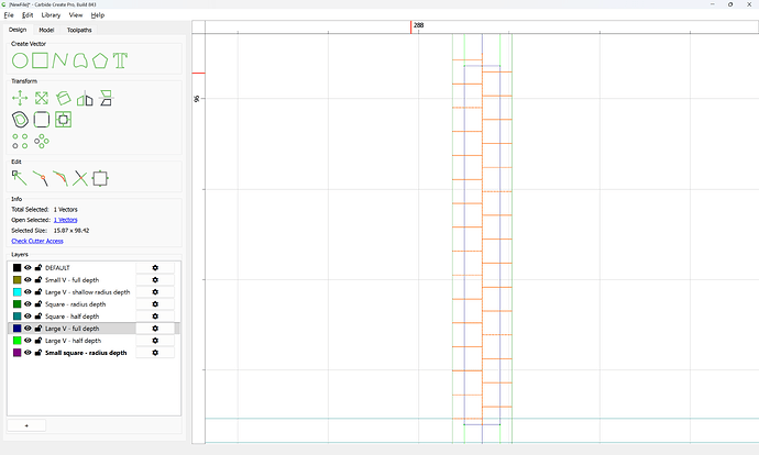

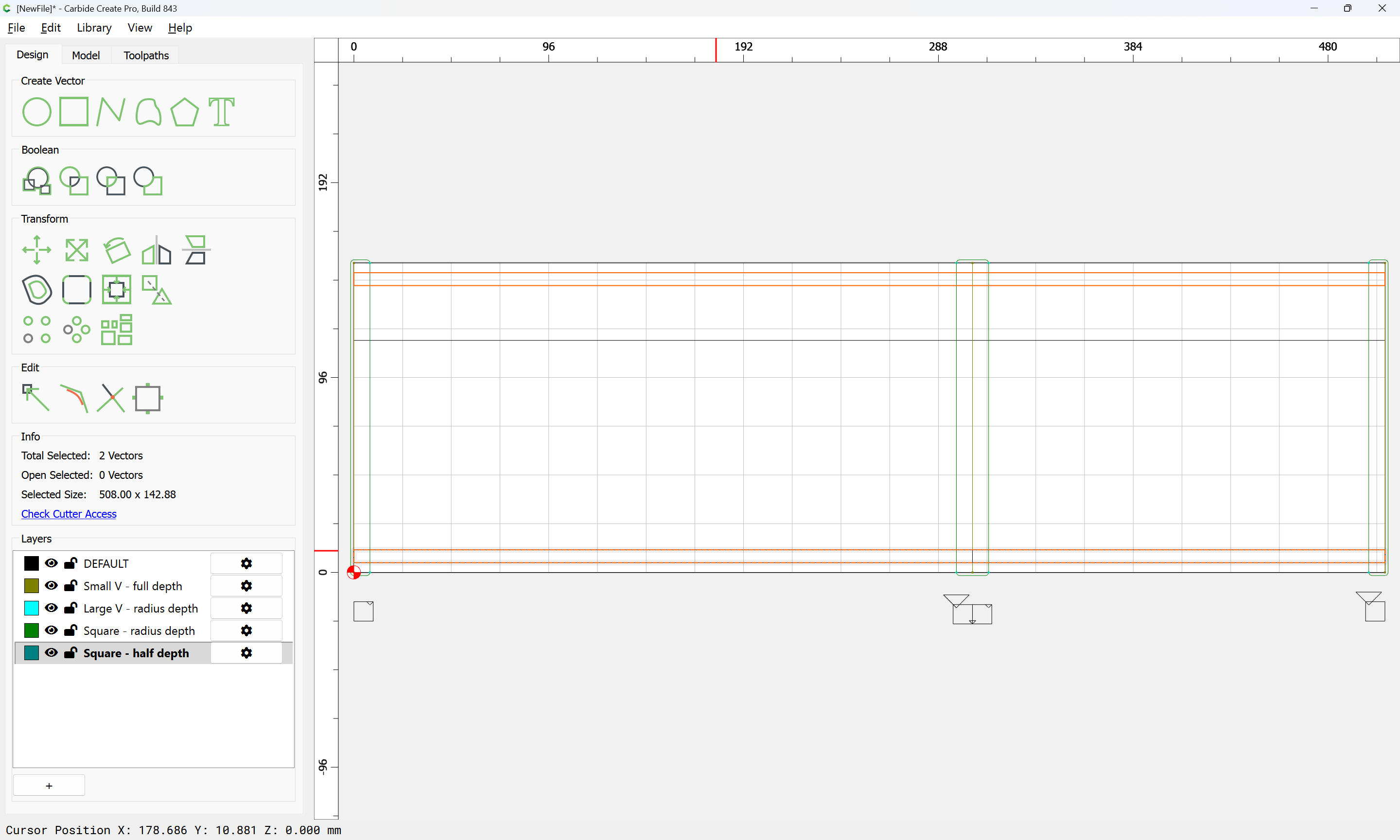

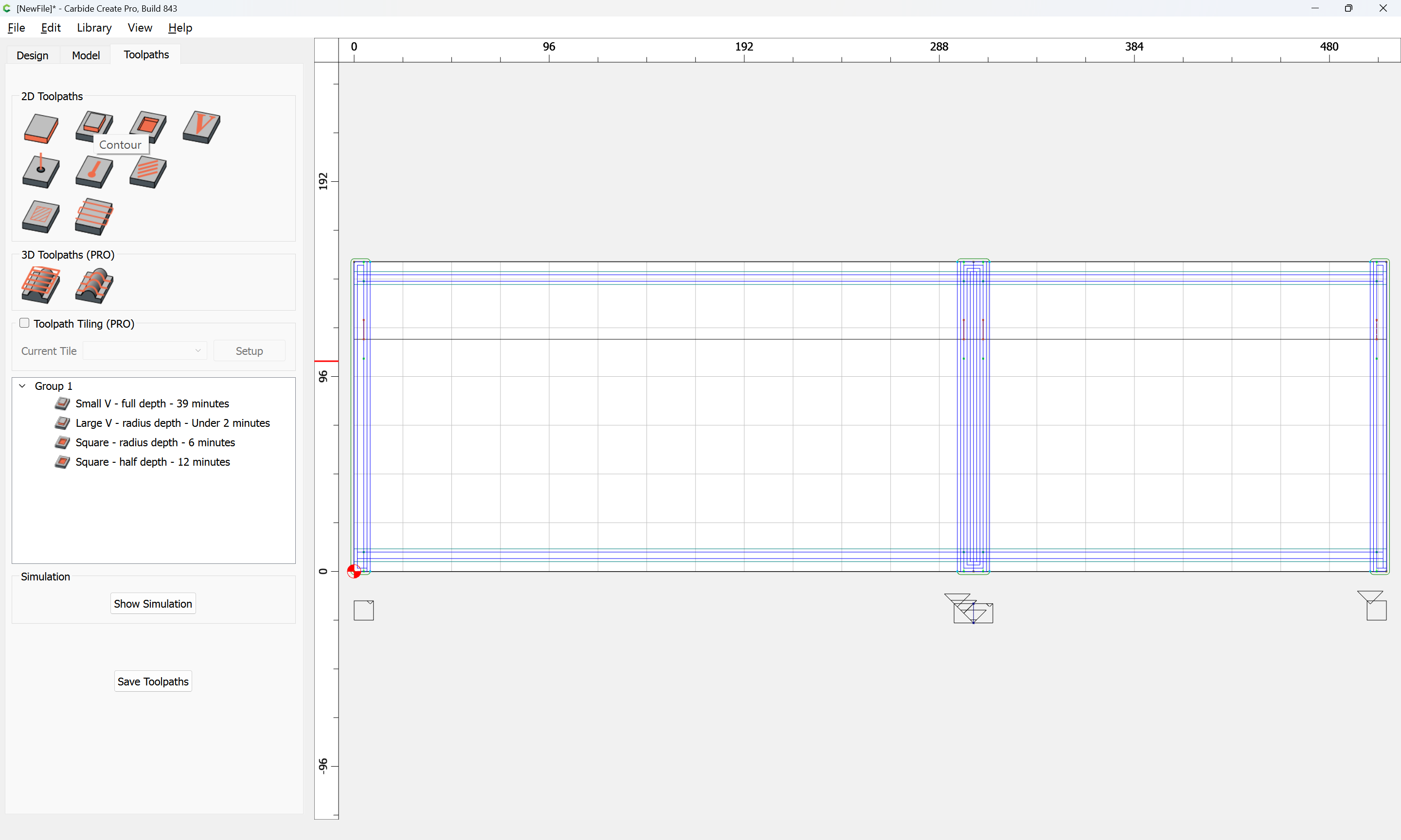

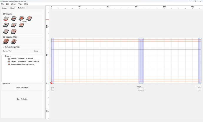

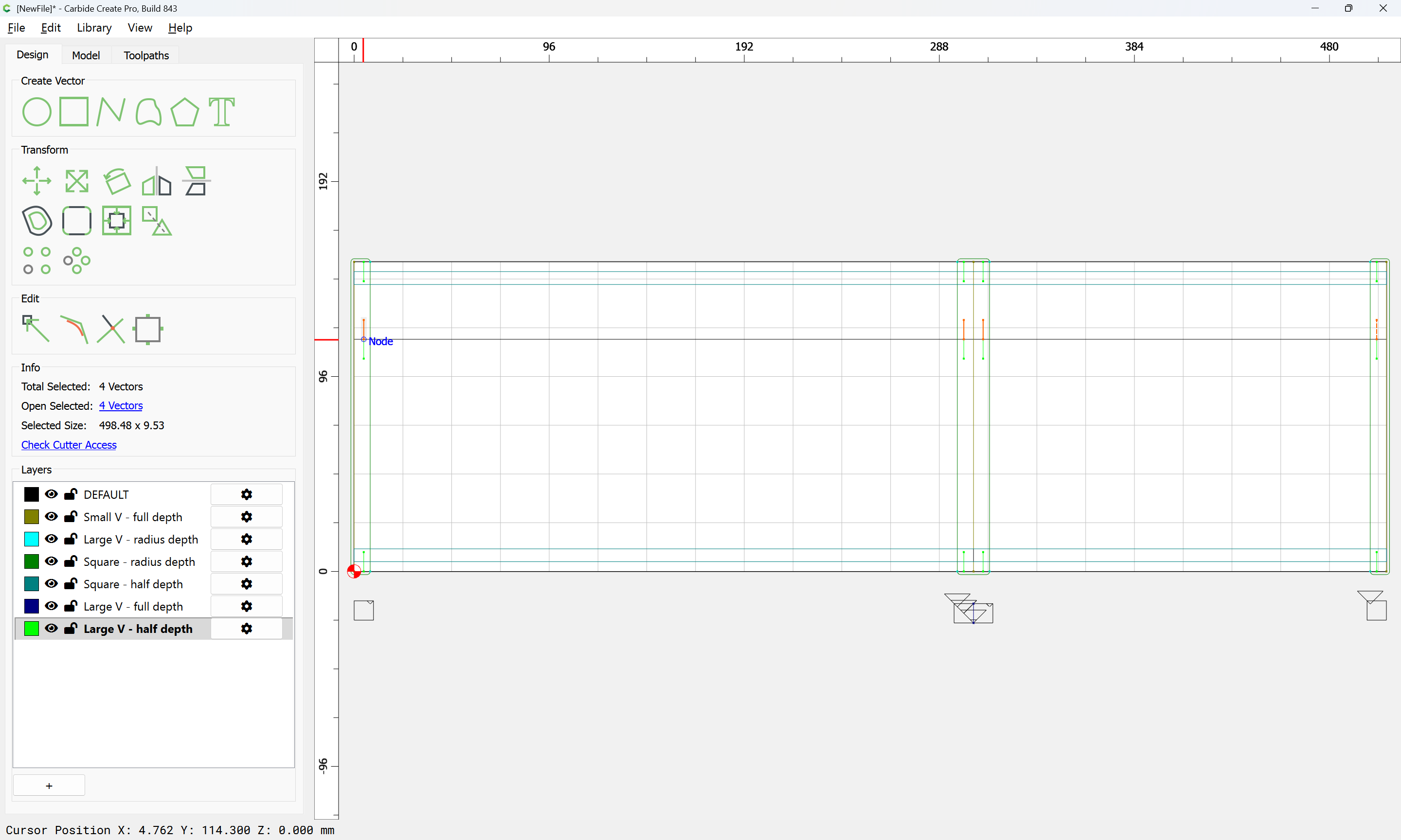

Also using a square tool will be the grooves for the top/bottom:

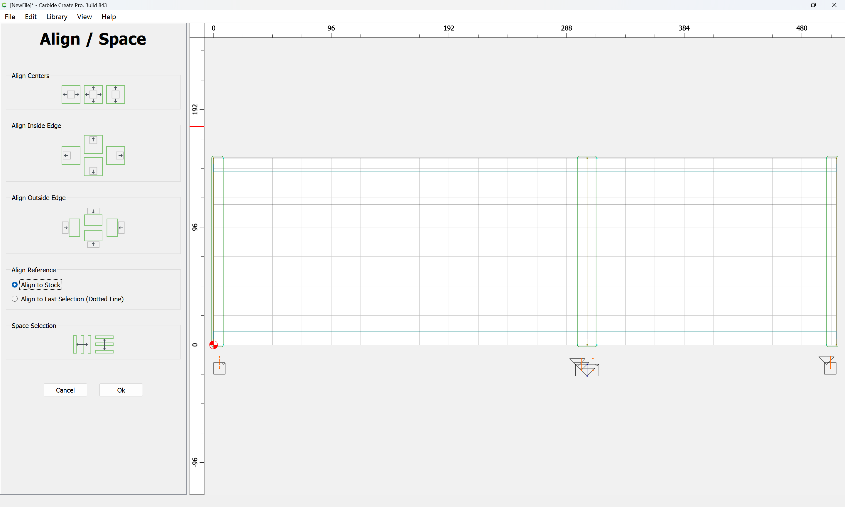

The balance of the toolpaths will be for the joinery, or, just in case the stock is not the exact height of the box, cutting the top/bottom of the stock free…

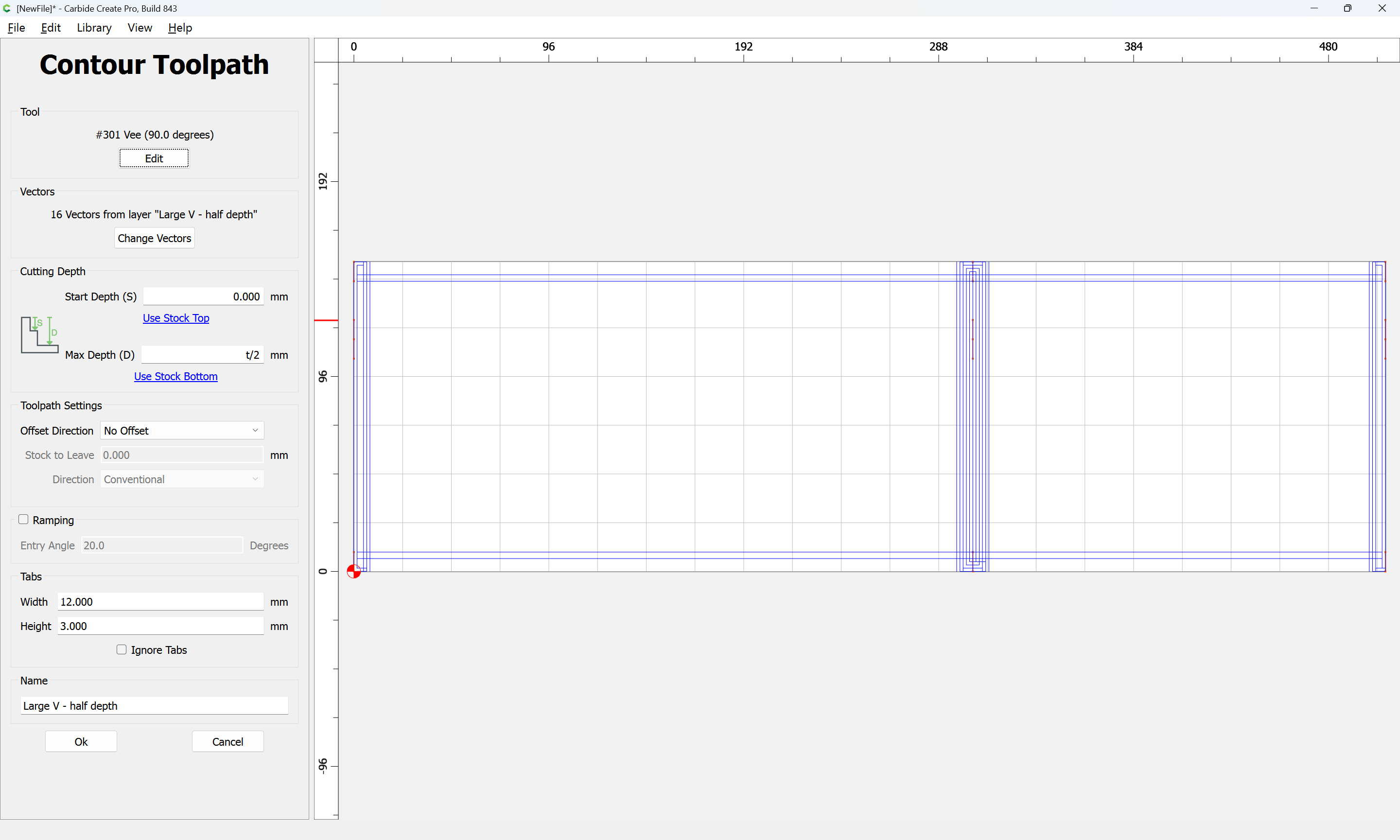

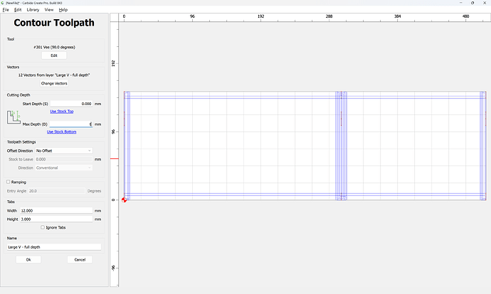

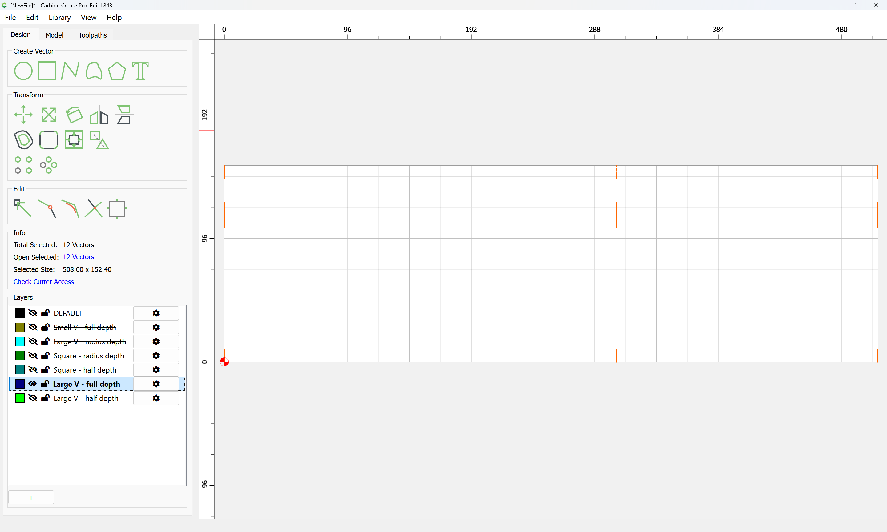

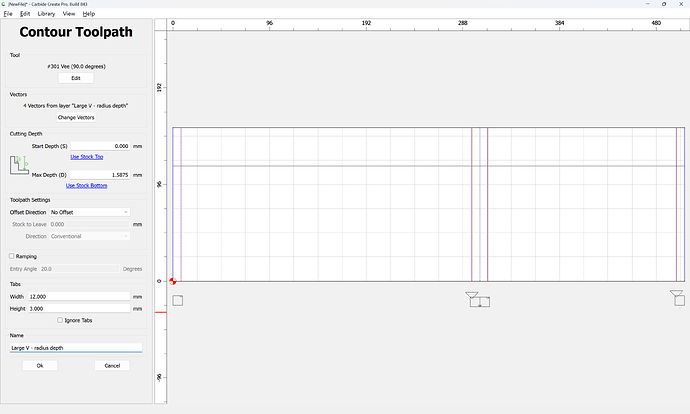

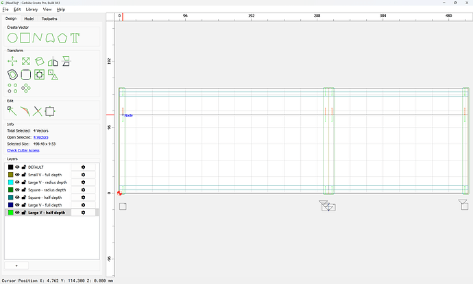

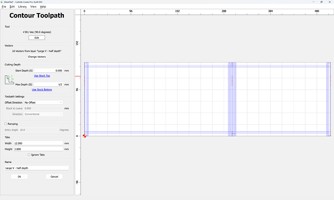

It is simplest to use a large V tool to make the cuts at each end of the joint which make this full-blind:
If the stock is thicker than the large V tool can cut, then a second toolpath will be necessary:

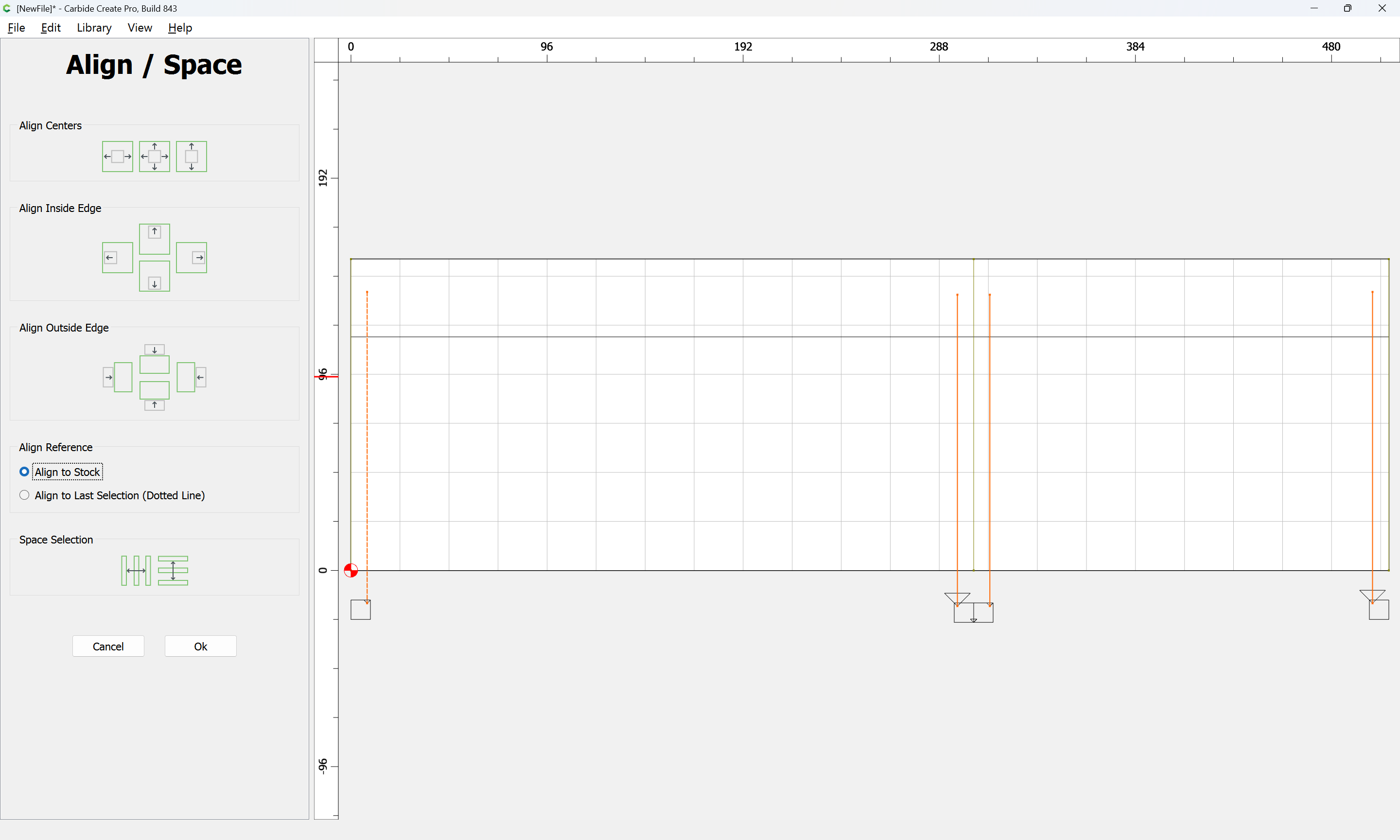

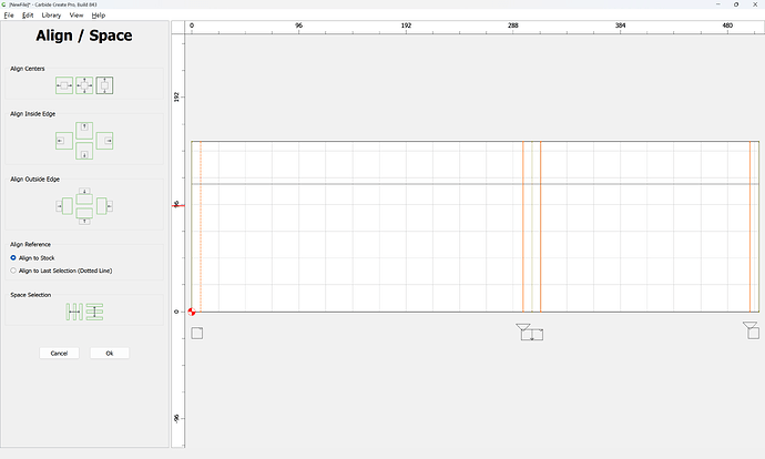

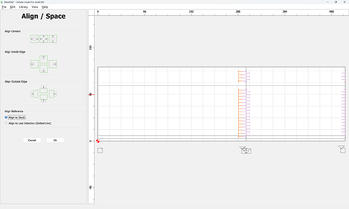

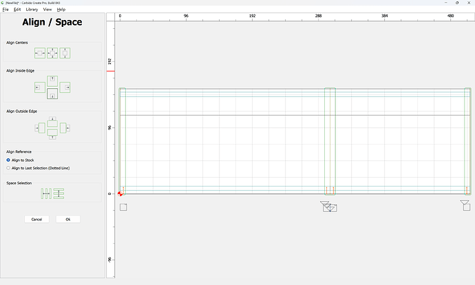

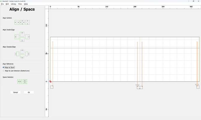

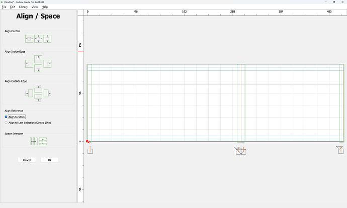

Once all are drawn, then they may be selected:
aligned:
and duplicated and positioned as necessary:

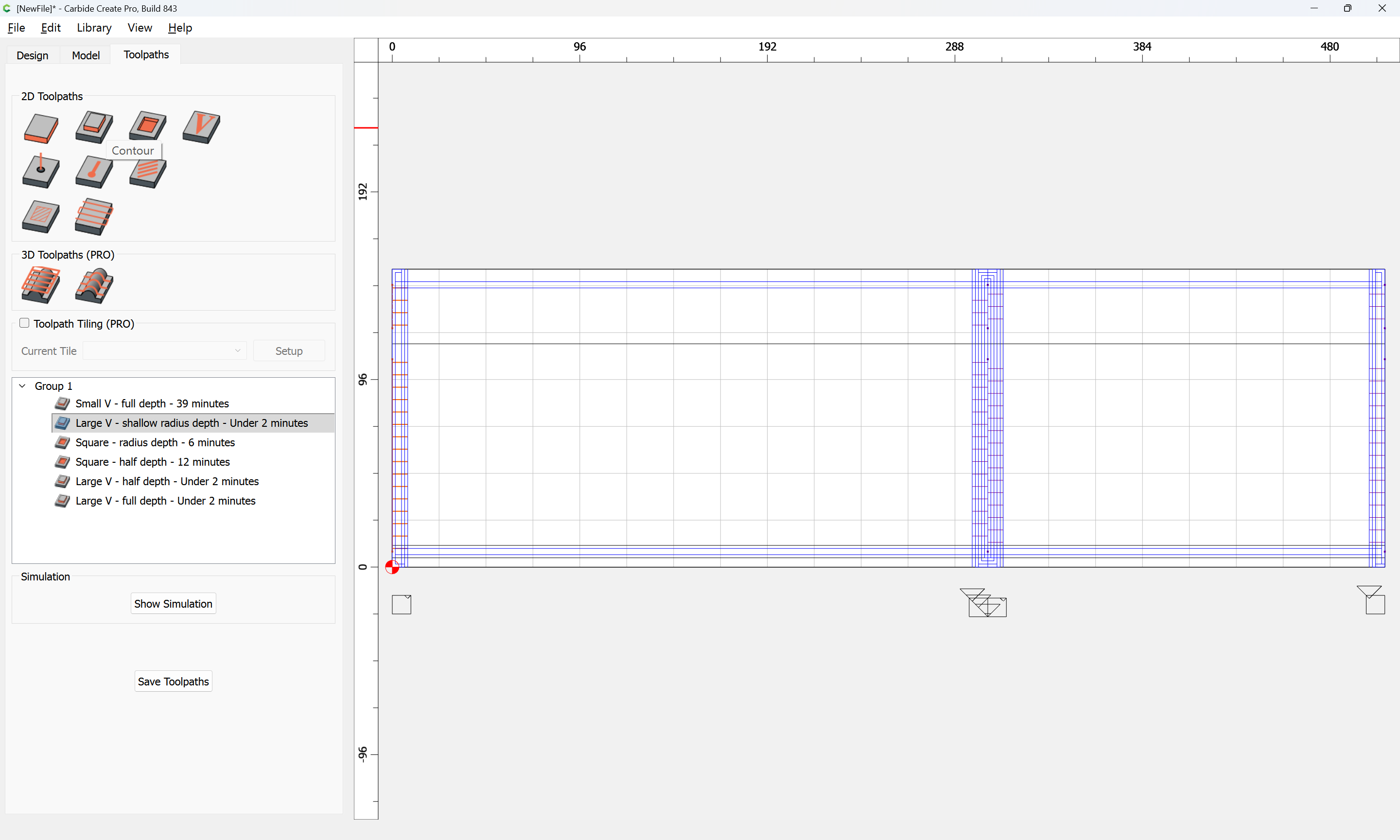

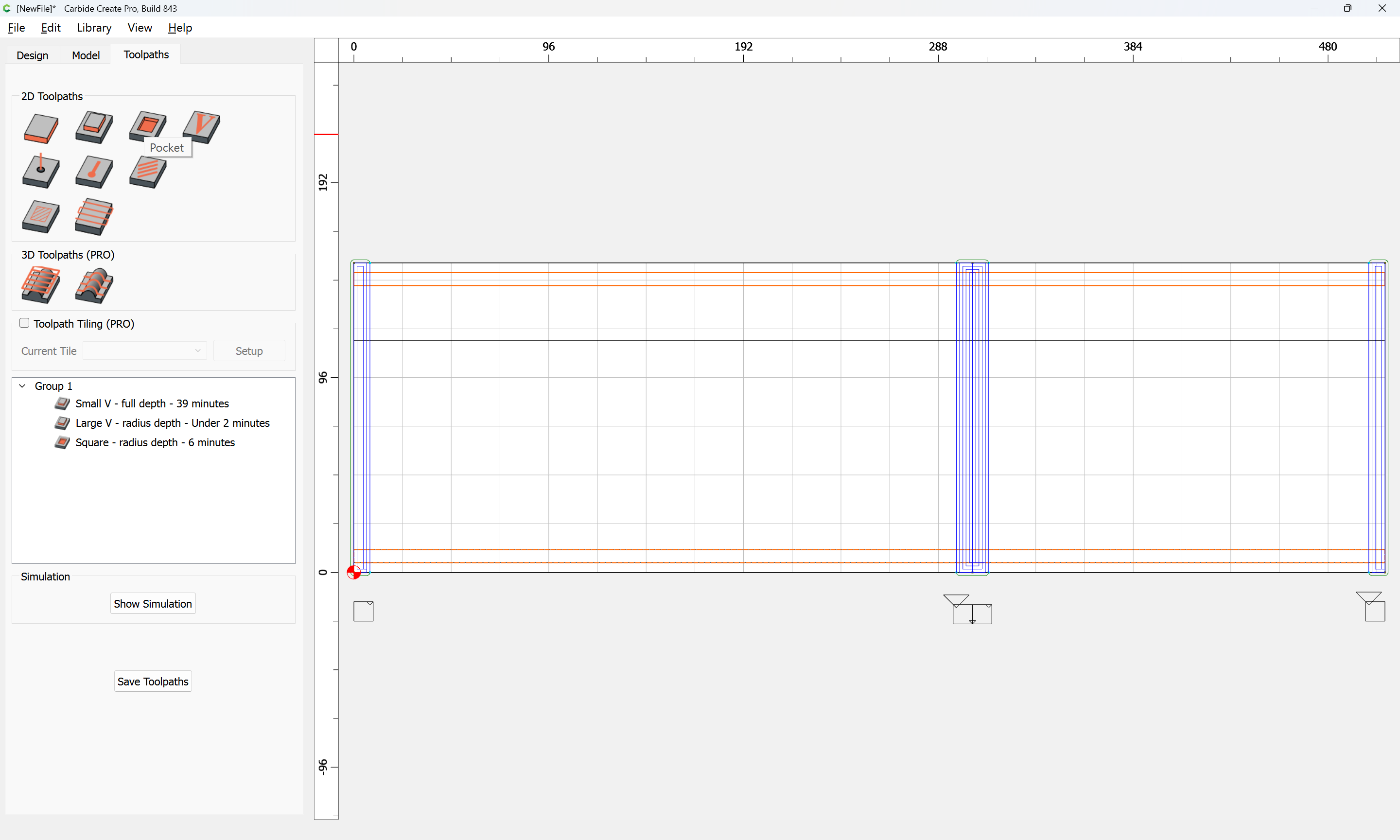

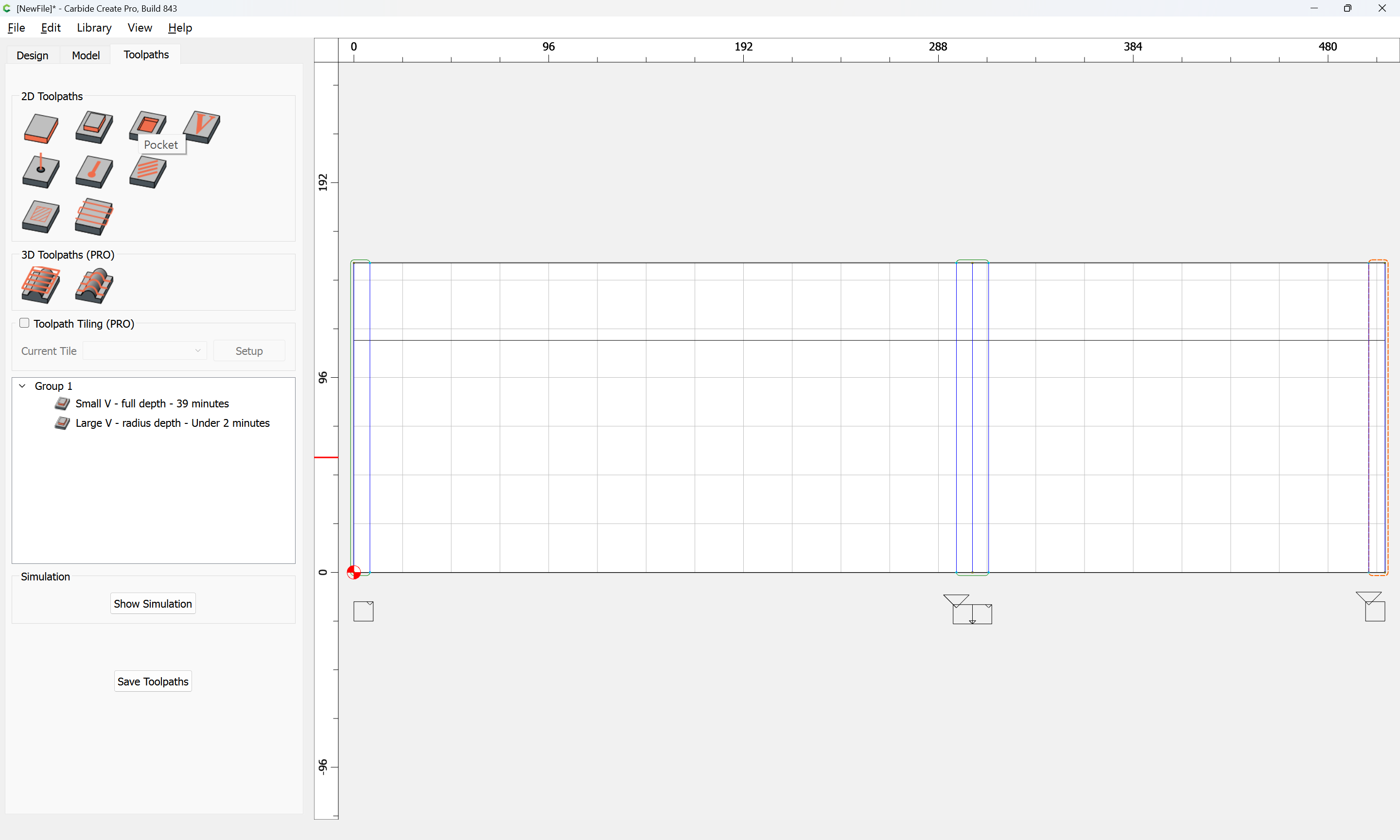

Then toolpaths assigned:
and a matching set of toolpaths made for the full depth cuts with the V tool:

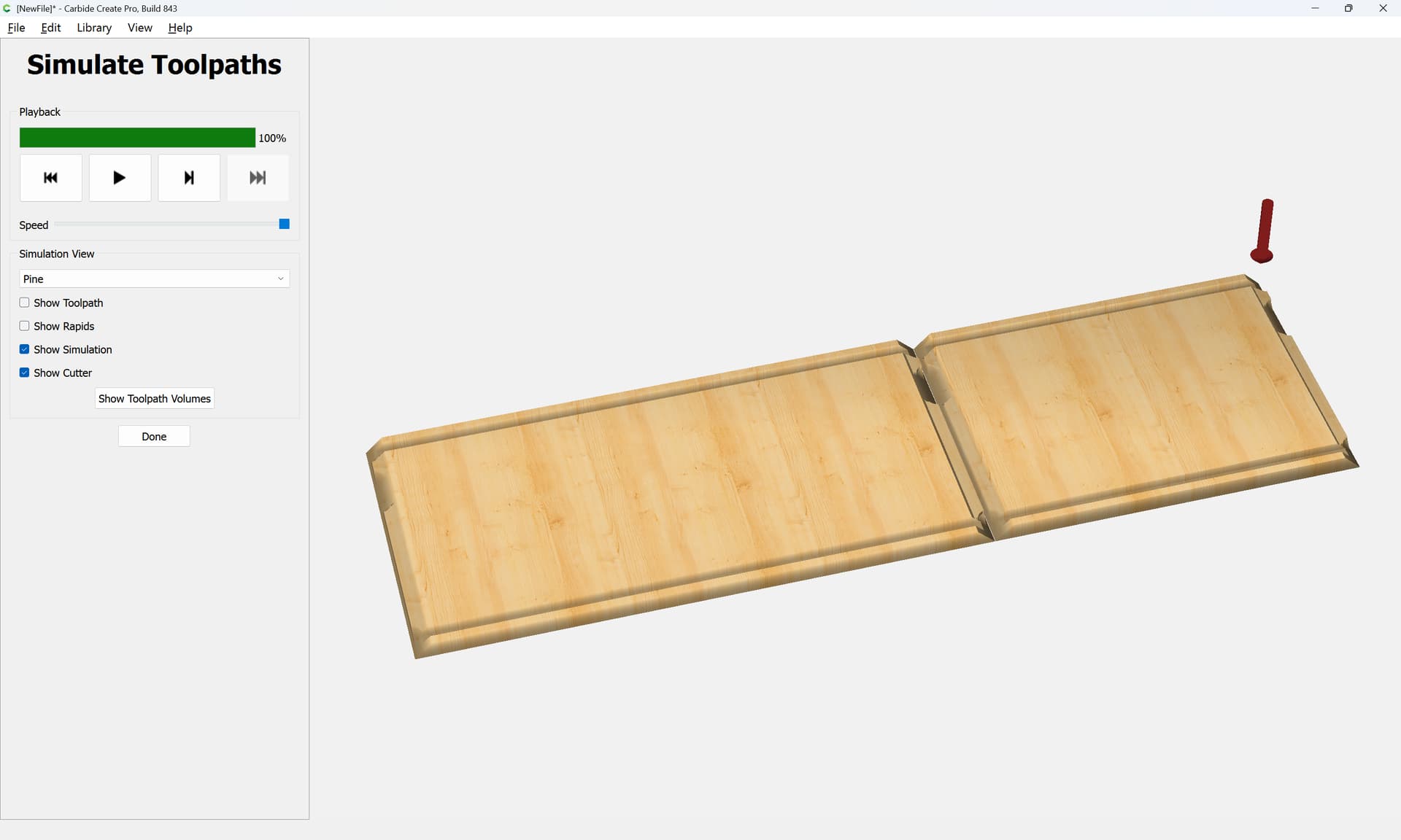

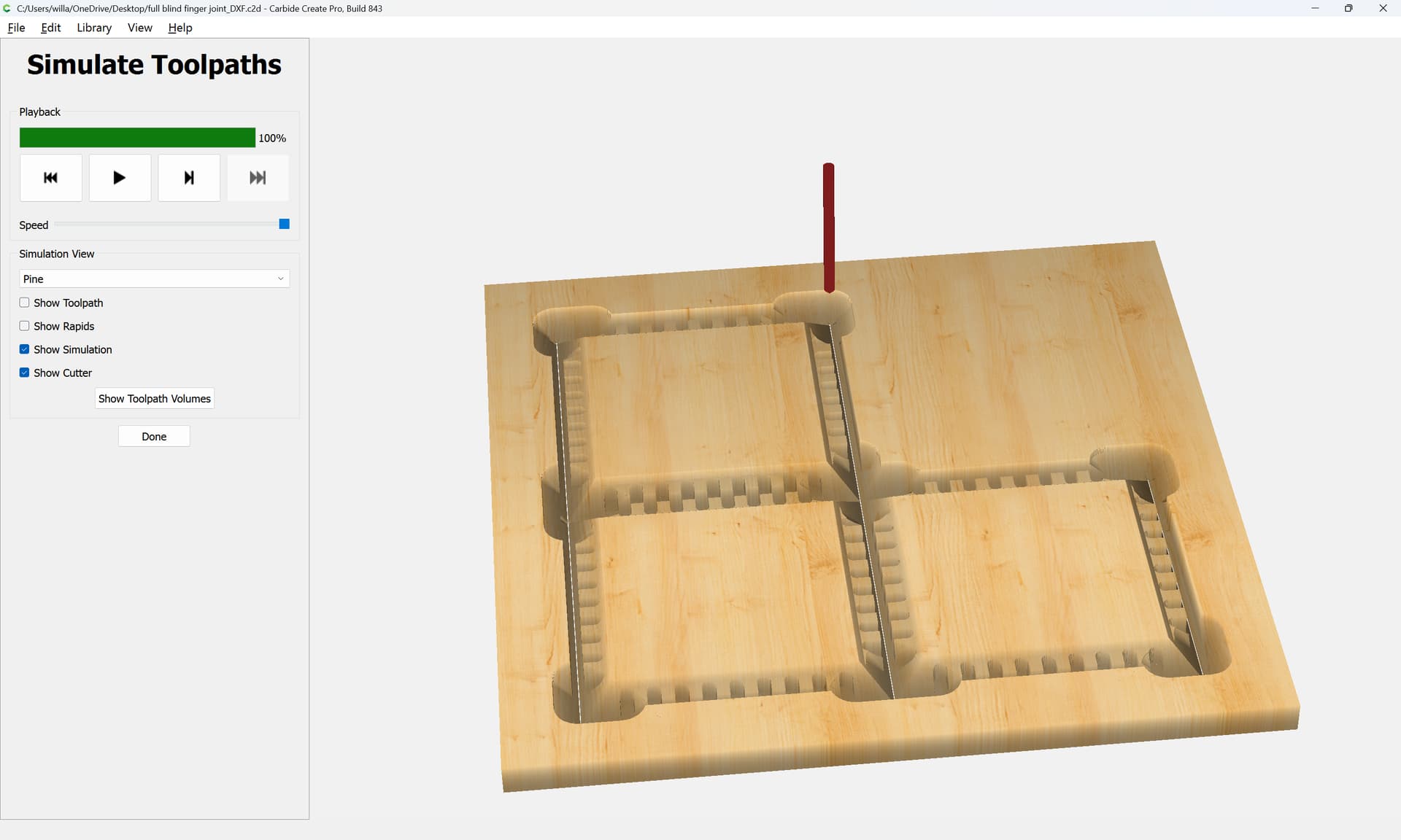

which all previews as:
leaving just cutting the actual joints…

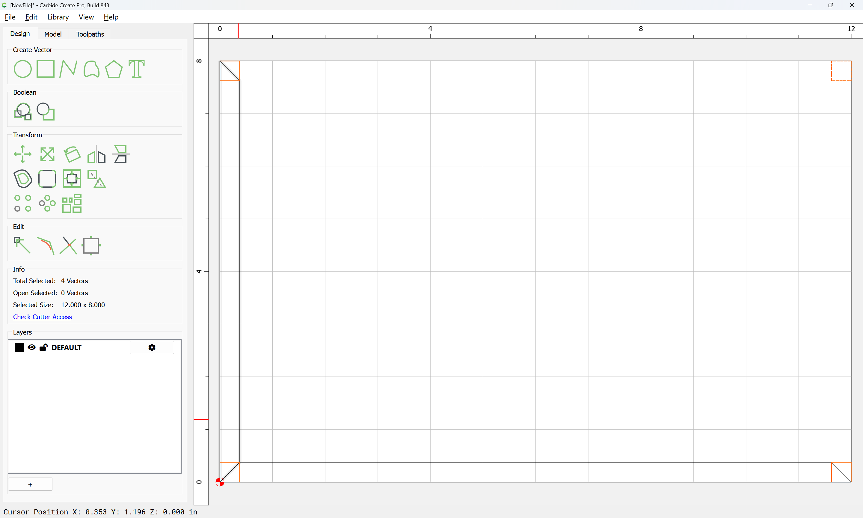

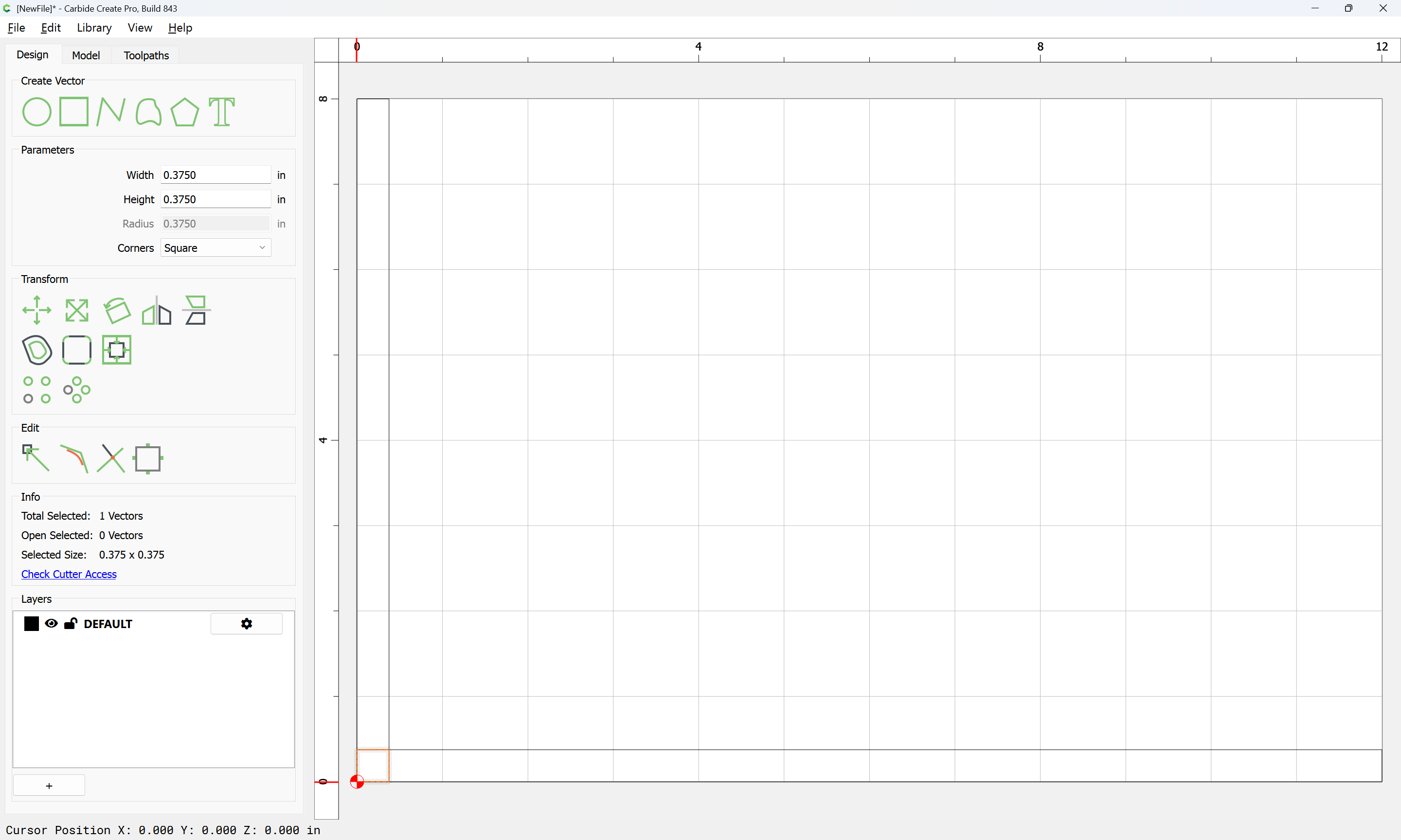

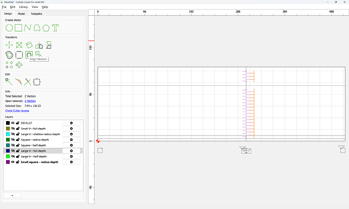

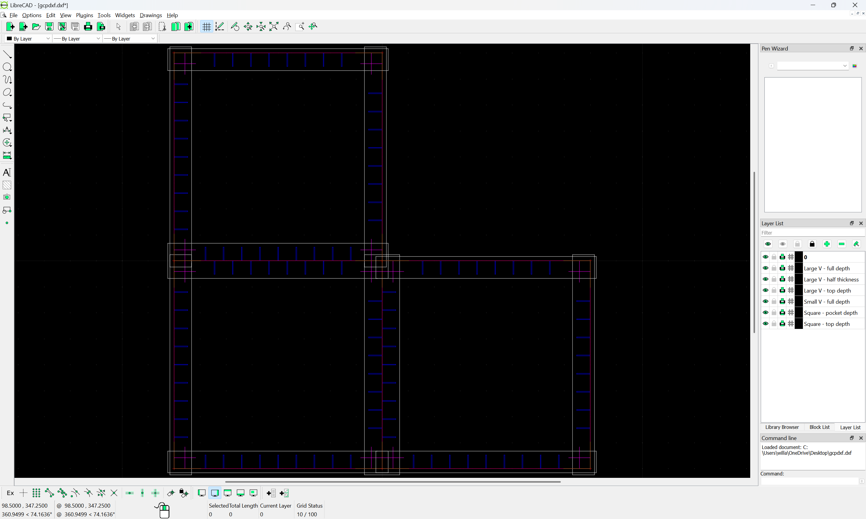

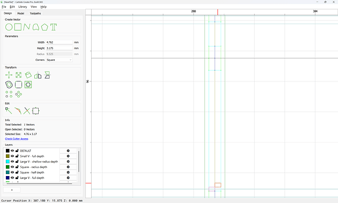

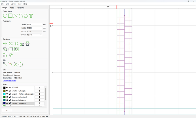

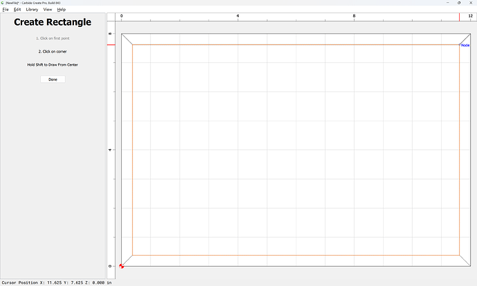

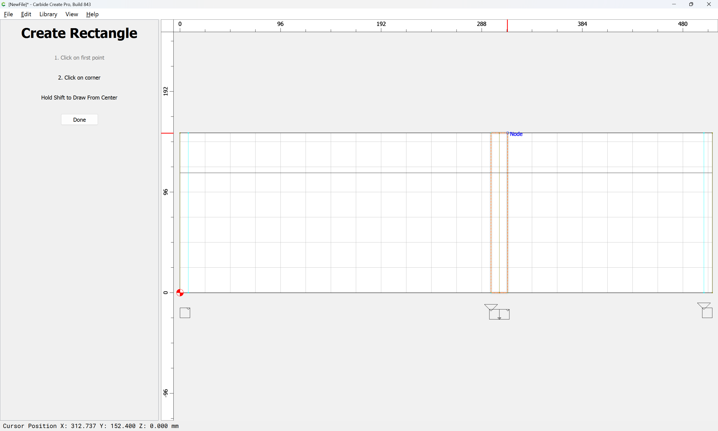

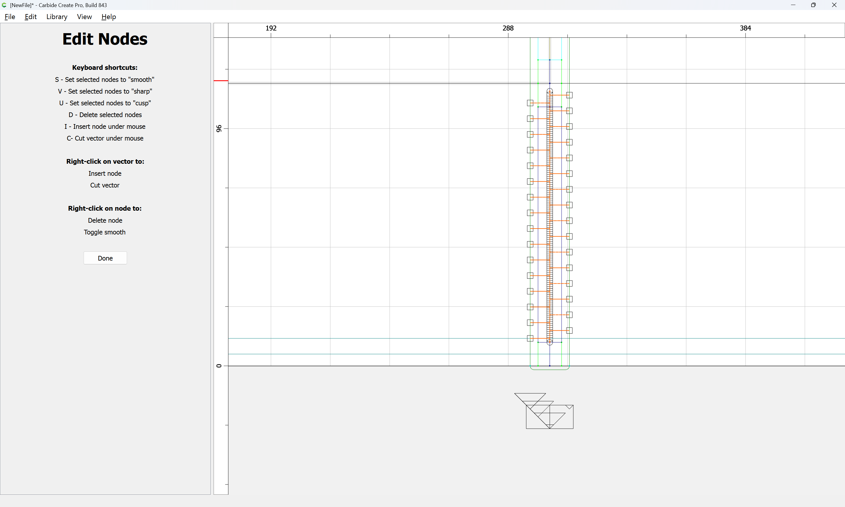

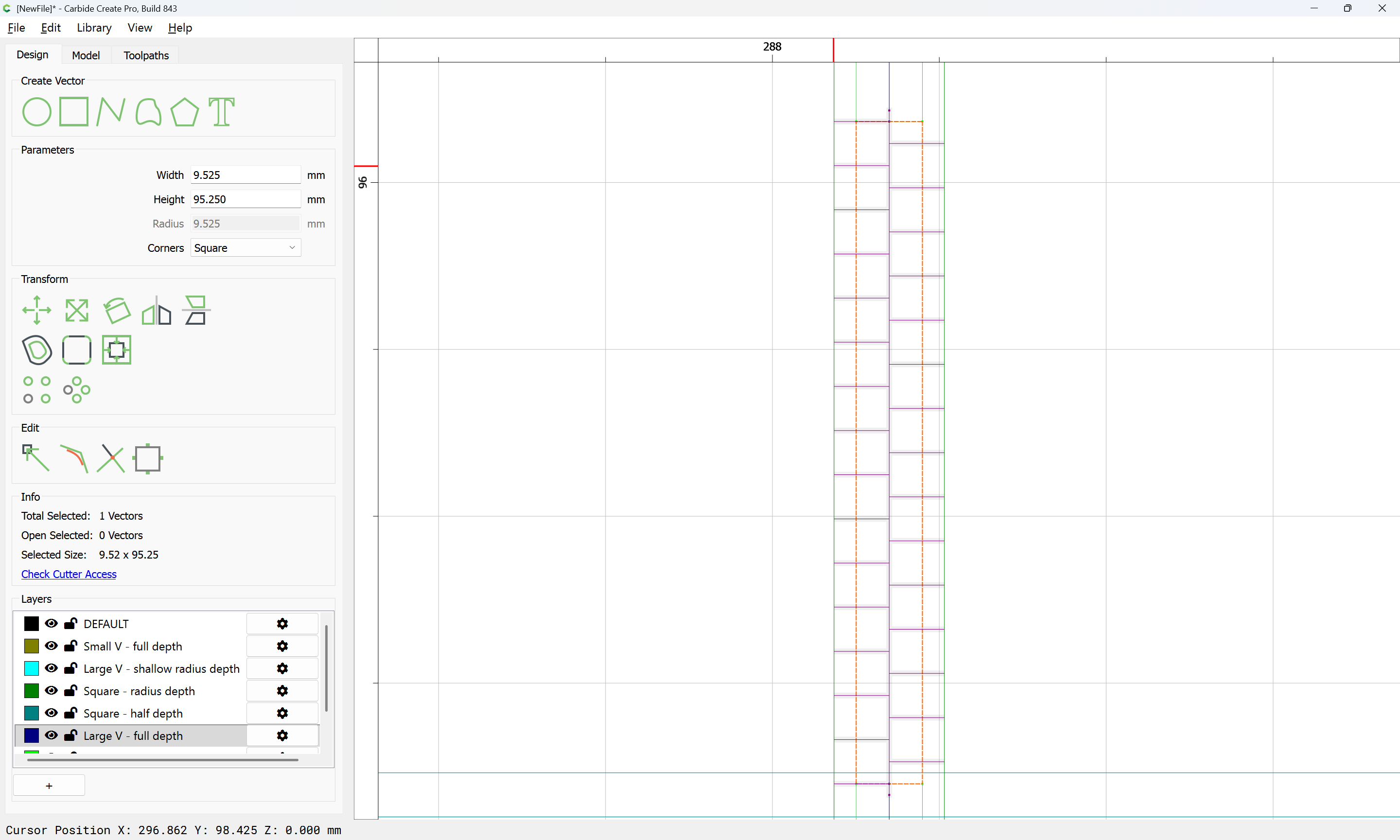

Cutting the actual joinery requires filling two regions:
with an alternating series of paths.

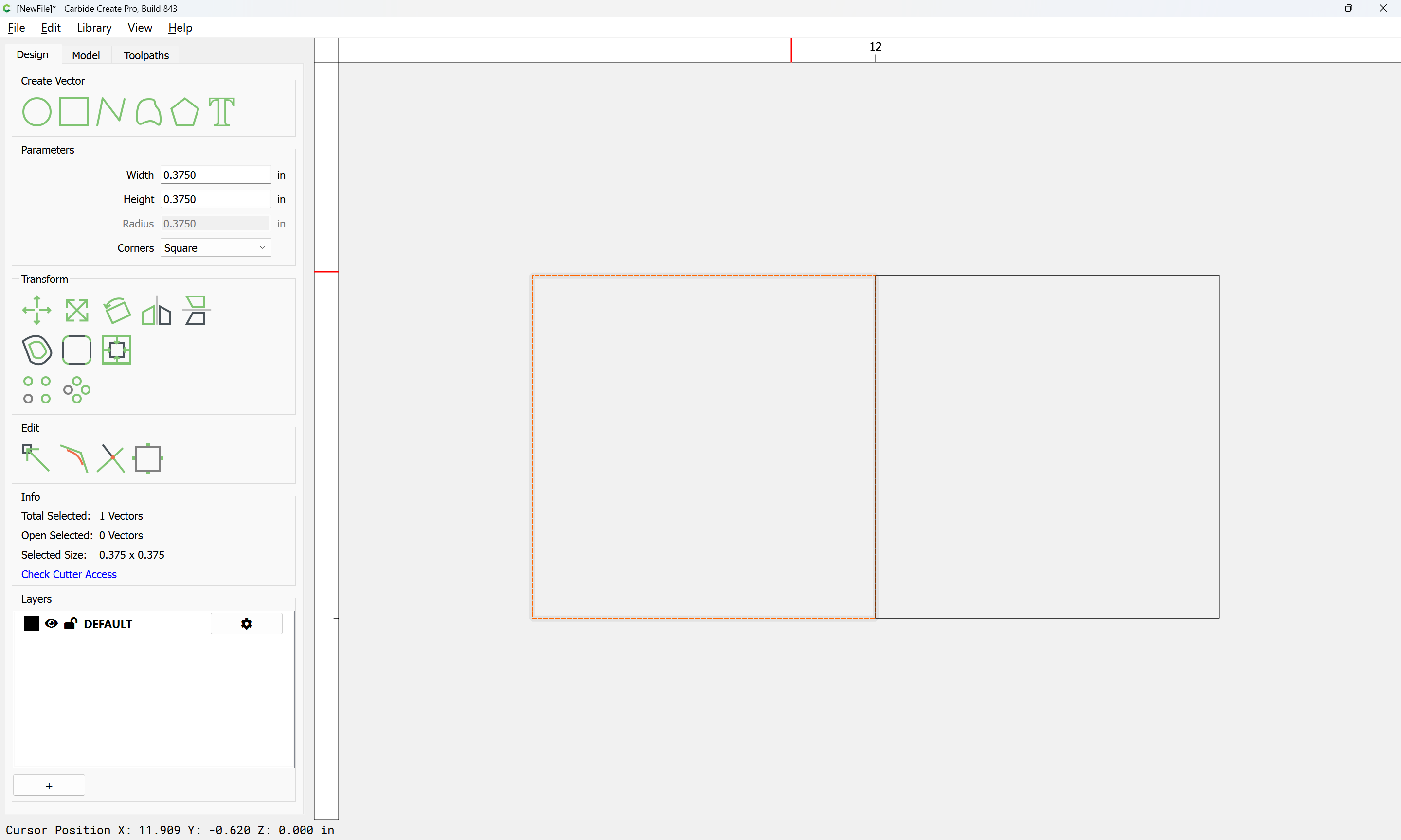

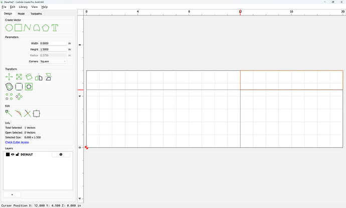

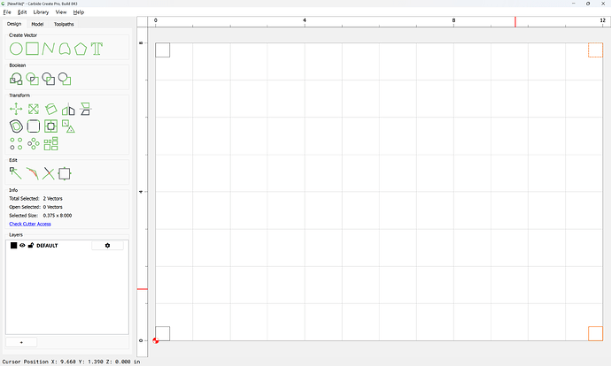

It is easiest to envision this by drawing rectangles which show this outline:
which may then have the requisite geometry for toolpaths drawn along their centers:
Done

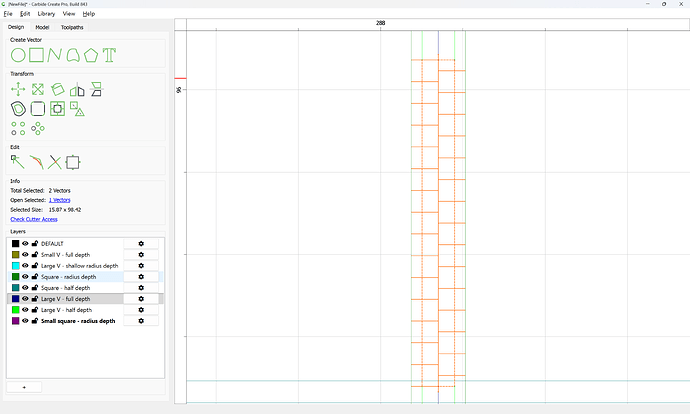

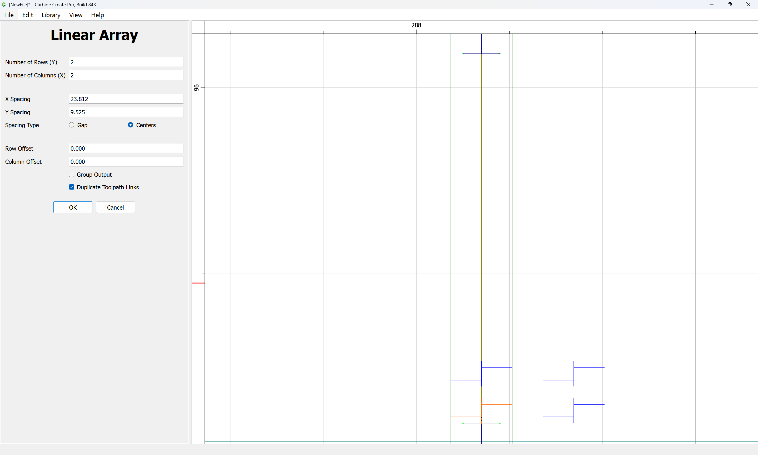

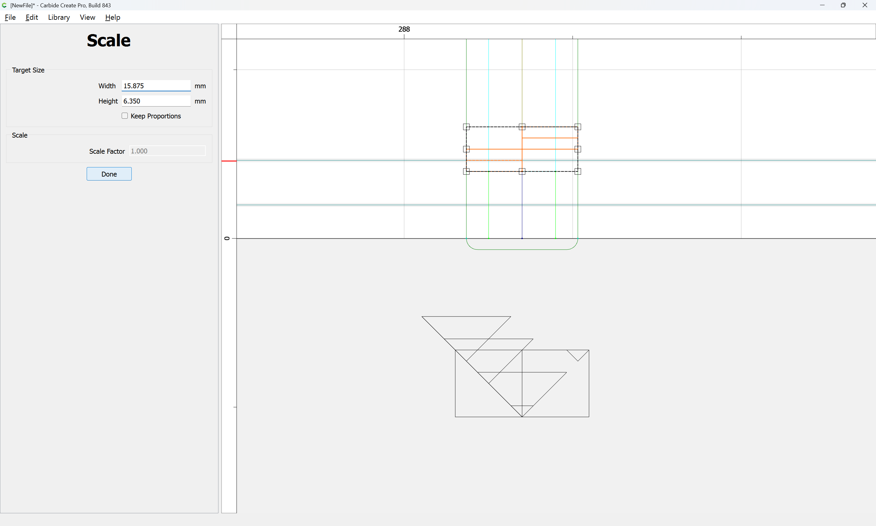

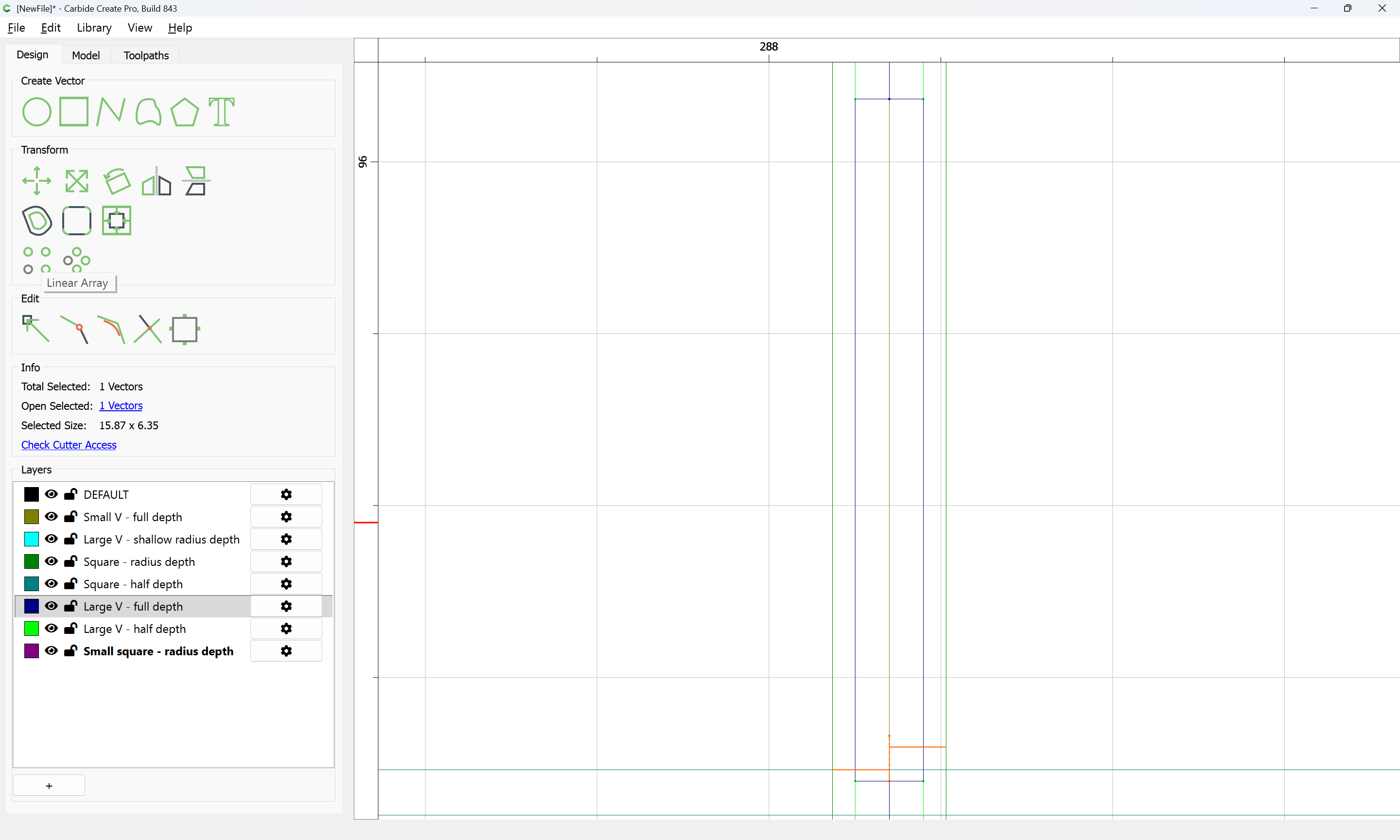

Except that they need to be slightly adjusted in dimension across the joint — they need to be as wide as:
Done
Then the rectangles may be deleted:

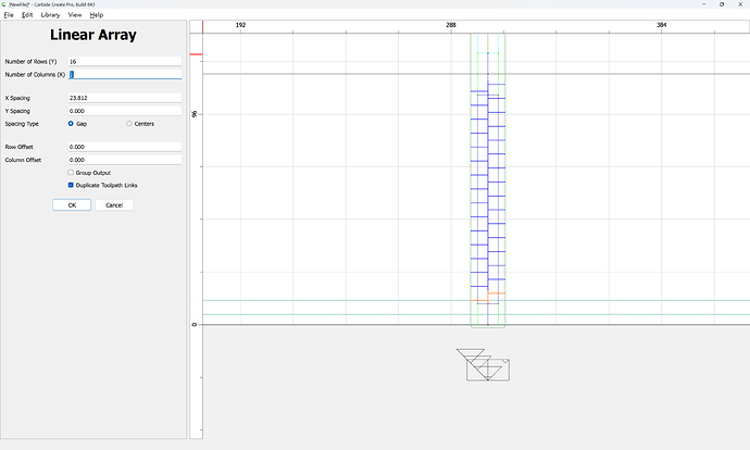

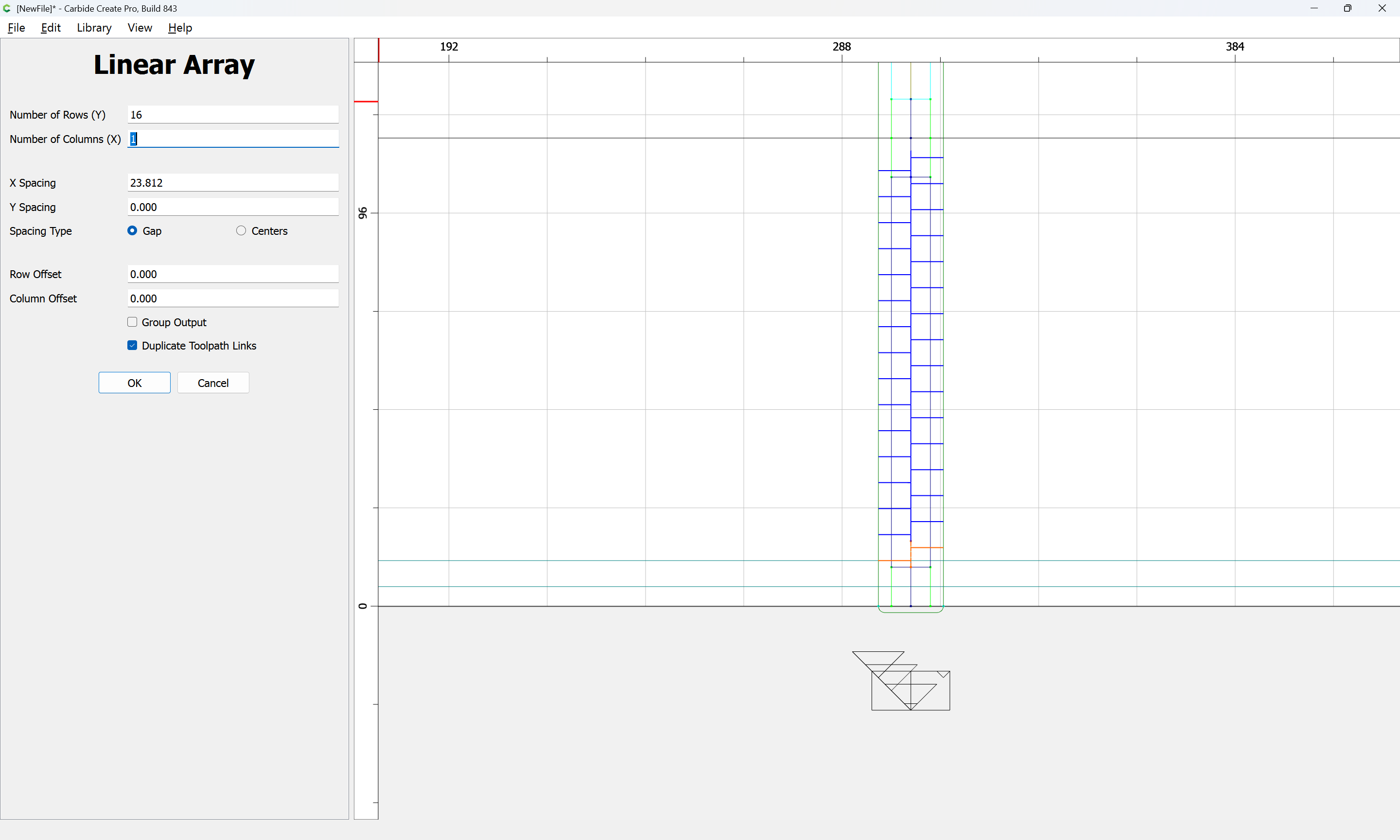

and the toolpath geometry duplicated as needed using a Linear Array:
adjusting so as to fill the desired region:
OK

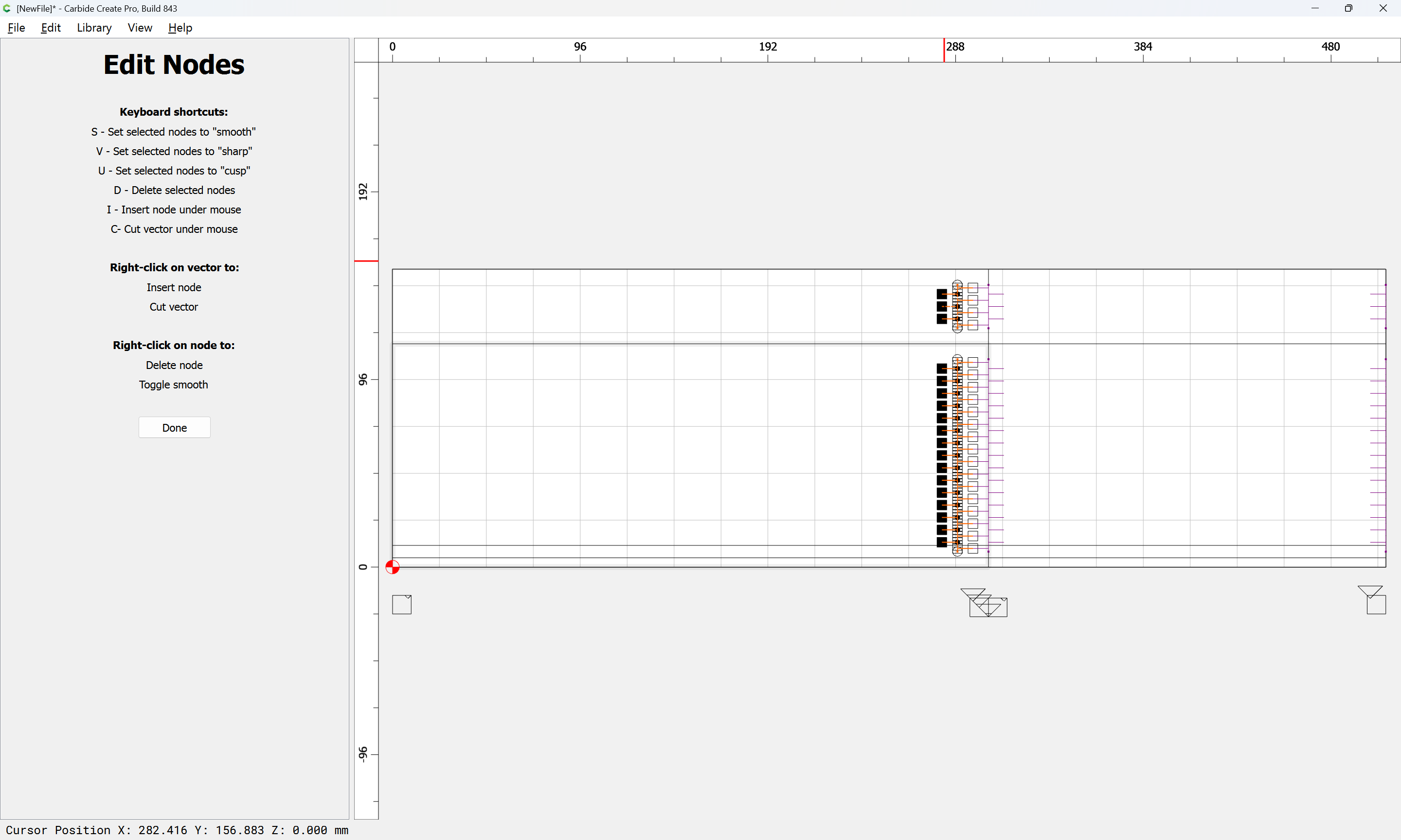

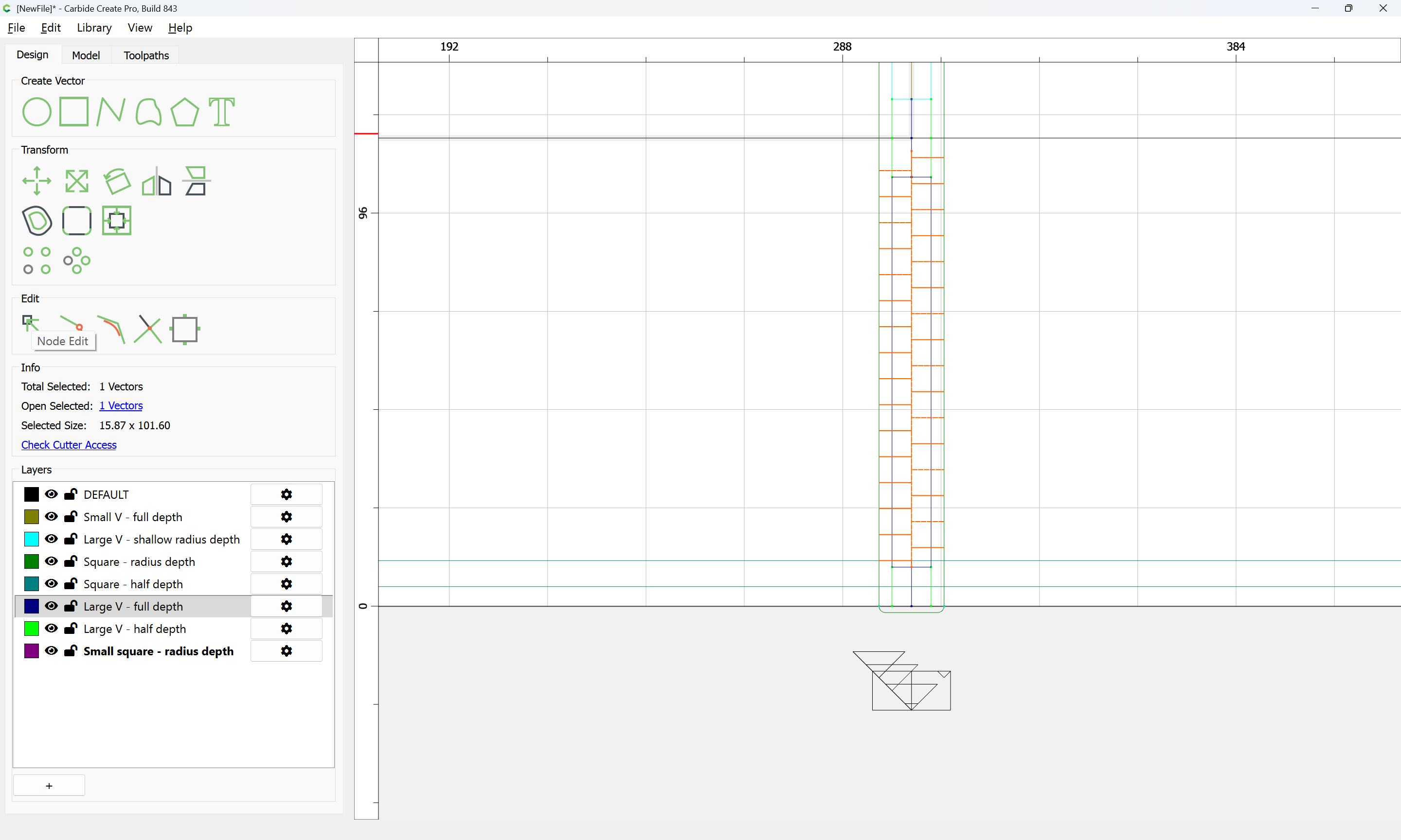

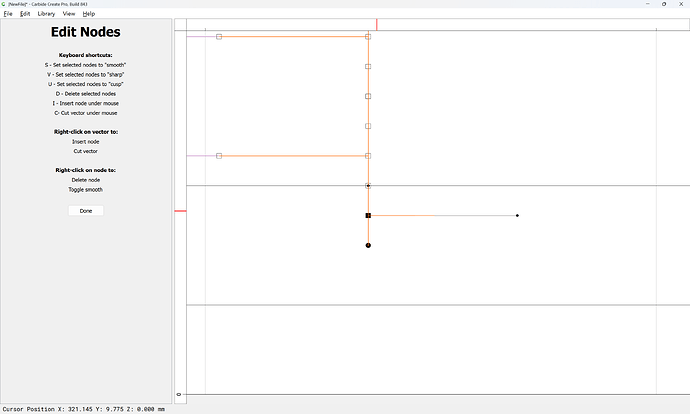

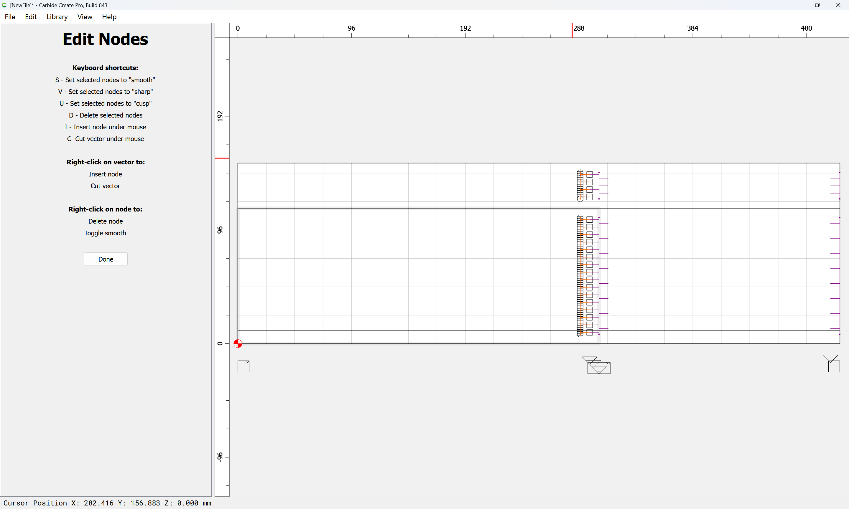

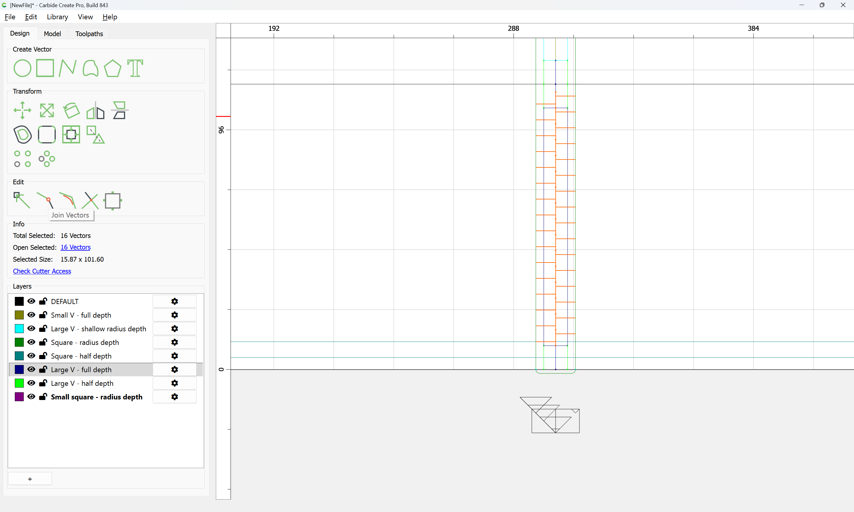

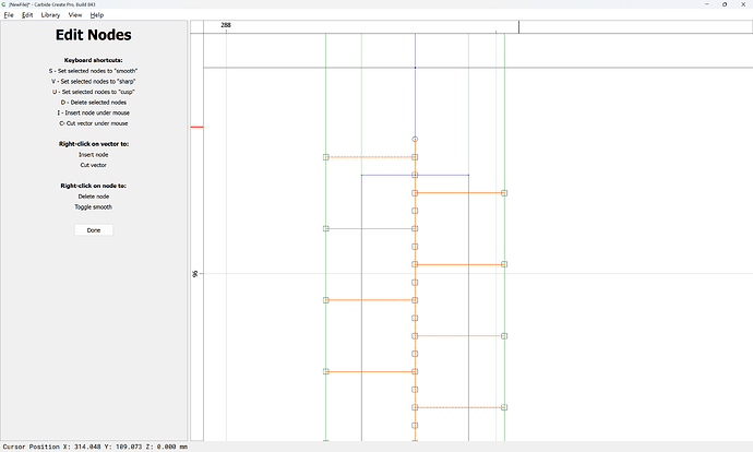

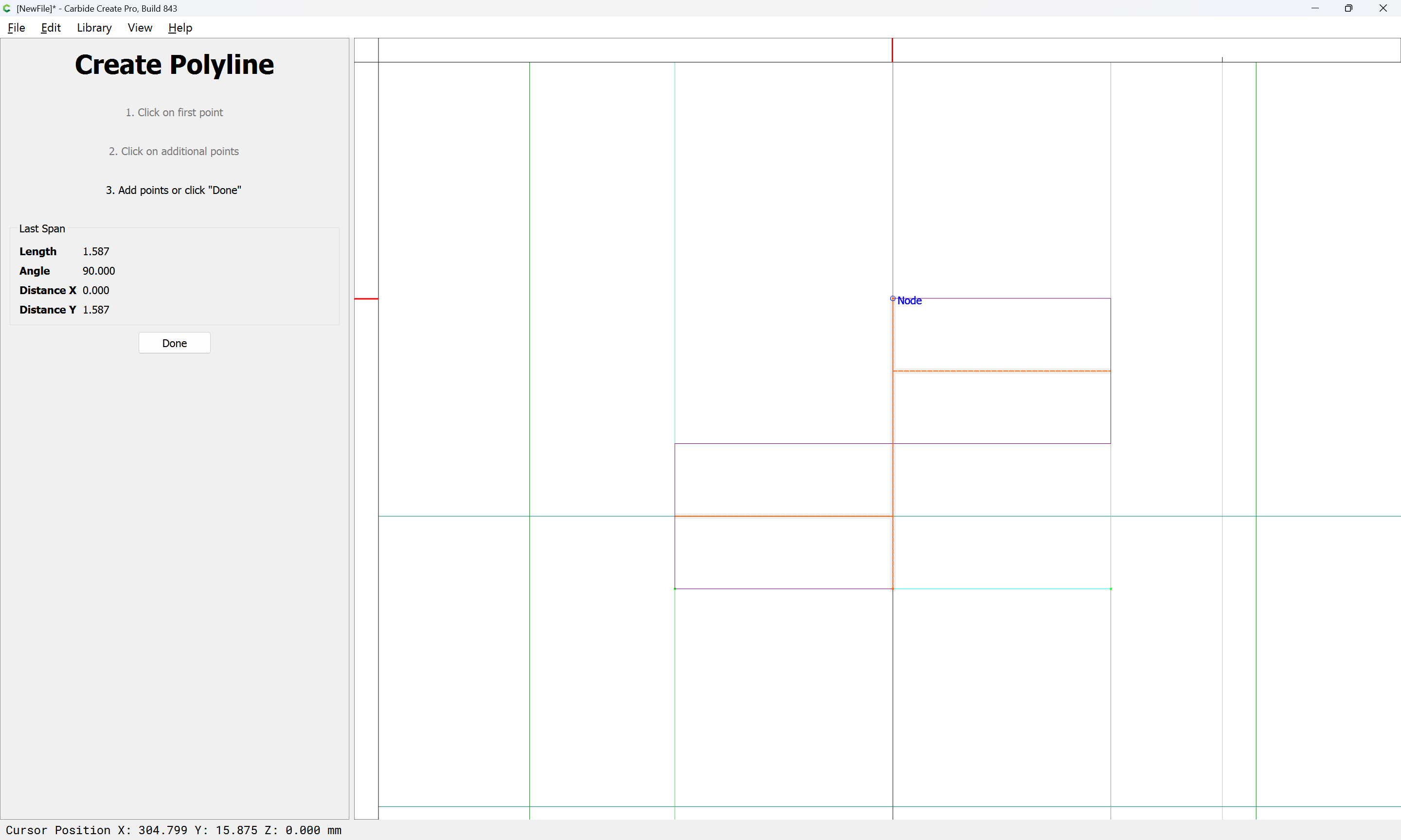

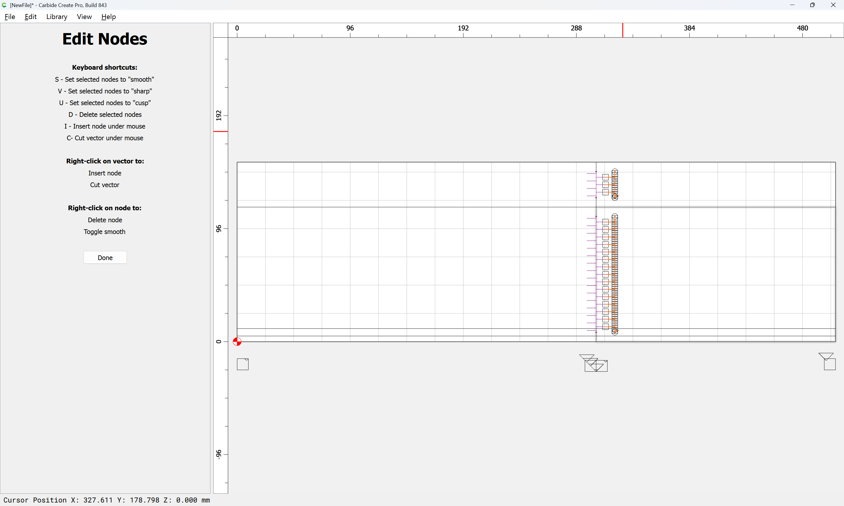

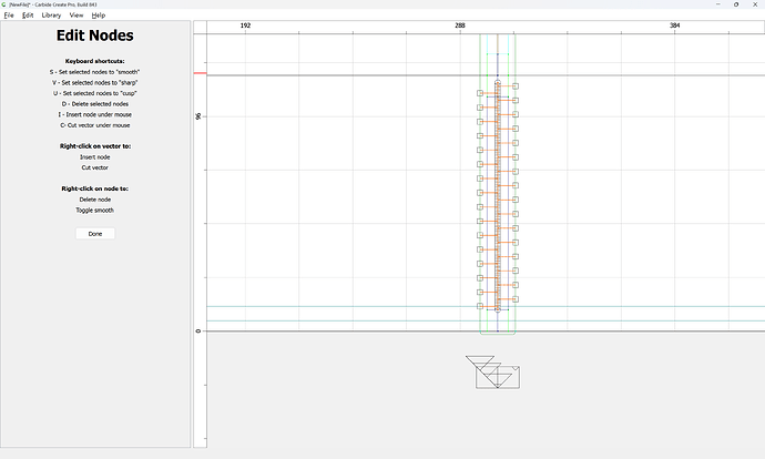

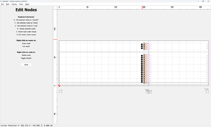

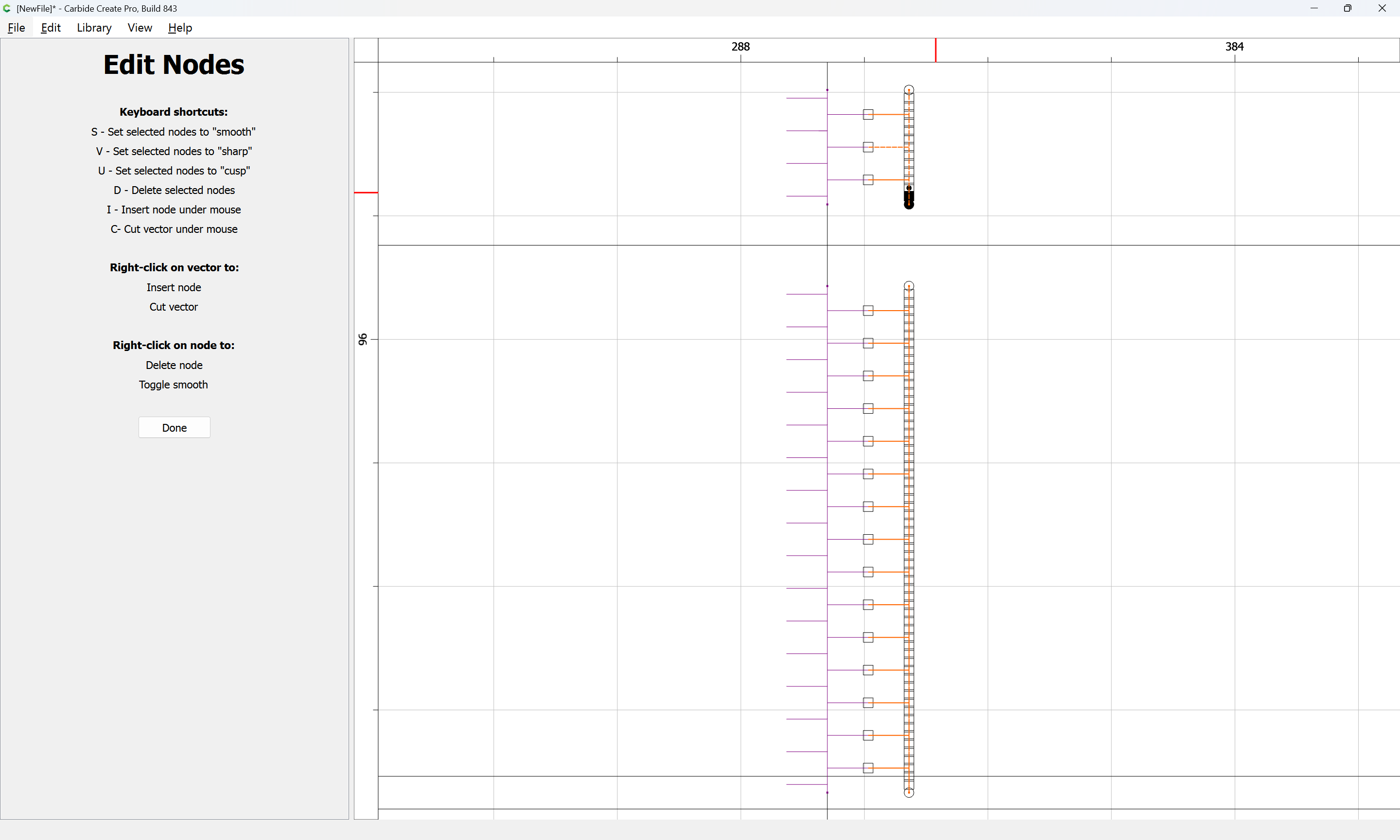

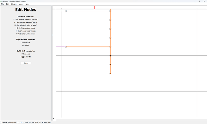

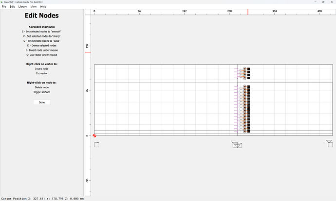

The geometry may then be joined:
Yes

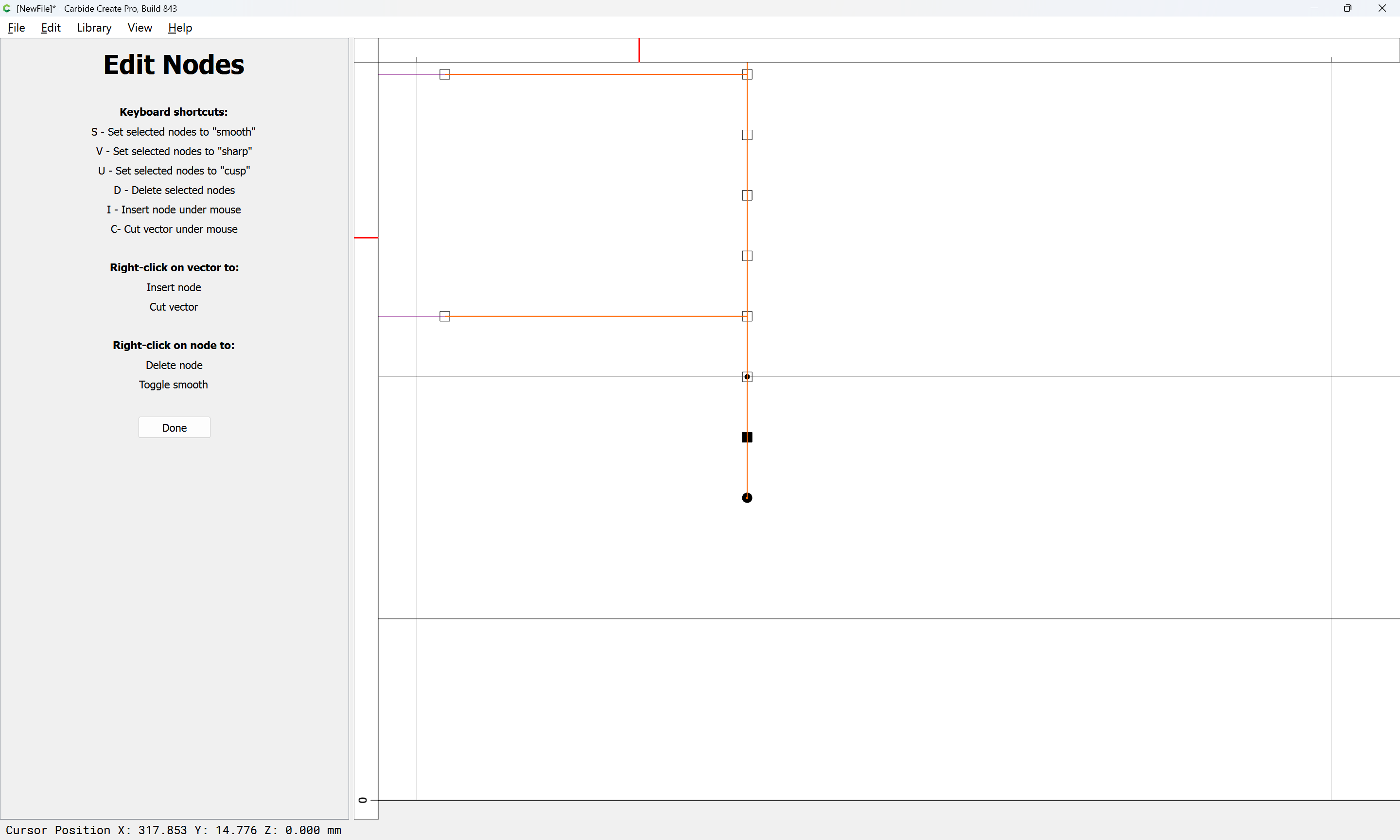

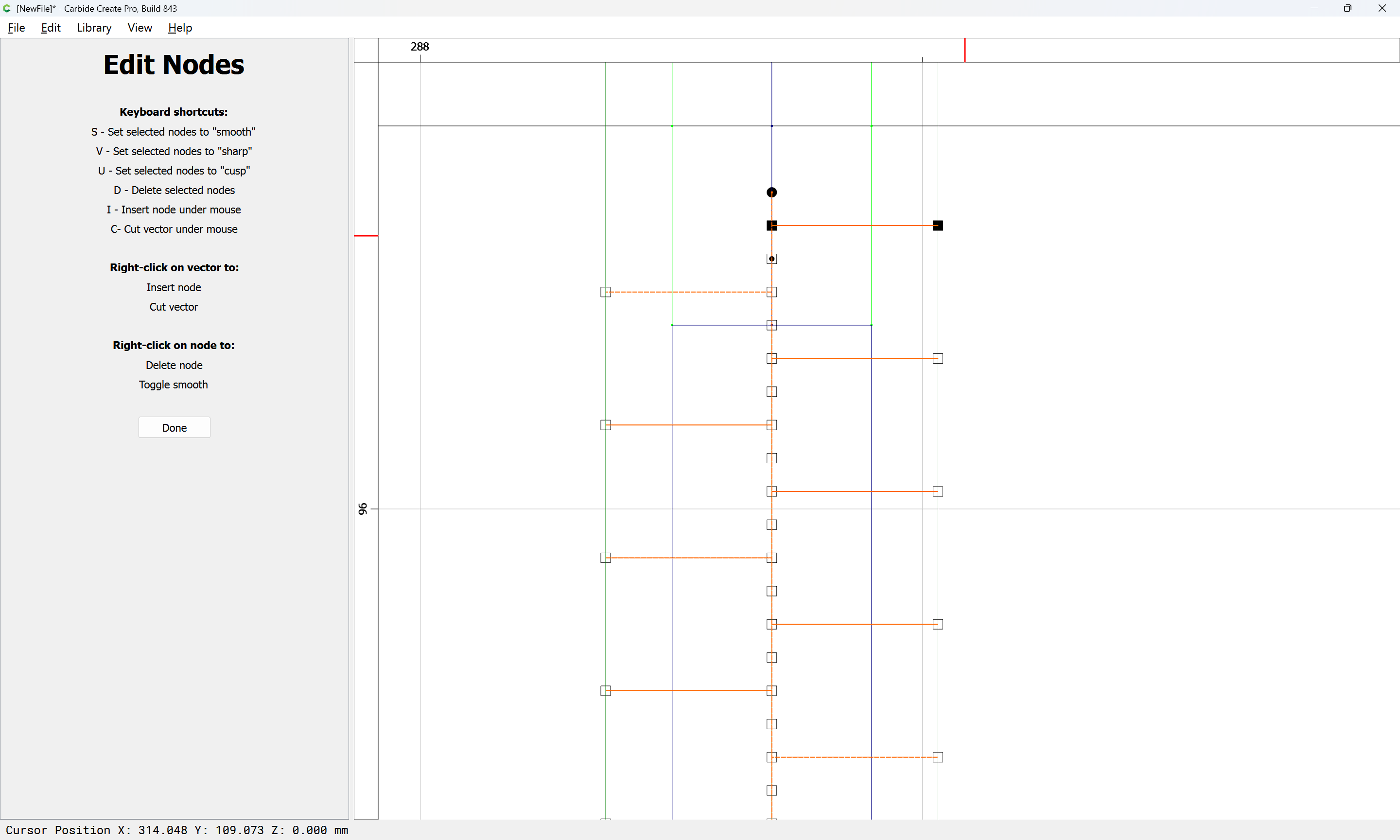

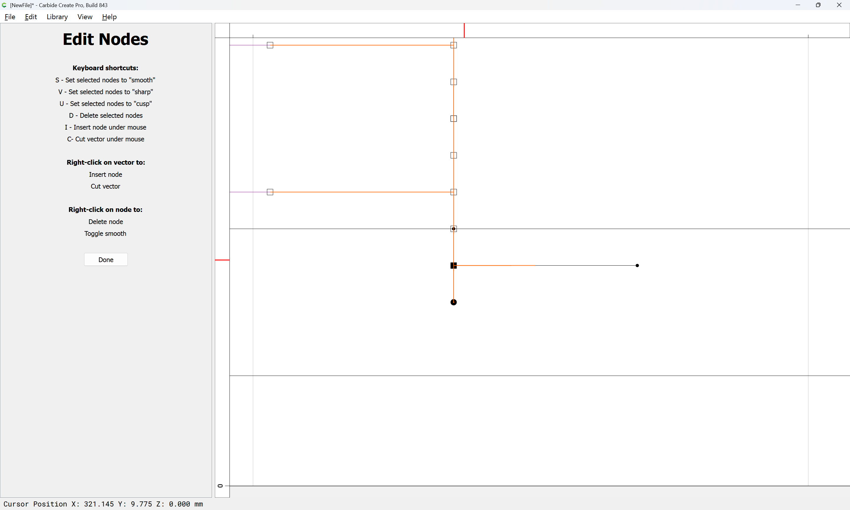

and then Node Edited to remove the one extra recess:
d
Done

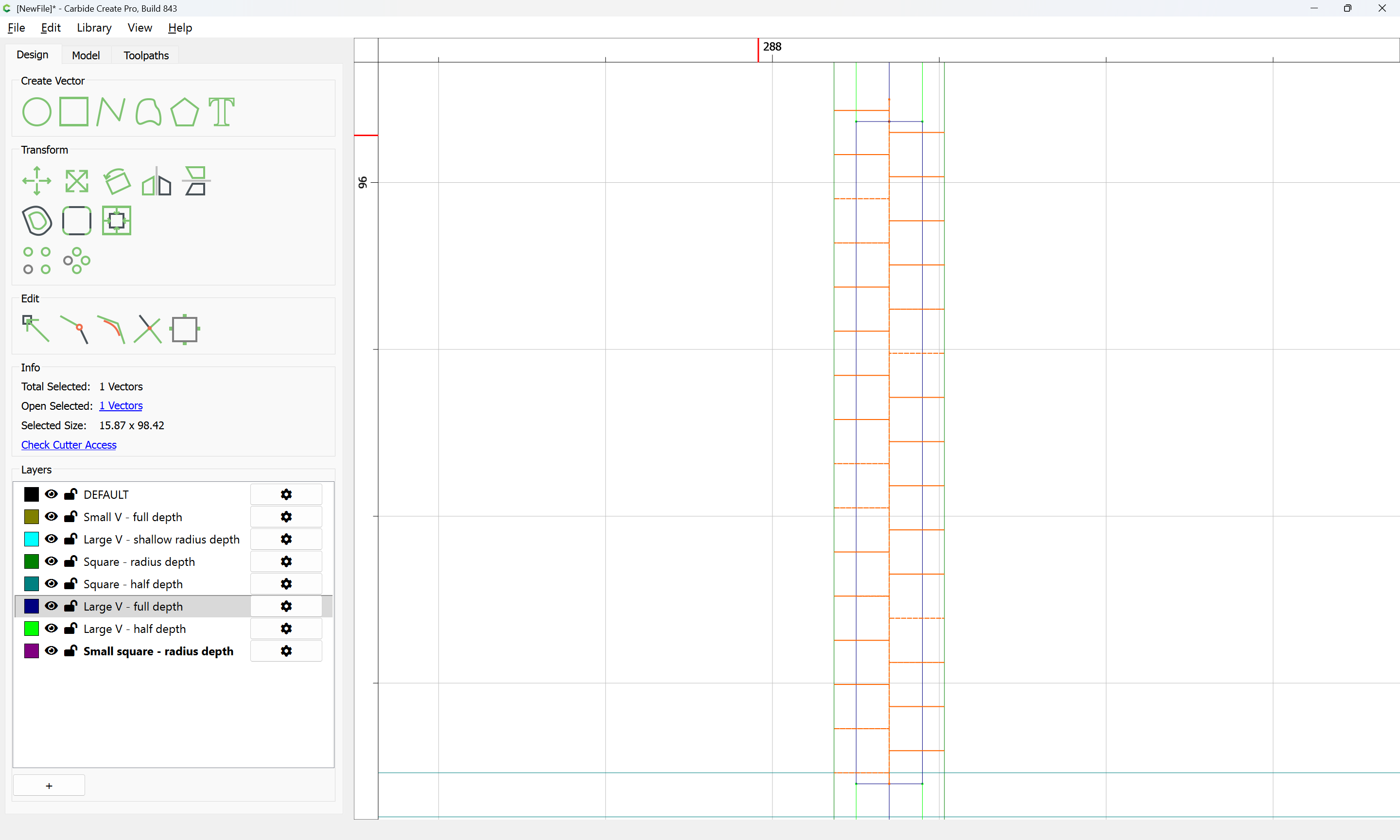

Then aligned vertically with the rectangle drawn in to describe the region:
Ok
and the rectangle deleted:

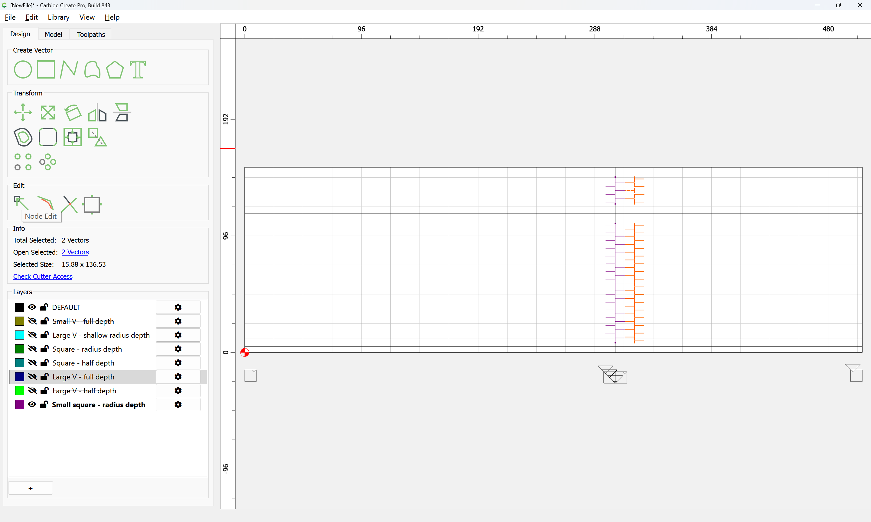

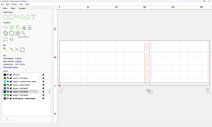

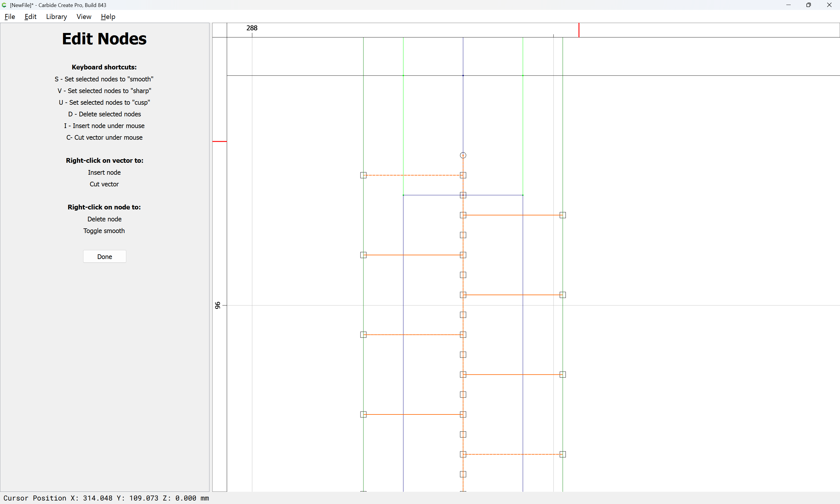

This is then repeated for the upper portion:

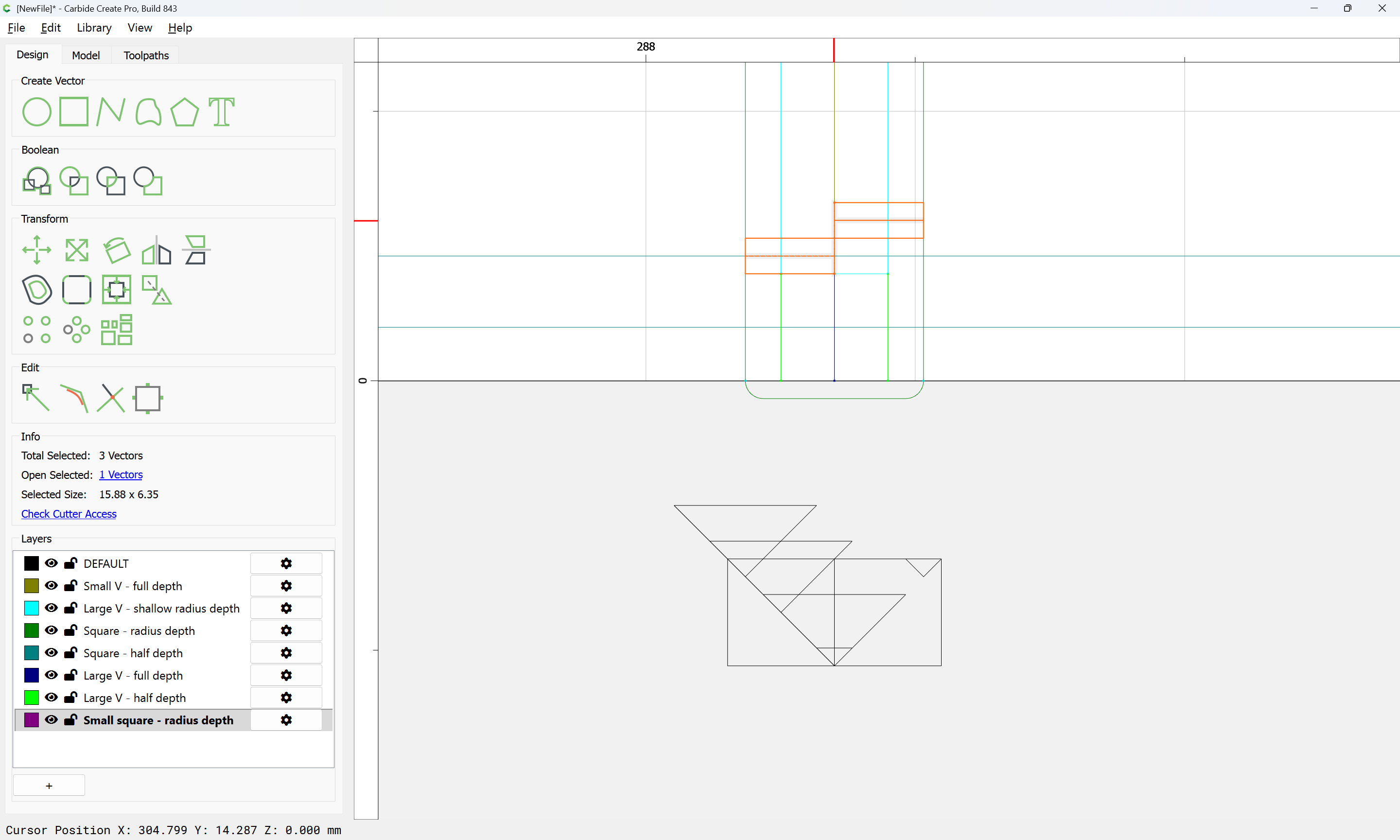

and then they are duplicated for the other portions which will each require a suitable half of the recesses:

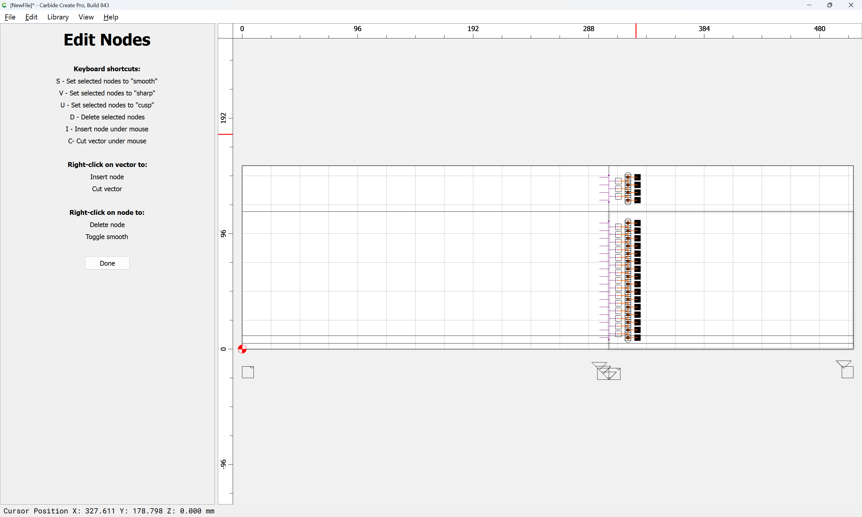

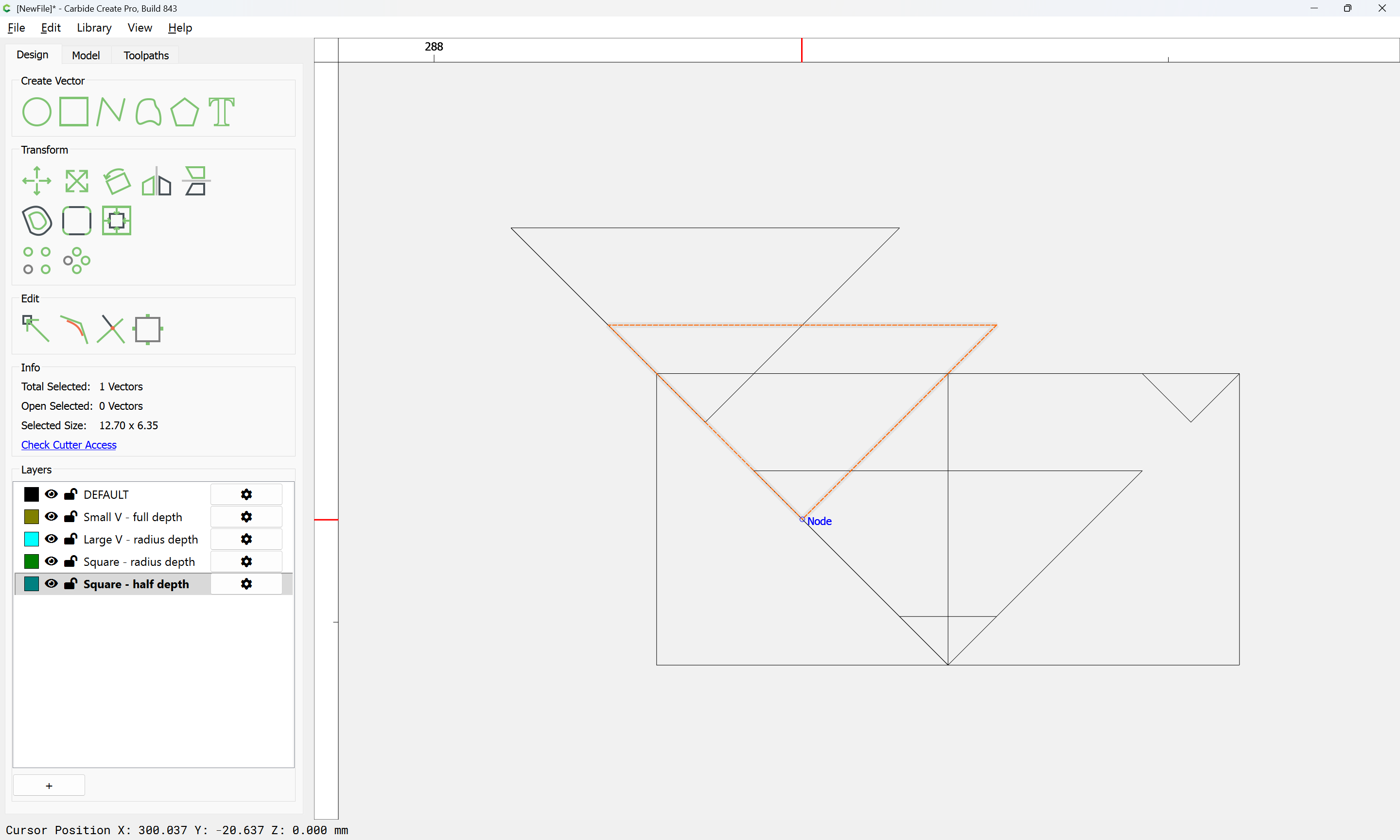

Using Node Editing, each added set of geometry may be trimmed down to only what is wanted:
d
Done

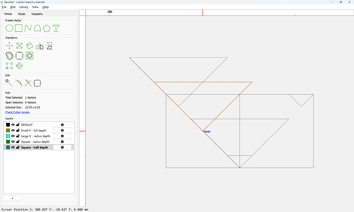

If a given node results in the wrong shape, use Node Editing to select it:
and set it aright:
v
Done

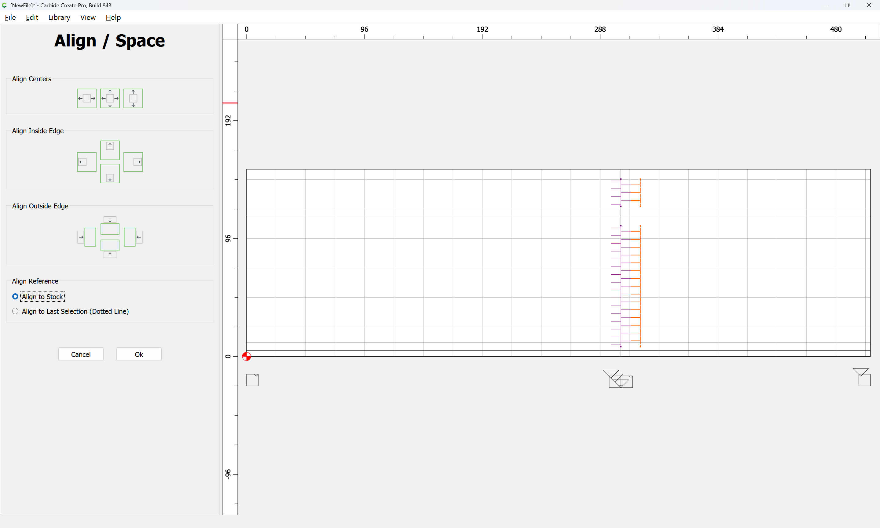

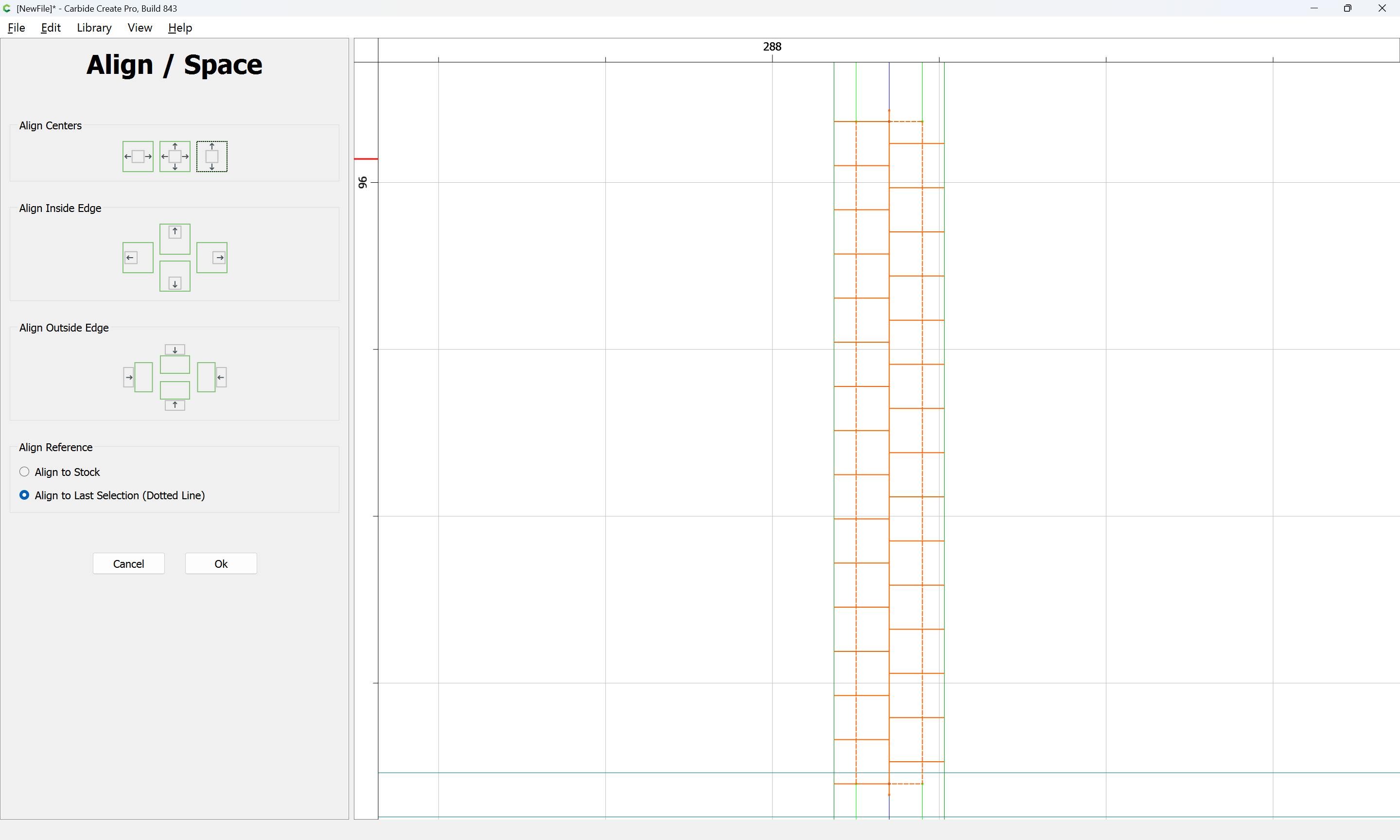

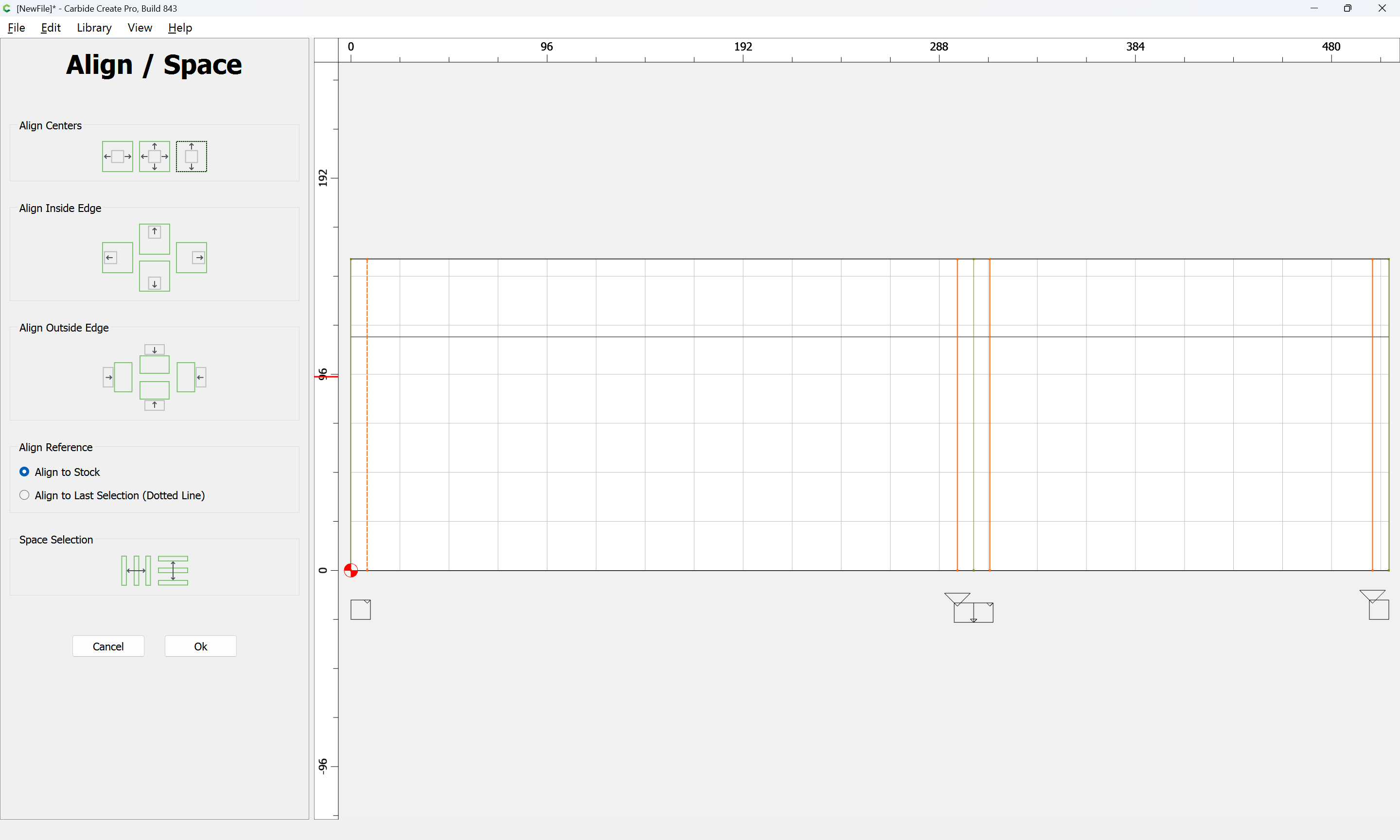

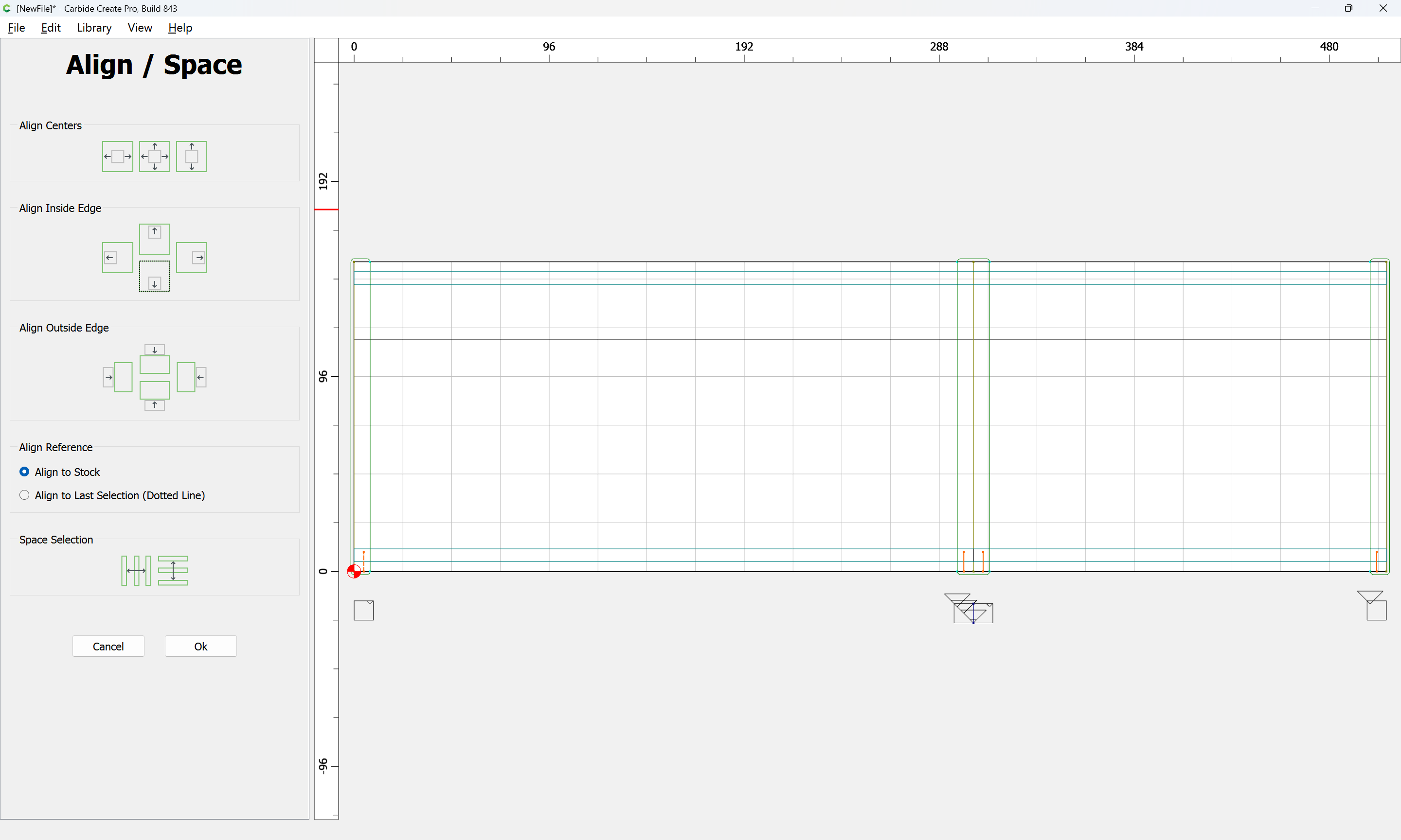

Align Vectors may then be used to position each such added section:
Ok
d
Done

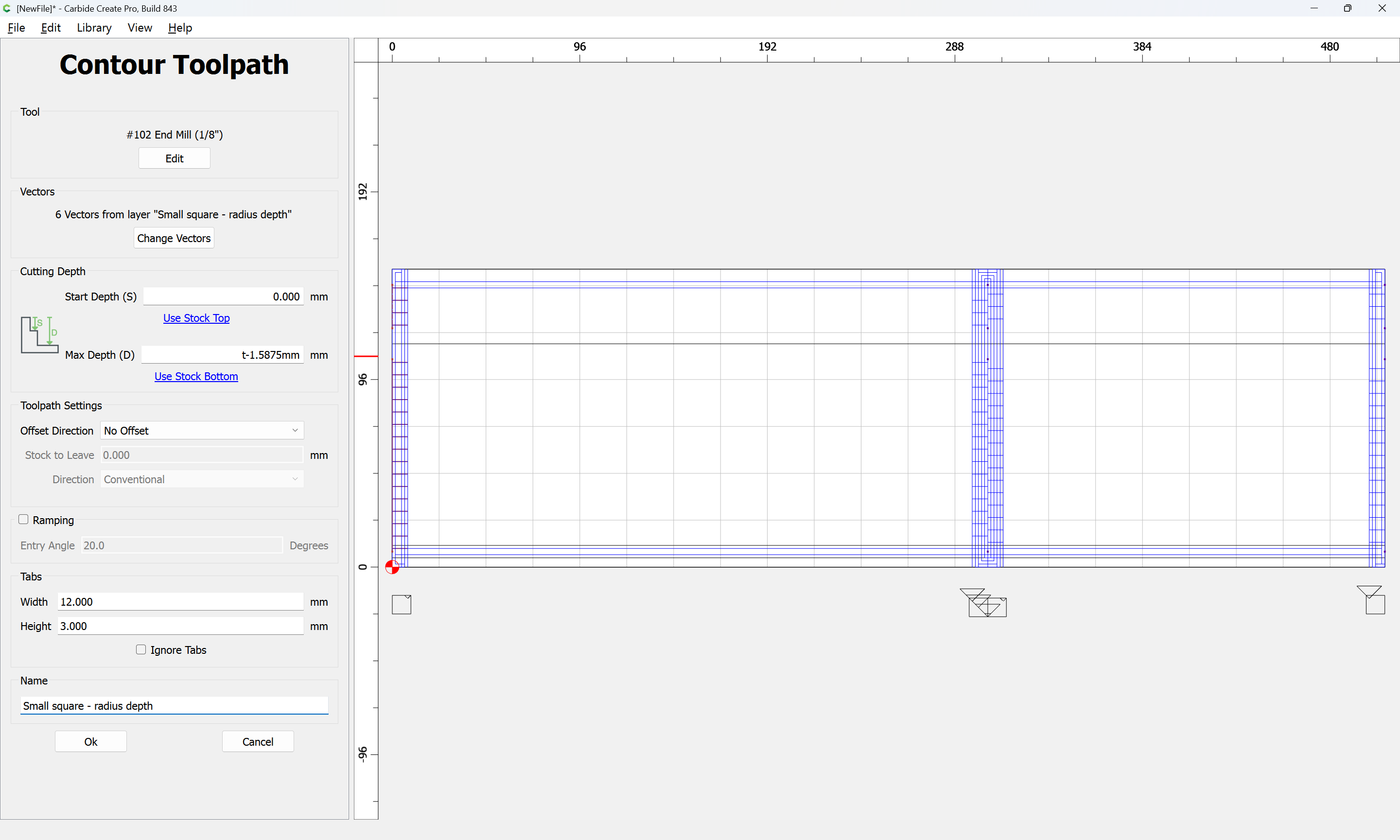

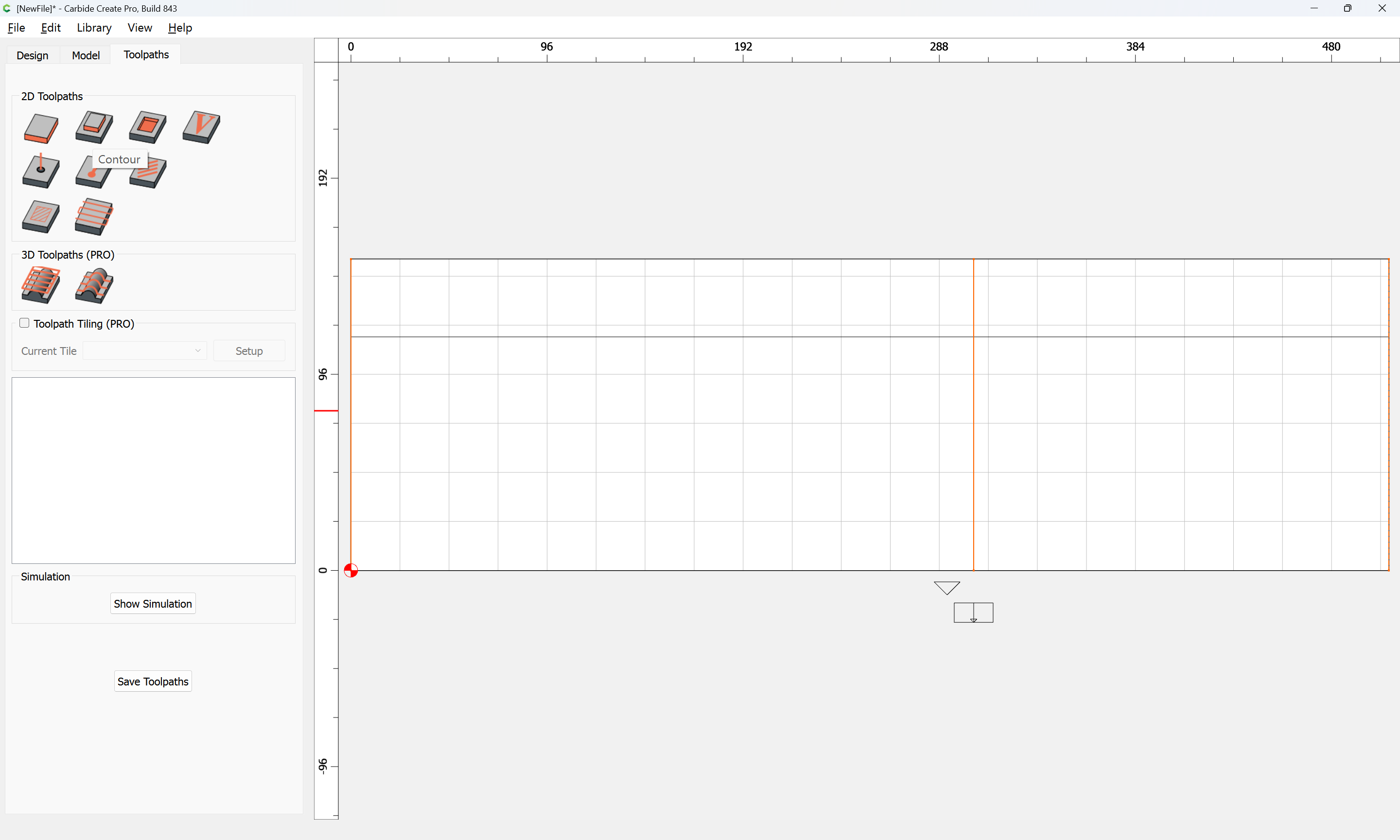

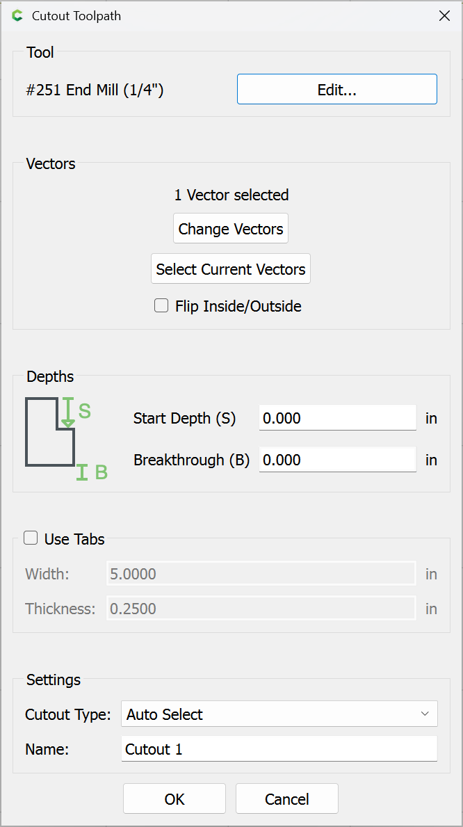

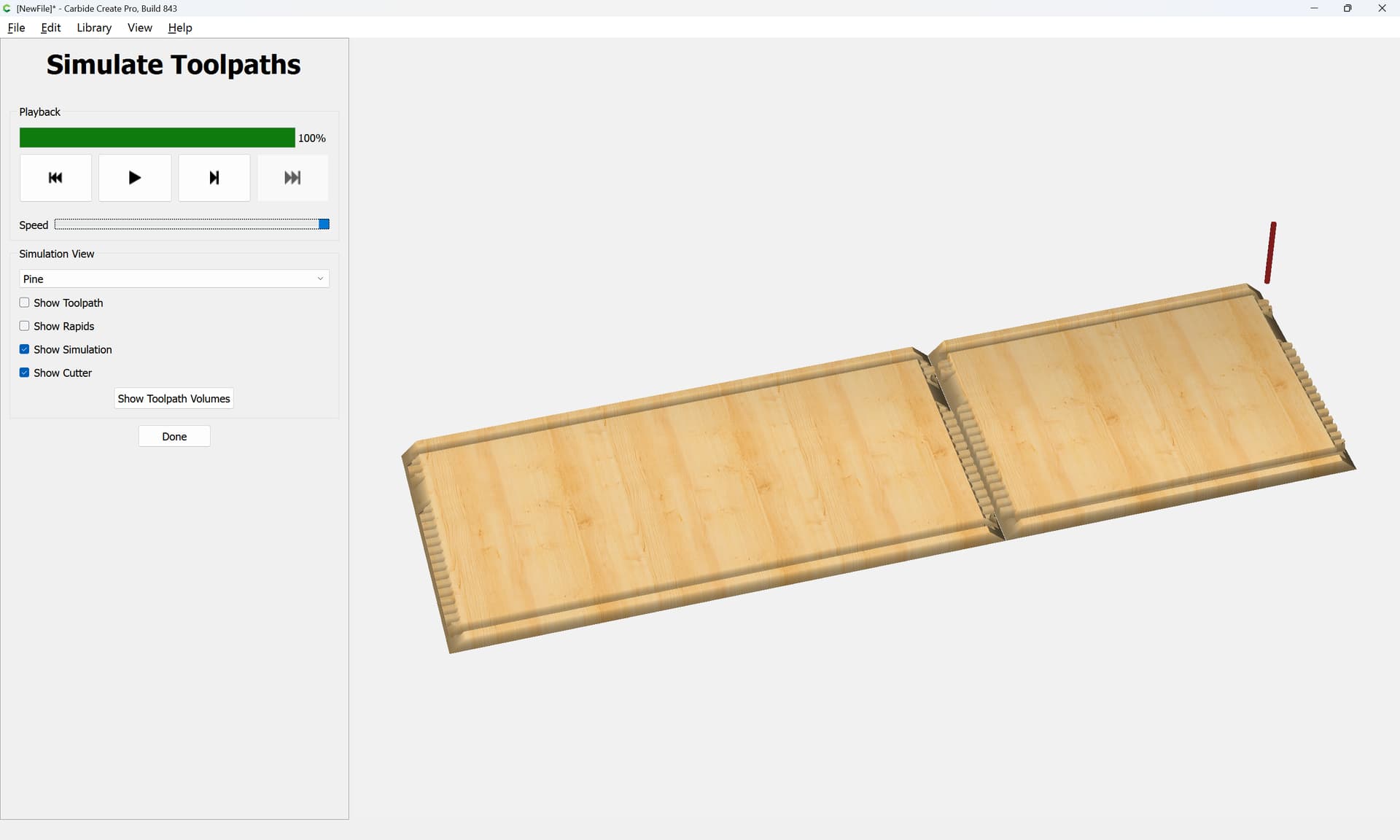

Then, assign a toolpath:
which previews as:
and which when cut, should fit together as expected.
Please test in a piece of scrap before committing to an expensive piece of stock.

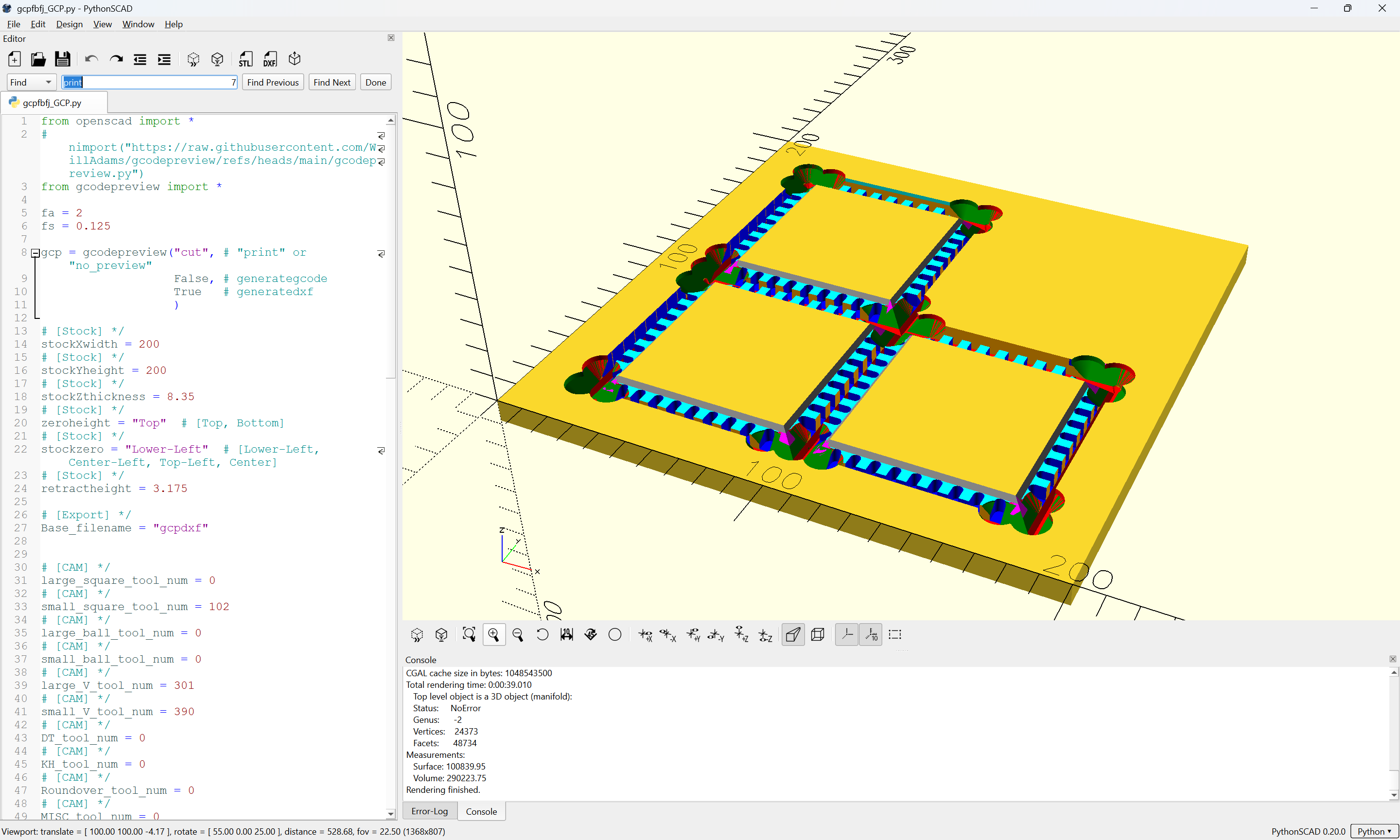

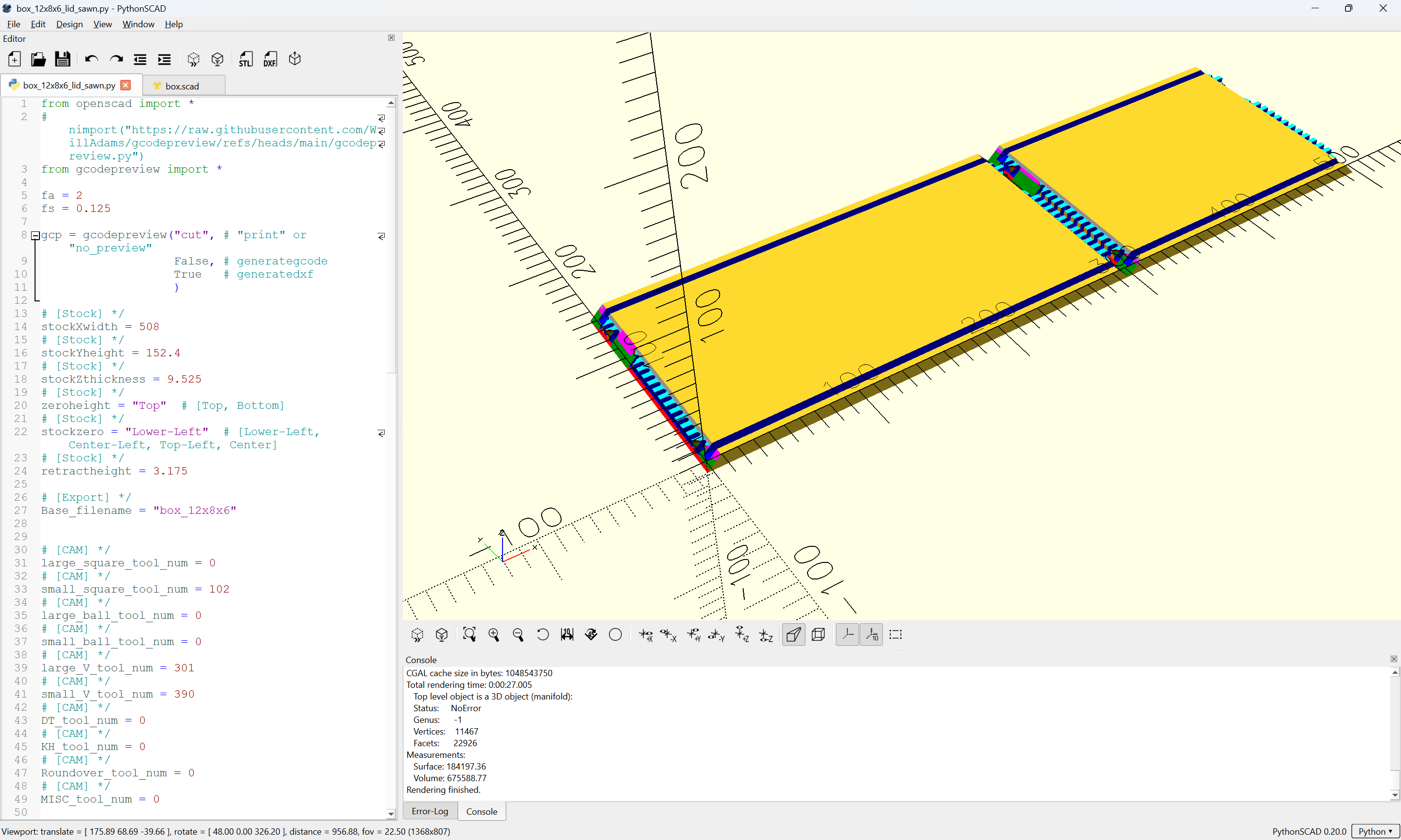

It is worth noting that the toolpaths will want to be ordered and adjusted for optimizing tool changes and for cutting depth/material removed — a further optimization might be to edit geometry so as to avoid redundant cutting, as defined above, the Small V and Large V full-depth cuts have some overlap. This too is left as an exercise for the reader.
Or, one can just write a computer program using my tool:
(which is still mostly in the proof-of-concept/working out interfaces/testing phase — waiting for feedback, &c.)

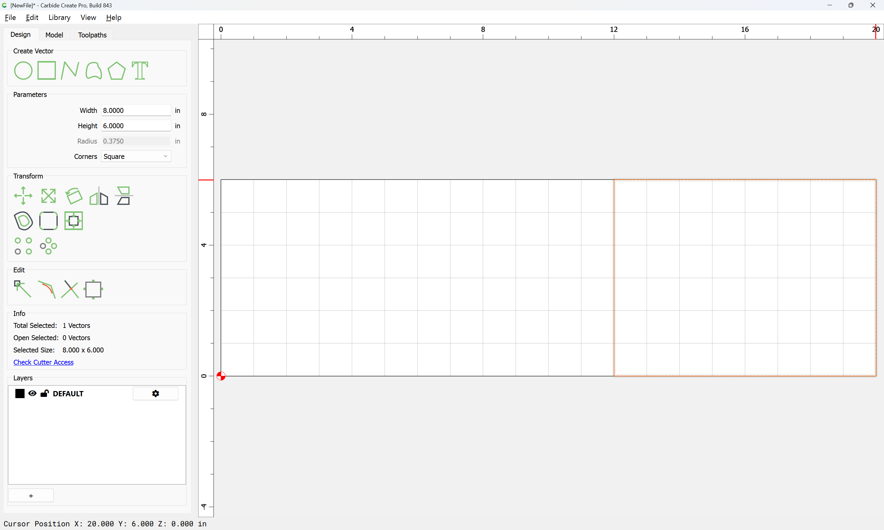

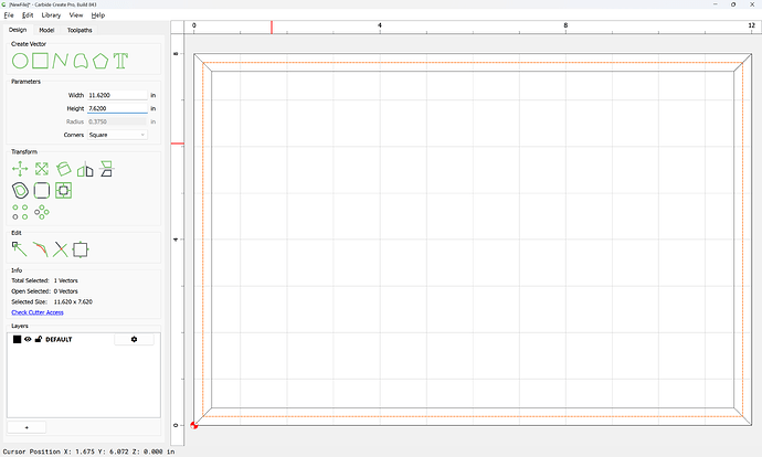

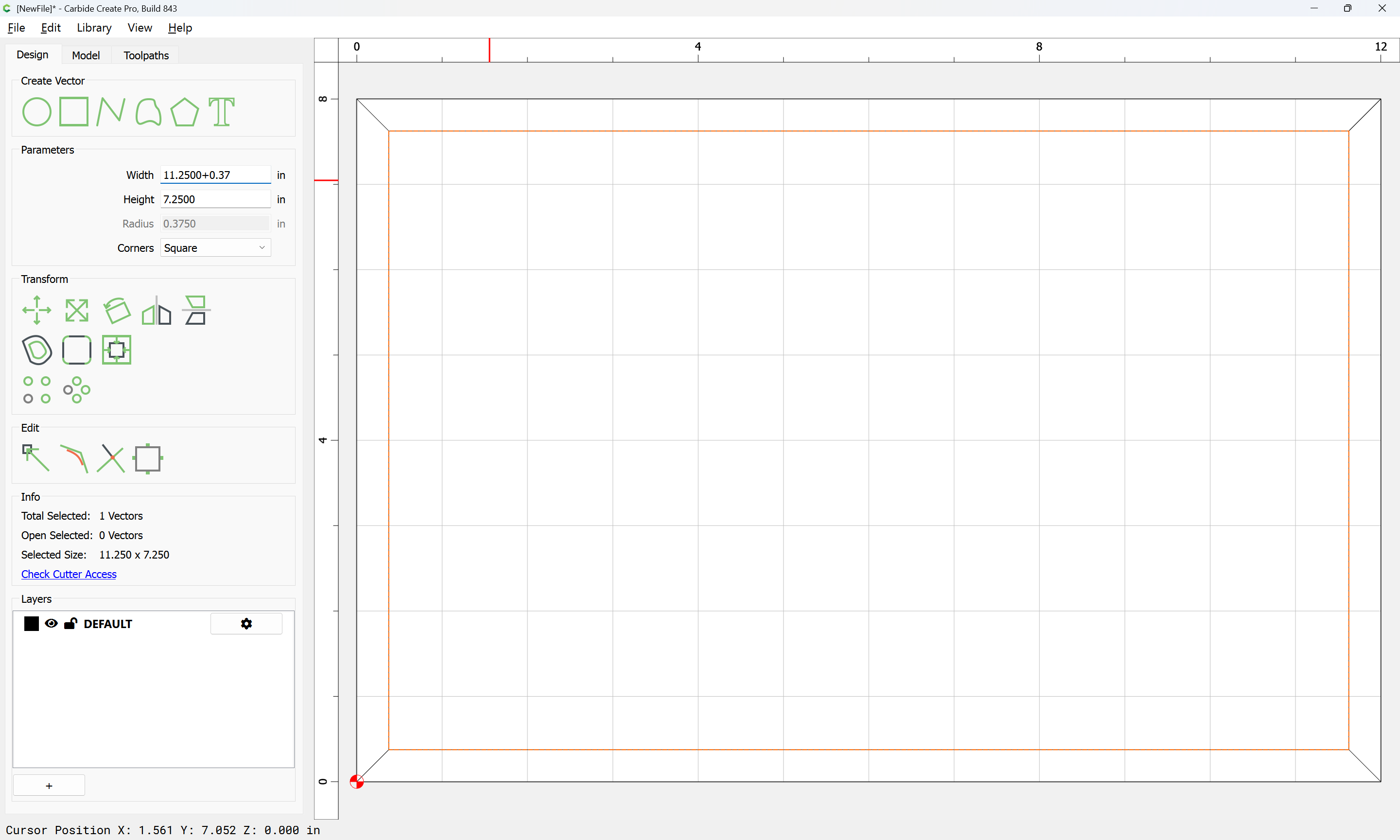

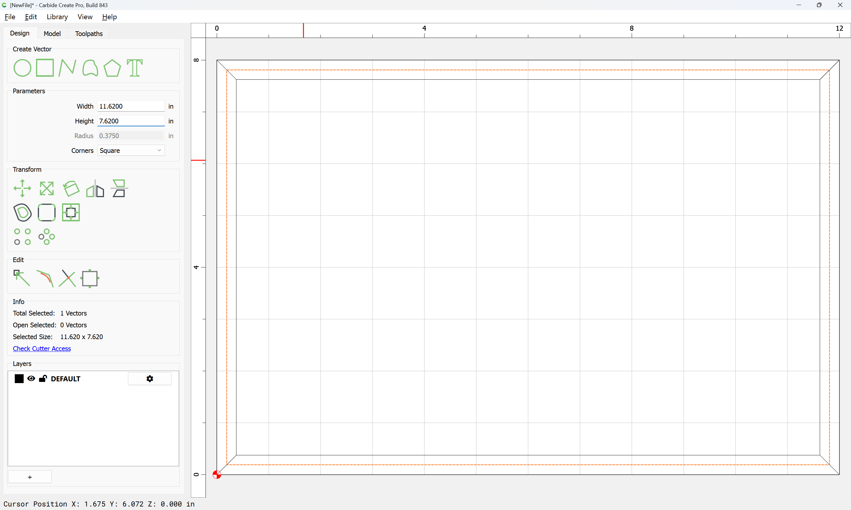

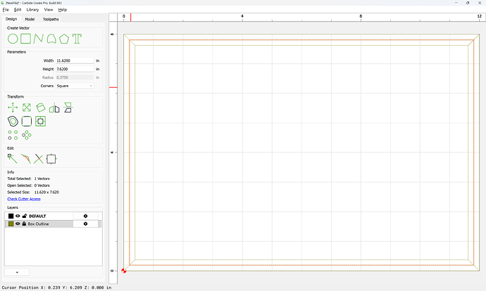

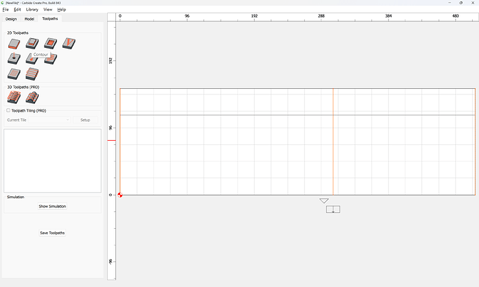

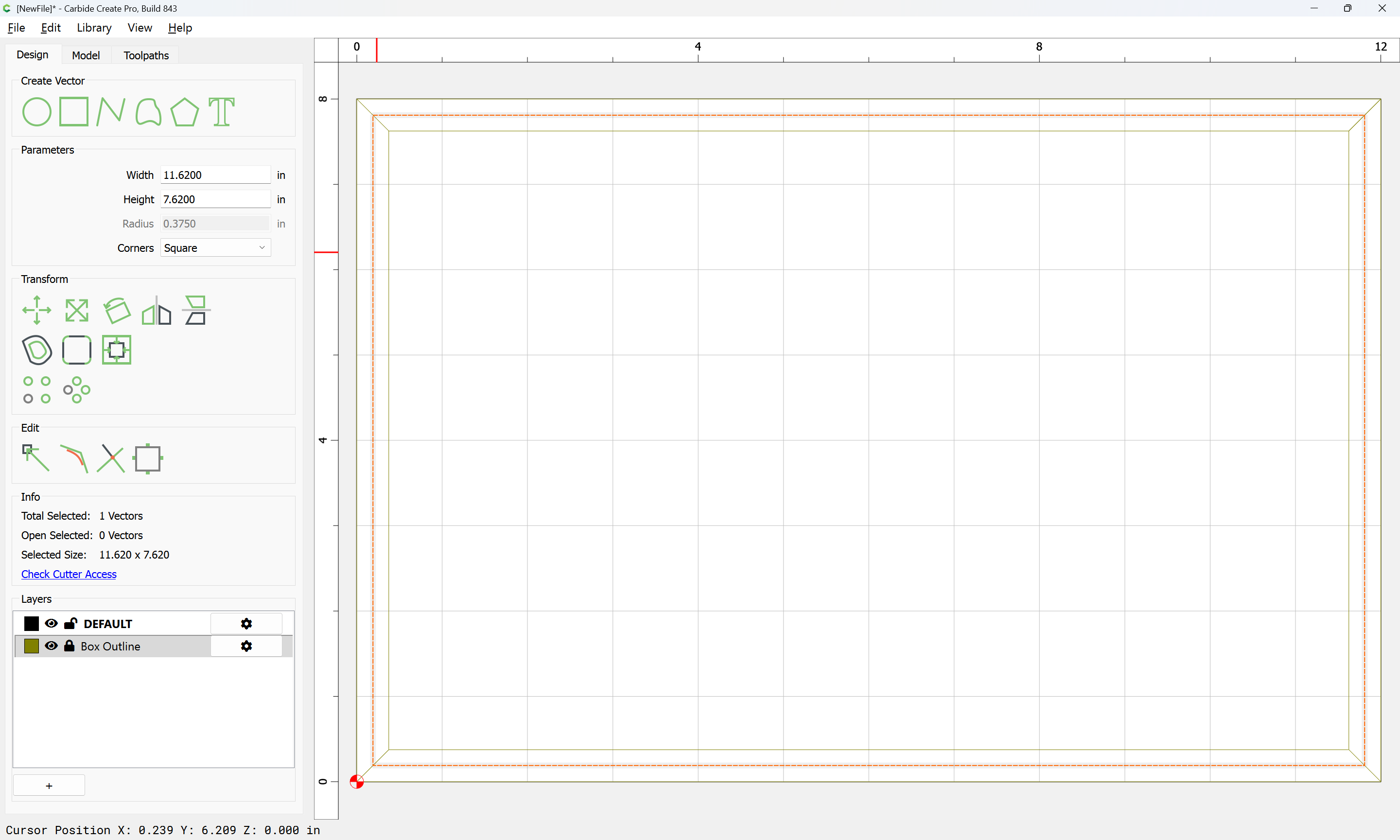

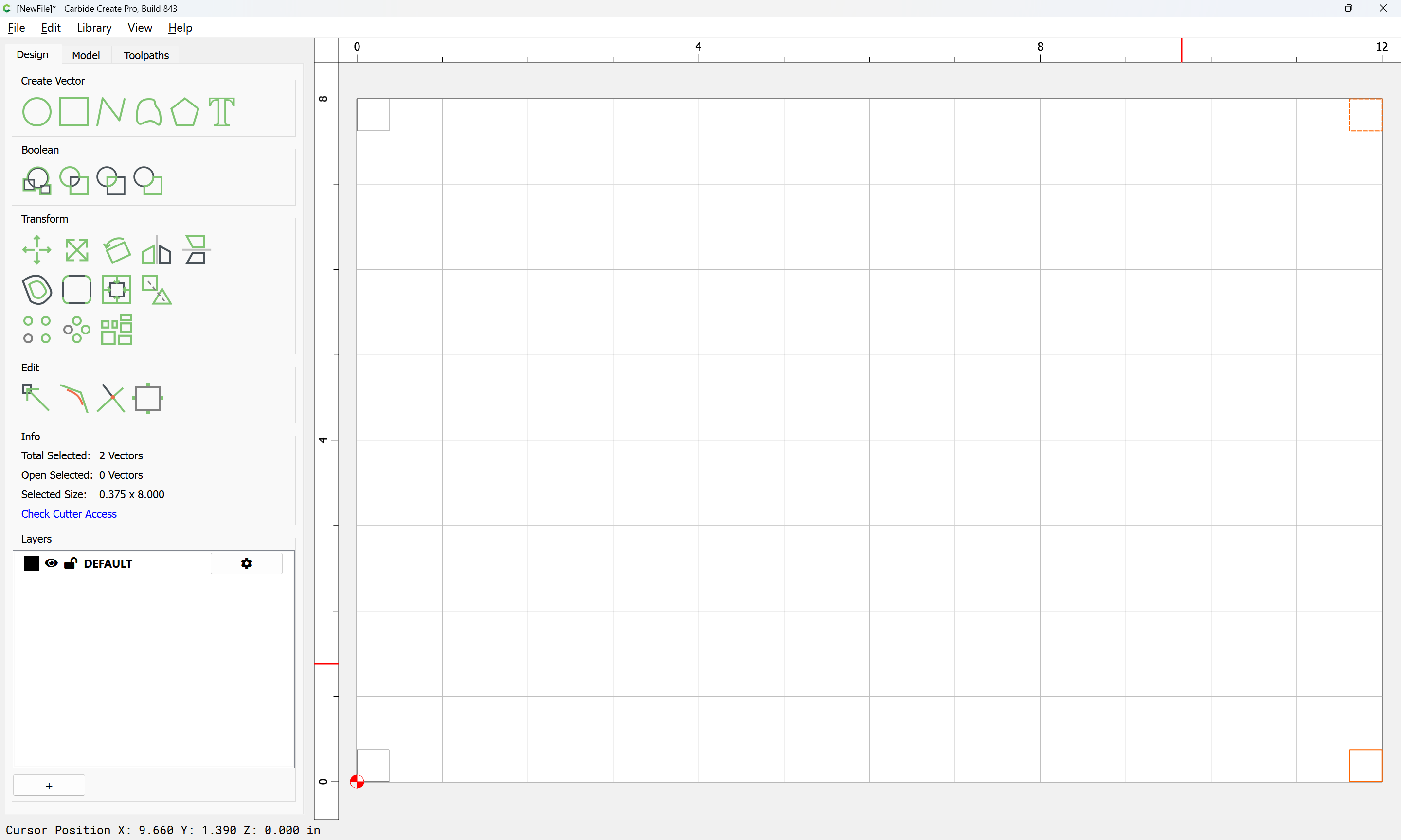

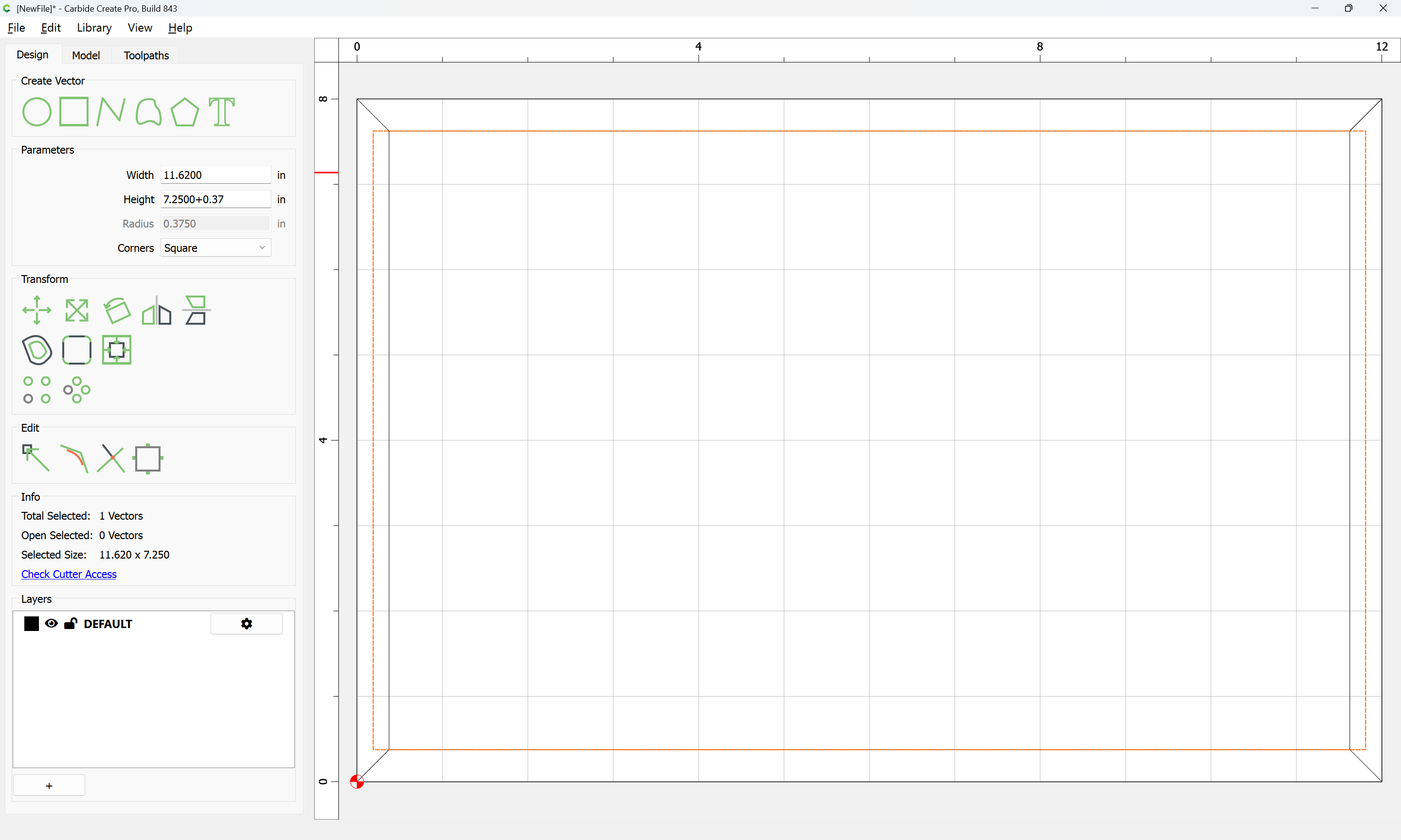

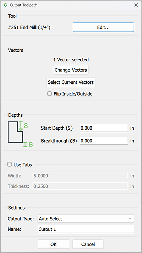

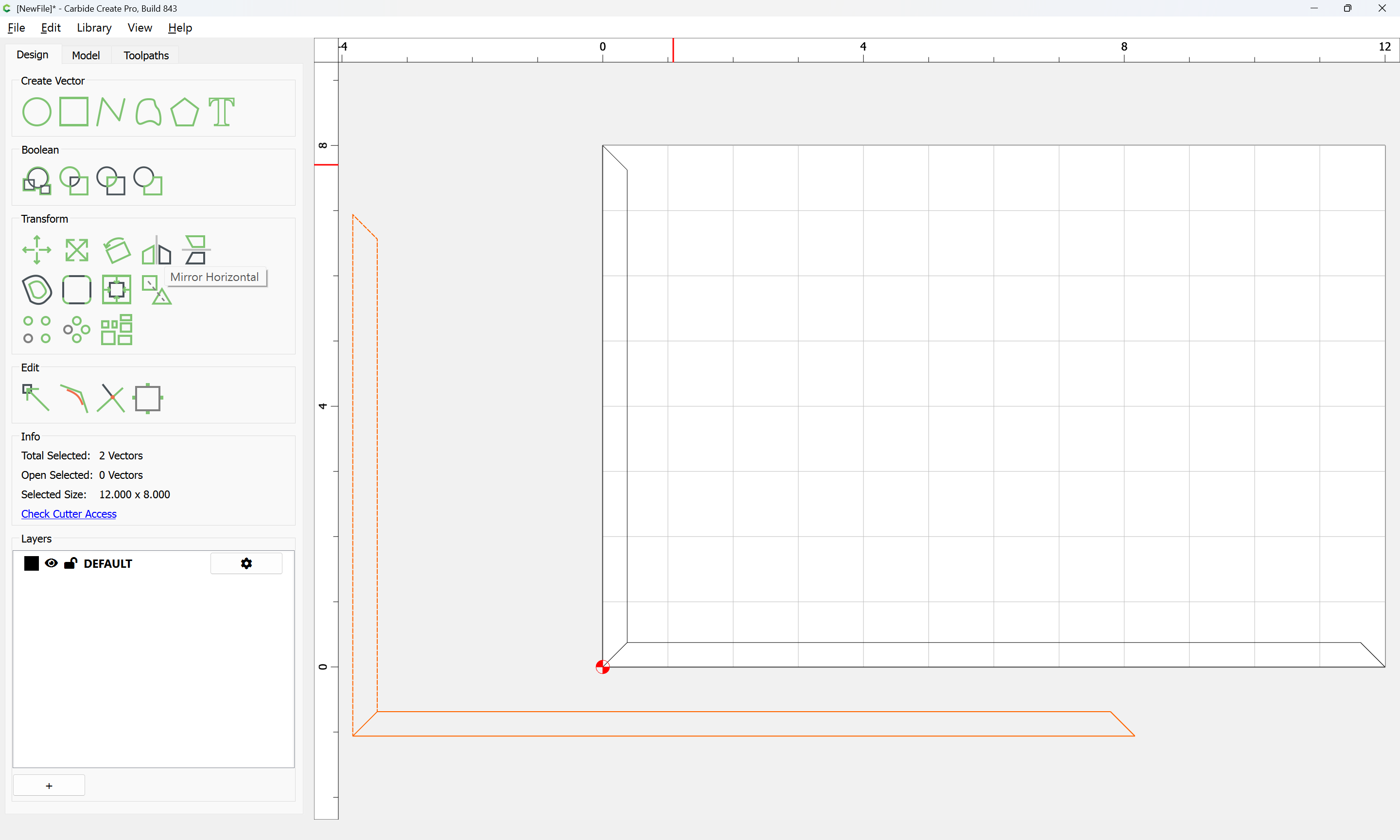

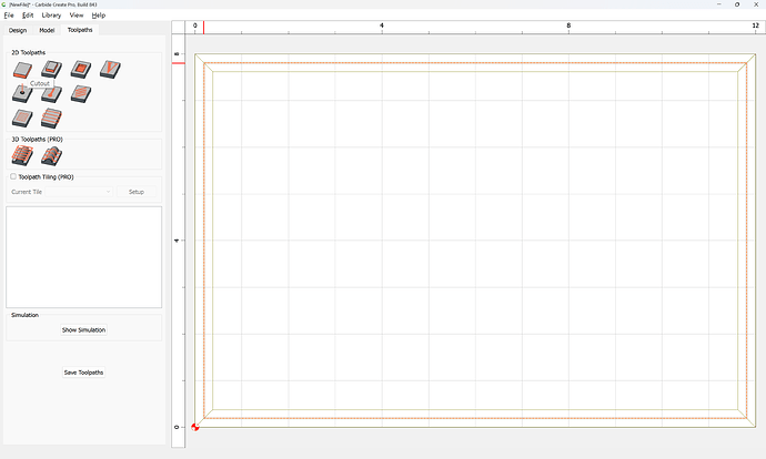

Draw an overhead view of the parts:
Cut this out:
using a workholding setup such as blue painter’s tape and cyanoacrylate glue which will allow forgoing tabs.
Attached as a v8 file.
box_12x8x6_sawn_LID_v8.c2d (44 KB)
