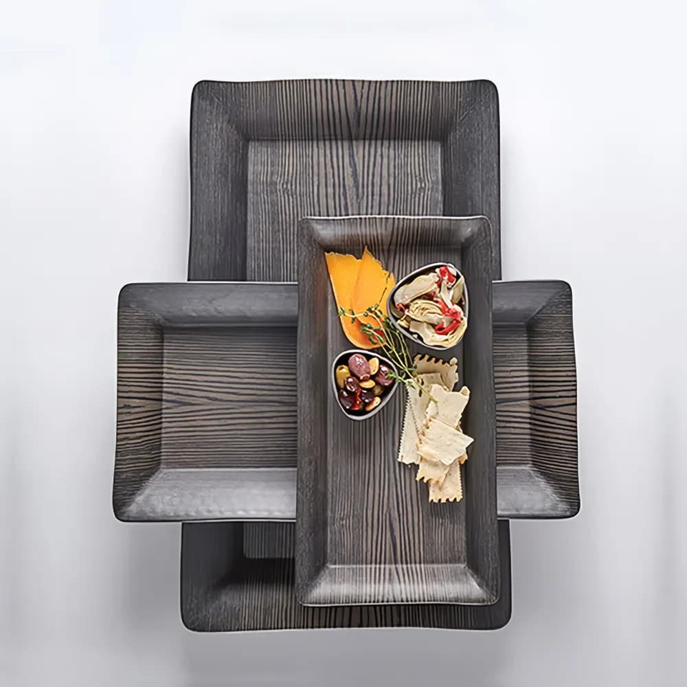

Designing a bowl:
which is:
https://www.katom.com/166-WMEL19.html
