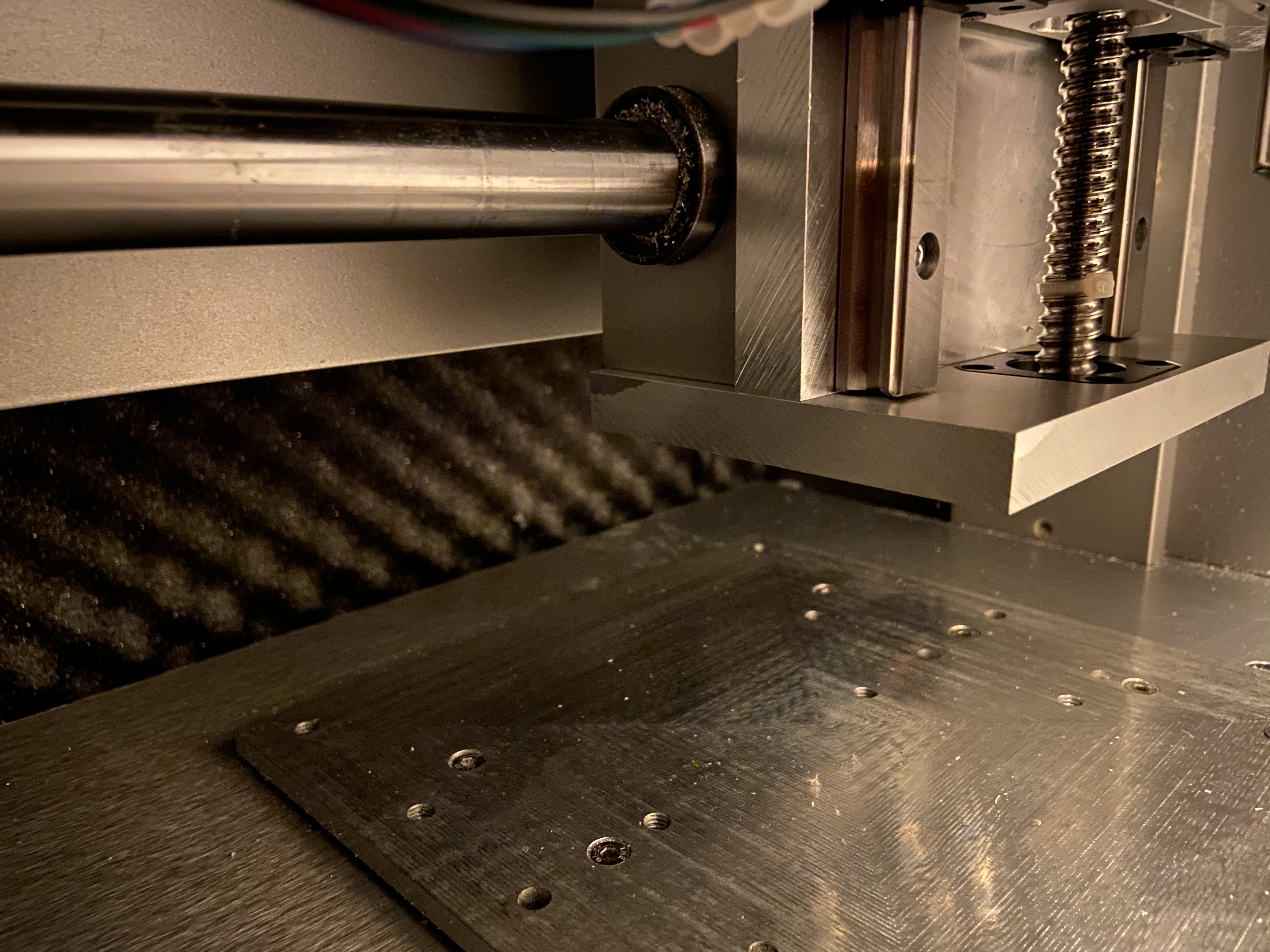

A quick recap of that massive thread for anyone who wasn’t following: After being disappointed in the Nomad 883 Pro’s inability to hog through Aluminium, I embarked on a quest to rebuild it better suited to my purposes. I’m starting with the Z-axis, which is based on TBI Motion ballscrews and linear rails. The new spindle is a Mechatron HFP-6508-30, which is a 65mm, 800W, 30k RPM spindle.
Here’s what the new Z-axis assembly looked like in CAD:
I got all the parts I ordered and after a long saga, managed to machine the Z-axis plate and assemble all the parts.
So, ladies and gentlemen, may I present my new Z-axis!
Short video.
I think the Z-axis itself is a fairly straightforward design, all of the parts are off-the-shelf save for the backing plate, carriage plate and mounting plates. Those were all machined on the stockish Nomad and were simple apart from drilling holes into the end of the backing plate and a little bit of two-sided machining.
The part I’m most happy with is that this is a bolt-on addition to the stock Nomad. I even crimped the stepper motor cable to the same Molex connector the stock Nomad uses. Installation is completely non-destructive and utilizes the Nomad’s existing mounting holes:
The Z-axis itself was also fairly cheap, the materials cost $308.88 for the linear motion parts, 49.96€ for the Aluminium stock and maybe 20 CHF for all the screws and inserts and whatnot, so I think <$400 in total (excl. shipping) and you could do it even cheaper if you used unbranded rails and ballscrew. The biggest expense was the spindle and accompanying parts (VFD, cooling etc.), at ~2000€.

CAD tells me the distance from the backing plate to the spindle cone along the machine’s Y-axis is 96mm. Eyeballing the stock Z-axis with a ruler, that distance looks to be ~55mm, so the difference is somewhere around 40mm.
The 96mm is made up of:
  • Backing plate: 15mm
  • Rail assembly: 24mm
  • Rail/spindle block: 17mm
  • Spindle holder: 7.5mm
  • Spindle: 32.5mm
Unfortunately matching is nigh on impossible. Even if I drilled holes into the X-axis carriage to mount the rails and somehow bolted the spindle directly to the rails, I’d still have 32.5mm + 24mm = 56.5mm offset.
If it ends up being an issue, I think I’ll address it by replacing the X axis. There is room for improvement on Z but I think I’d have a much larger impact by replacing X.

IT LIVES
All the cuts looked to be full-engagement and RPM was 30000. The last cut was ~0.4mm DOC, 1500mm/min feed rate.
I think.
It’s been a long journey to get here and I was excited just to see if it cut after what feels like a year of figuring out which parts to use, designing the Aluminium parts to glue them together, buying them, assmembling them, buying the electronics, assembling the electronics without electrocuting myself, debugging the electronics… I didn’t pay much attention to correctly zeroing and I may still need to adjust the steps/mm for the Z-axis.
And I’m really happy with how quiet everything is. I was mildly concerned that the spindle would be louder or that the VFD would whine or something but the loudest thing in the room by far is the set of BeQuiet! fans on the radiator for the water loop. The spindle is a pleasant buzz from inside the enclosure, much more pleasant than the old Nomad spindle.
I’ll likely play with it some more tomorrow.
Another project I need to do before I go too crazy with it though is finding a solution (like a bigger enclosure) for the lack of space for the spindle power cable and coolant pipes. As-is, if the spindle is somewhat high, they drag along the ceiling of the enclosure or look like they’ll snag on stuff, which I really don’t like.
Okay, did a few more test cuts to get a feel for the spindle.
Best cut I was able to do in terms of MRR was ~5mm axial, 2.4mm radial, 30k RPM, 600mm/min with a 3-flute, 6mm Hartner endmill. Not very exciting to look at but here’s a clip.
IIRC, that’s over 7x the maximum MRR I was able to get out of the old spindle, so, uhh, looks like the upgrade worked?
The problem now looks like workholding. You can see in the video that the stock had lifted out of the vise. I’ll try again later with clamps on the T-slot bed or threaded table.
I also tried to do a rough stiffness measurement and got a maximum of ~0.1mm of movement when I pulled on a 6mm rod in the spindle, so the Z-axis did give some improvement there.
And finally, damn this spindle results in some nice surface finishes. I need to surface something with it.

So it turns out I was babying the spindle too much. Using settings closer to the manufacturer recommendations, I was able to more than triple MRR again. I’m now at ~26x the maximum stock MRR.
Video
Cut parameters:
Nice conversion but that last cut doesn’t look good at all. I’d stick to Vince’s recommendations and go with low DOC and high WOC. The amount of chatter you have is crazy and will kill your endmills in no time.
Good point but the chatter, as far as I can tell, isn’t really related to the feeds and speeds. The same feeds and speeds that work just fine on the far right side of the stock start to chatter on the left side of the stock. This was the same with the stock spindle so I think there might be a mechanical issue with the machine (like some nut being more worn out on one side than the other).
My theories for the chatter are:
  • It happens in the middle of the X-axis, where the linear guides flex the most
  • It happens in between the Y-axis rails, where the most force is put on the anti-backlash nut
@Vince.Fab @spargeltarzan don’t suppose either of you have theories or opinions on my theories? Vince, could this be what you were talking about regarding the AB-nuts?
Have you done any maintenance on the AB-nuts recently? I filled my X-axis nut up with grease the other day and saw a massive improvement from ~0.5mm to unnoticeable by eye (very scientific™) movement when pushing on the axis by hand. This is before: https://photos.app.goo.gl/yxdqUNyxJHyqJVhu9
Another though: Could it be that you are overpowering the AB-nut springs, since you’ve now got the spindle power to put a lot more force on the axis?
Good idea but I think I’m just going to try to take it easy on X and Y for now.
Thinking about it some more and after discussing it with a friend, I think I need to replace the X and Y leadscrews with ballscrews.
Vince has already pointed to the AB-nuts as a problem when he did his spindle upgrade, so I think the chances are fairly high that I’m running into the same issues he did.
A friend also pointed out that the Nomad doesn’t look mechanically ready for this. The leadscrew is fairly wimpy and it looks unsupported, all the cutting force is applied axially to the stepper motors, which is usually pretty bad for them. Vince’s teardown shows what might be axial bearings but it’s hard to be sure.
Vince has shown that putting ballscrews on X and Y isn’t too big a hassle and now that I’ve done a ballscrew on Z, I’m feeling a bit better about doing it on X and Y.
