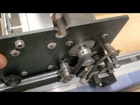

Is this play/back-lash normal? How is this managed, either by the CNC machine itself, or by Carbide Motion, or by MeshCAM?
Jon
