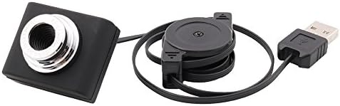

Which USB camera did you use? And which 3d printer are you using for all your parts?
The USB camera is the kind you find on Amazon if typing “USB endoscope” and looking at $20 models. I’m looking at buying a higher resolution one, there are full HD ones at around $50 but this one is 640x480 (I bought it several years ago), and while it’s enough for a live view to monitor what’s going on, it’s not enough to get clean recordings (as you can tell)
