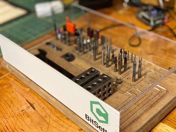

Here’s my submission for the community challenge: I created a tool holder for all my Shapeoko tools, designed in Carbide Create and made on the XL. I modified, produced and repeated until I could get the wrenches dialed in, and all the new bits I kept on getting as I got excited about my obsessive (OCD) organization platform…By the way, my 12 year old son quickly got a grasp of Carbide Create and made several changes himself - so proud!
Here’s a timelapse of one of the versions of the holder
Neat! I like the highly specific pocket in the middle :slight_smile:
don’t forget to upload your design file to validate your entry (and upload it on CutRocket for bonus points too)
I also have a surfacing bit that suffers from this problem, I have to loosen the set-screw on the bitsetter and slide it over to catch the edge of the bit. So I am very interested in your solution.
I’m assuming the thichness of the part has to be perfect, to thick and the tool appears shorter, too thin and the tool appears longer… or is there some voodoo happening here that I don’t understand (regarding the tool measurement)?
The specific thickness isn’t crucial, because it’s a relative adjustment from the initial probe on startup. You just have to make sure the top is flat/planar.
