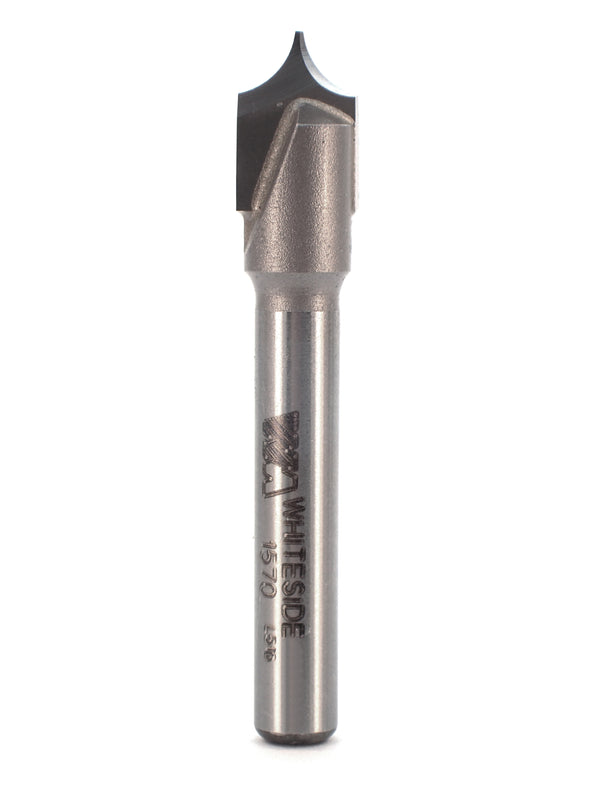

and drawing up the profile of the radius of the lid opening so as to calculate how deep a V carving needs to be to ease that (or one could source a corner radius tool of the correct size, or model it in 3D):
drawing in the geometry for the V carving:
and working out how the radius relief to allow the box opening will be done — one can either source a tool
(the exact size doesn’t seem to be available, but there is a close Imperial size)
which fortuitously is available at my local Woodcraft:
Ever wish you had one bit that you could use for numerous projects? Well, here it is! This pointed round over bit is unbelievably versatile and can be used for many projects, including fluting, beading, molding and even sign carving.
If that isn’t an option, draw things up in profile and work up a series of cuts w/ a ball-nosed endmill as suggested at:

Wrote a bit about previewing the roundover cut using V endmills at:
These are usually used in routers for decorative effects in wood:
but they are potentially useful for joinery:
They are also useful for rounding off parts to allow rotary motion as for a hinged lid.
Unfortunately, Carbide Create does not support this endmill geometry — but using the new support for previewing a V endmill when used in a No Offset Contour toolpath, it should be possible to preview them w/ confidence by stacking a series of V endmill cuts.
