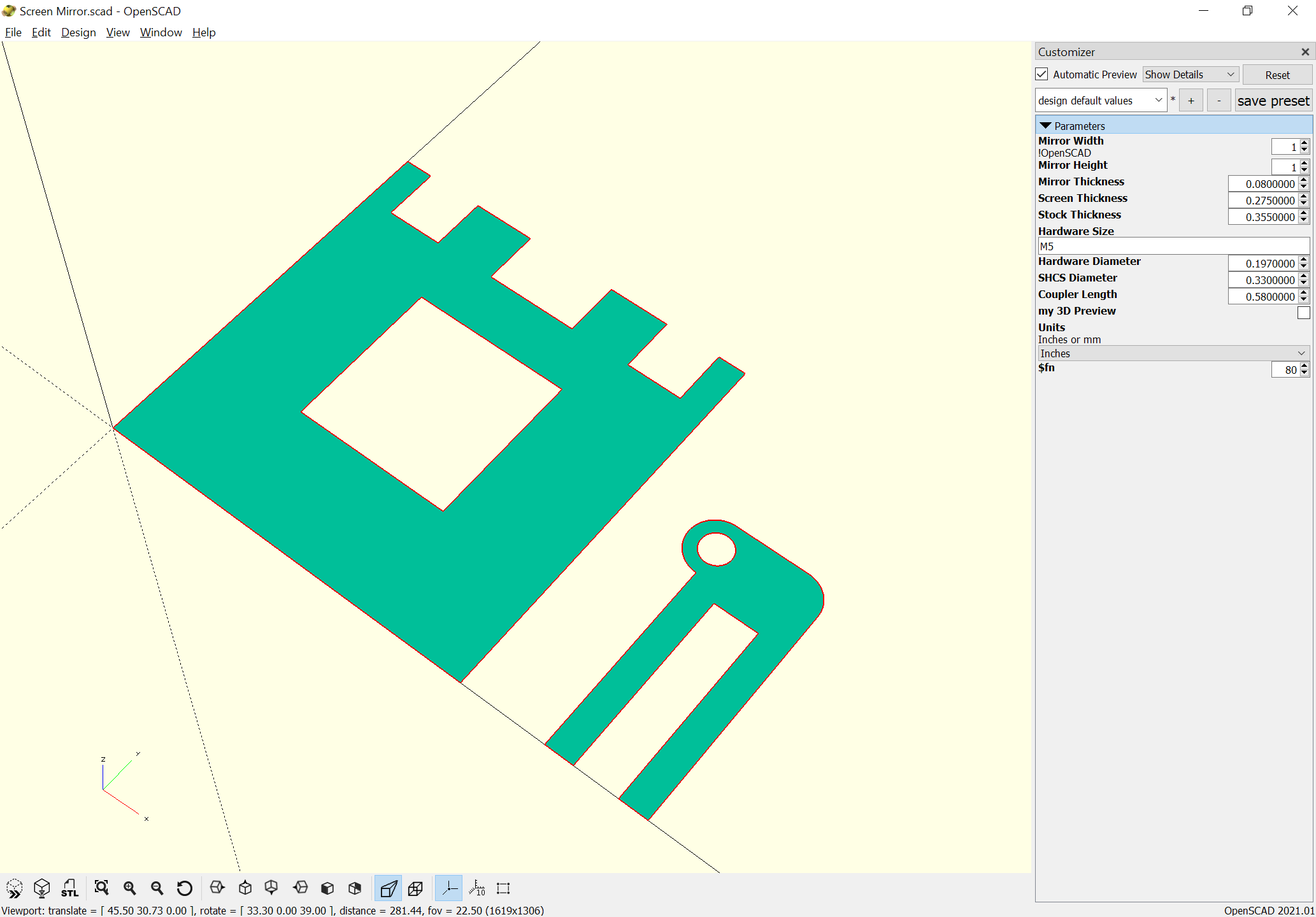

Exporting to OpenSCAD and adjusting the code a bit we arrive at:
Projecting to make a file which can serve as a beginning for cutting:
Attached.
Screen Mirror.zip (921 Bytes)

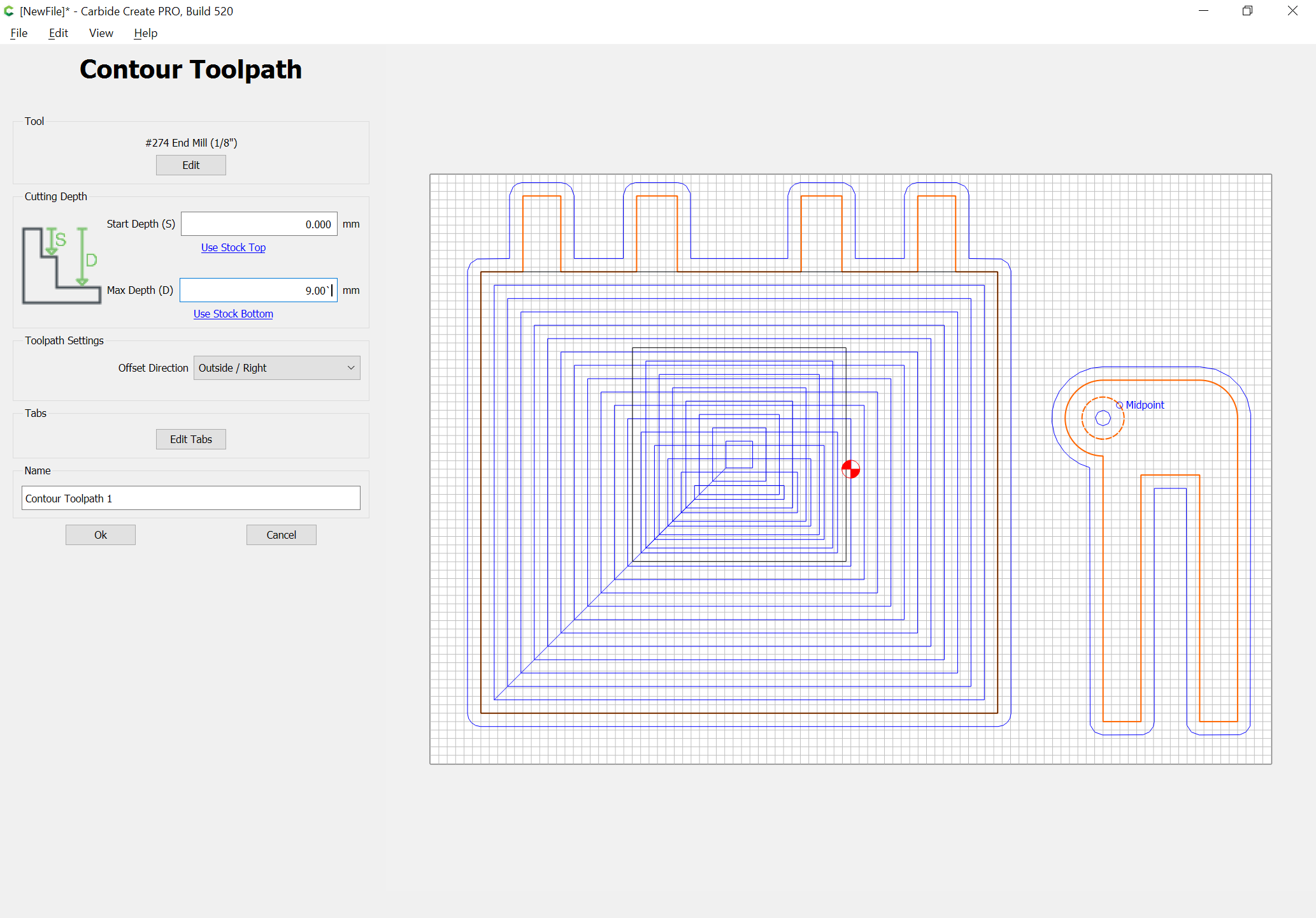

Next up is importing into Carbide Create and working out how to cut this out.

The spine of the mirror holder will need to be rounded at least enough to allow a reasonable positioning of the mirror.
There are several ways to accomplish such rounding:

  • draw a succession of geometry and suitable toolpaths to cut this — this is the technique which will be used here
Visualizing this will be easier if we rotate things to line up and draw in the geometry in register:
The depth per pass is 0.508 mm for a #111 ball-nosed endmill — rounding down we want a stack of 0.5mm squares to indicate the depth we will be cutting to:
Drawing in a 1.5875mm diameter circle we align it with the bottom of the top rectangle:
and then nudge it over until it just touches the circle which represents the desired rounding:
Draw a line which is radius longer than is needed at each end:
align it with the center of the circle:
and assign it a Contour No offset toolpath to a depth of 0.5mm:
Repeat for each depth square.
Eventually one arrives at:
If one is more patient, and willing to take shallower passes, the appearance and fidelity could of course be improved.
